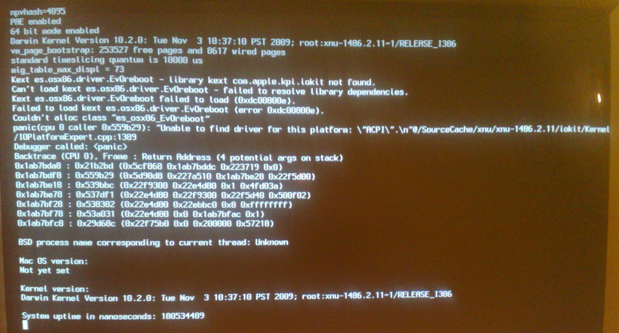

Cybergigi Posted December 23, 2009 Share Posted December 23, 2009 Salve, con l'hardware in firma non riesco più ad installare in nessun modo SnowLeopard retail che ho originale. Mi va sempre in Kernel Panic all'avvio del boot . Ho provato di tutto, anche con il cdboot dedicato asus che ho scaricato qui e con vari booloader ecc... in allegato metto la schermata che mi da. Qualche buona anima mi sa aiutare ?? Please help me !!!!1 :-( English version ( by google :-) ) Hello, with l' hardware in company I more do not succeed to install in no SnowLeopard way retail that I have originates them. It always goes to me in Kernel Panic all' start of the boot. I have tried of all, also with the cdboot dedicated asus that I have unloaded here and with several booloader etc… in attached I put the shielded one that they give to me. Some good spirit knows to me to help? Link to comment https://www.insanelymac.com/forum/topic/176155-new-intel-p55-mobos-core-i7-860-i5-750-cpu-lga1156/page/53/#findComment-1367574 Share on other sites More sharing options...

Treky Posted December 23, 2009 Share Posted December 23, 2009 Hello,with l' hardware in company I more do not succeed to install in no SnowLeopard way retail that I have originates them. It always goes to me in Kernel Panic all' start of the boot. I have tried of all, also with the cdboot dedicated asus that I have unloaded here and with several booloader etc… in attached I put the shielded one that they give to me. Some good spirit knows to me to help? Really sure that this EVOreboot.kext is not the problem ? Have you ever tried to boot without EVOreboot.kext in /Extra folder ? At least, this errors confuse me a bit. If you get a kernel panic at another step (without EVOreboot) , is it not the same error. Link to comment https://www.insanelymac.com/forum/topic/176155-new-intel-p55-mobos-core-i7-860-i5-750-cpu-lga1156/page/53/#findComment-1367662 Share on other sites More sharing options...
Sirius19 Posted December 24, 2009 Share Posted December 24, 2009 Hi cybergigi, there's a link here that discuss of everything related to the p7p55d http://www.insanelymac.com/forum/index.php...p;#entry1367703 Hope it will help Salve, con l'hardware in firma non riesco più ad installare in nessun modo SnowLeopard retail che ho originale. Mi va sempre in Kernel Panic all'avvio del boot . Ho provato di tutto, anche con il cdboot dedicato asus che ho scaricato qui e con vari booloader ecc... in allegato metto la schermata che mi da. Qualche buona anima mi sa aiutare ?? Please help me !!!!1 :-( English version ( by google :-) ) Hello, with l' hardware in company I more do not succeed to install in no SnowLeopard way retail that I have originates them. It always goes to me in Kernel Panic all' start of the boot. I have tried of all, also with the cdboot dedicated asus that I have unloaded here and with several booloader etc… in attached I put the shielded one that they give to me. Some good spirit knows to me to help? Link to comment https://www.insanelymac.com/forum/topic/176155-new-intel-p55-mobos-core-i7-860-i5-750-cpu-lga1156/page/53/#findComment-1367739 Share on other sites More sharing options...

nillls Posted December 24, 2009 Share Posted December 24, 2009 Hi guys, sorry to bother you on christmas but I'm really at the end of the rope here... I've got a Gigabyte GA-P55-UD3, i5 750 and gtx 260 in my setup but the tonymac86's guide simply isn't working, it stops after I've put the snow leopard cd in after booting into chameleon. I see lot's of text passing by on my screen and then the screen just goes blank. No reboot, nothing - it just sits there. I've tried the standard bootcd, the beta bootcd etc. and my settings in BIOS is for AHCI and HPET 64-bit. The only thing I can think of that could mess this up is that I'm using the cheap "upgrade dvd" that came for leopard users when snow was released - bu then again I've installed on other systems from scratch with that one so it can't be the problem. Any help as to how to get this working would really make my day - I bought this system to run OS X. Link to comment https://www.insanelymac.com/forum/topic/176155-new-intel-p55-mobos-core-i7-860-i5-750-cpu-lga1156/page/53/#findComment-1367866 Share on other sites More sharing options...
Treky Posted December 24, 2009 Share Posted December 24, 2009 Hi guys, sorry to bother you on christmas but I'm really at the end of the rope here... I've got a Gigabyte GA-P55-UD3, i5 750 and gtx 260 in my setup but the tonymac86's guide simply isn't working, it stops after I've put the snow leopard cd in after booting into chameleon. I see lot's of text passing by on my screen and then the screen just goes blank. No reboot, nothing - it just sits there. I've tried the standard bootcd, the beta bootcd etc. and my settings in BIOS is for AHCI and HPET 64-bit. The only thing I can think of that could mess this up is that I'm using the cheap "upgrade dvd" that came for leopard users when snow was released - bu then again I've installed on other systems from scratch with that one so it can't be the problem. Any help as to how to get this working would really make my day - I bought this system to run OS X. The upgrade CD would not show that behavior. In case you try to boot directly from retail DVD with 10.6.0 it must fail. Reason is, the kernel of 10.6.0 doesn't support the P55 platform. So you must rip your install DVD to a harddisk or USB disk, replace the mach_kernel with the version of 10.6.2 to be able to boot. I see lot's of text passing by on my screen and then the screen just goes blank kexts that chameleon load ? No reboot is a bit strange. I bought this system to run OS X In my case also. But there was no 10.6.2, no announced iMacs with core i7 / core i5 cpus. And I bought it because I believed all Intel cpus are supported that are newer than Core Duo. Was not so nice, but the Aitkos installation with vodoo kernel booted if they wanted to to boot but often times not. Link to comment https://www.insanelymac.com/forum/topic/176155-new-intel-p55-mobos-core-i7-860-i5-750-cpu-lga1156/page/53/#findComment-1367891 Share on other sites More sharing options...
nillls Posted December 24, 2009 Share Posted December 24, 2009 The upgrade CD would not show that behavior. In case you try to boot directly from retail DVD with 10.6.0 it must fail. Reason is, the kernel of 10.6.0 doesn't support the P55 platform. So you must rip your install DVD to a harddisk or USB disk, replace the mach_kernel with the version of 10.6.2 to be able to boot. But I should not need to burn another dvd if I have the tonymacx86's cd and the snow leopard dvd, right? The guide does not mention this... kexts that chameleon load ?No reboot is a bit strange. In my case also. But there was no 10.6.2, no announced iMacs with core i7 / core i5 cpus. And I bought it because I believed all Intel cpus are supported that are newer than Core Duo. Was not so nice, but the Aitkos installation with vodoo kernel booted if they wanted to to boot but often times not. I dunno, I guess chameleon loads the kexts from the retail dvd. But from what I've seen here my hardware should be compatible? Link to comment https://www.insanelymac.com/forum/topic/176155-new-intel-p55-mobos-core-i7-860-i5-750-cpu-lga1156/page/53/#findComment-1367920 Share on other sites More sharing options...

Treky Posted December 24, 2009 Share Posted December 24, 2009 But I should not need to burn another dvd if I have the tonymacx86's cd and the snow leopard dvd, right? The guide does not mention this... I dunno, I guess chameleon loads the kexts from the retail dvd. But from what I've seen here my hardware should be compatible? I don't think that it can work to load the right mach_kernel from Tonymacs boot cd, and the rest from retail DVD. But I can't really sure except that there is maybe a trick to do it. I think you will need a 10.6.2 install DVD or you must patch your installation disk. Ask tonymac self this question. I don't know his boot cds. But I would say it cannot work without kernel-patched installation DVD. Link to comment https://www.insanelymac.com/forum/topic/176155-new-intel-p55-mobos-core-i7-860-i5-750-cpu-lga1156/page/53/#findComment-1368298 Share on other sites More sharing options...
nillls Posted December 24, 2009 Share Posted December 24, 2009 I don't think that it can work to load the right mach_kernel from Tonymacs boot cd, and the rest from retail DVD. But I can't really sure except that there is maybe a trick to do it. I think you will need a 10.6.2 install DVD or you must patch your installation disk. Ask tonymac self this question. I don't know his boot cds. But I would say it cannot work without kernel-patched installation DVD. That is really awesome, thank you for this info - it'll help me get a little closer. It does sound strange though, how would one re-install os x with the dvd that comes with the imacs if one has the i5/i7 imac? Is there a guide around to create an install dvd like that? I really wouldn't know what to replace... Link to comment https://www.insanelymac.com/forum/topic/176155-new-intel-p55-mobos-core-i7-860-i5-750-cpu-lga1156/page/53/#findComment-1368324 Share on other sites More sharing options...
Treky Posted December 24, 2009 Share Posted December 24, 2009 It does sound strange though, how would one re-install os x with the dvd that comes with the imacs if one has the i5/i7 imac? The iMac DVDs are already 10.6.2. If you have a DVD from core i7 / i5 iMac it must start directly from disc. Is there a guide around to create an install dvd like that? I really wouldn't know what to replace... It is much harder without an existing Mac. Have you a Mac or maybe a hackintosh ? If you have a mac, I can tell you how, but if not I don't know. A guide is maybe somewhere, how to rip the install DVD to another disk, but I can not tell you where. Link to comment https://www.insanelymac.com/forum/topic/176155-new-intel-p55-mobos-core-i7-860-i5-750-cpu-lga1156/page/53/#findComment-1368360 Share on other sites More sharing options...
