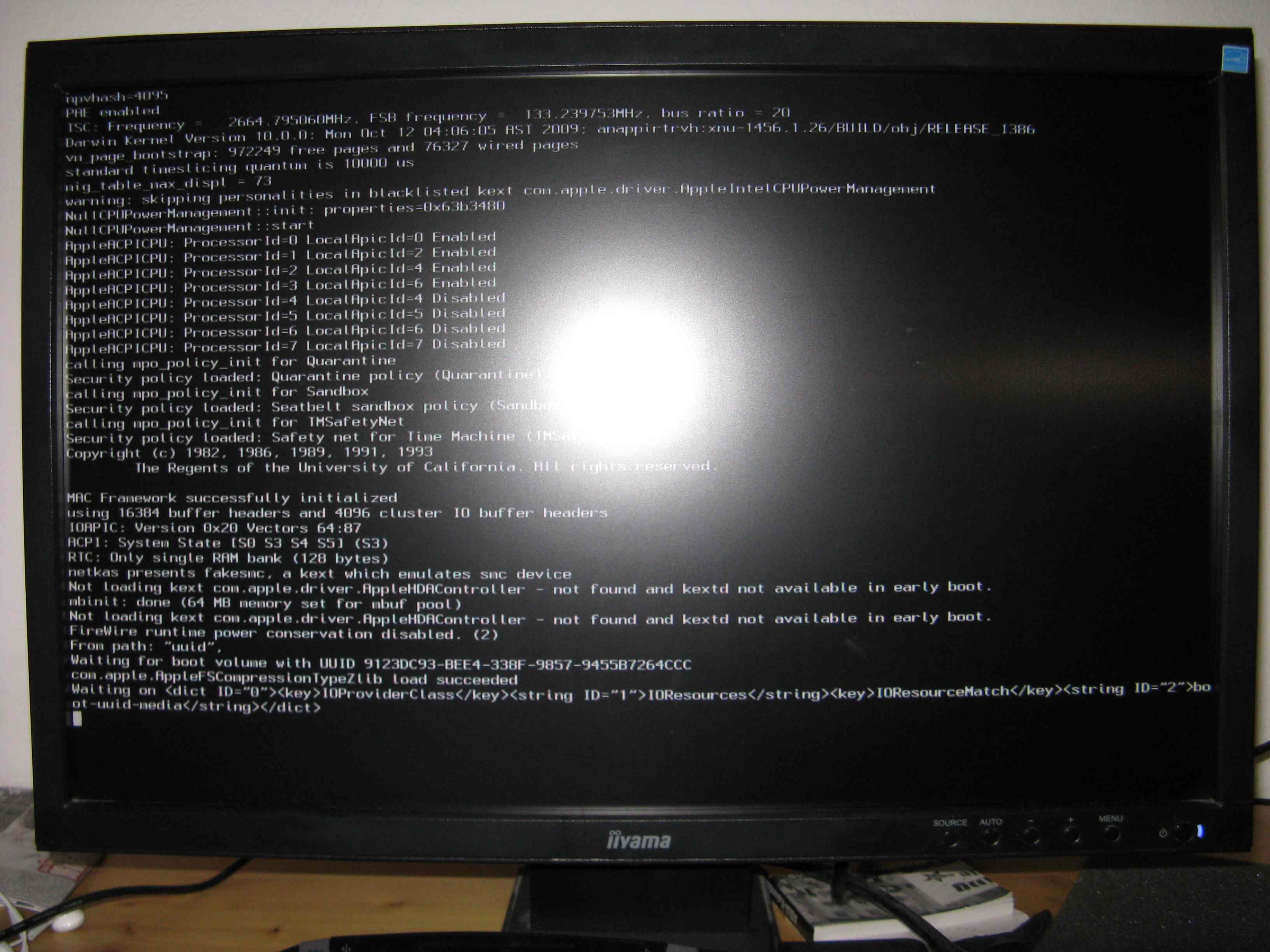

lectrcman Posted November 19, 2009 Share Posted November 19, 2009 OK I've made a little more progress. I can't get to the boot screen with the setting on the TonyMacX blog. See attachment. However, if I change from AHCI to IDE it will boot to the install screen. I tried to run Disk Utility but it saw no HDs. Any ideas? Link to comment https://www.insanelymac.com/forum/topic/176155-new-intel-p55-mobos-core-i7-860-i5-750-cpu-lga1156/page/20/#findComment-1335399 Share on other sites More sharing options...
goldenaustin Posted November 19, 2009 Share Posted November 19, 2009 OK I've made a little more progress. I can't get to the boot screen with the setting on the TonyMacX blog. See attachment. However, if I change from AHCI to IDE it will boot to the install screen. I tried to run Disk Utility but it saw no HDs. Any ideas? Yes, you need to use the AHCI setting as you already figured out, but ensure that you're plugging in your cable to port 0 on you motherboard. I had the same issue with my SATA drive, which was in port 1 while my dvd drive was in 0. I swapped the two, and then my SATA HD showed up. Link to comment https://www.insanelymac.com/forum/topic/176155-new-intel-p55-mobos-core-i7-860-i5-750-cpu-lga1156/page/20/#findComment-1335415 Share on other sites More sharing options...

lectrcman Posted November 19, 2009 Share Posted November 19, 2009 Yes, you need to use the AHCI setting as you already figured out, but ensure that you're plugging in your cable to port 0 on you motherboard. I had the same issue with my SATA drive, which was in port 1 while my dvd drive was in 0. I swapped the two, and then my SATA HD showed up. I did have it there. However, I moved it from SATA2_0 to GSATA2_0 which is moving it from the SATA controlled by the P55 chipset to the SATA controlled by the Gigabyte controller. When I did that the loader booted all the way up and saw the drive. Disk Utility saw it and it will allow me to format it. Right now I have Windows 7 installed and I am currently copying the files I want to keep from it to an E-SATA drive. I'm hoping to try the install tonight. Link to comment https://www.insanelymac.com/forum/topic/176155-new-intel-p55-mobos-core-i7-860-i5-750-cpu-lga1156/page/20/#findComment-1335426 Share on other sites More sharing options...
