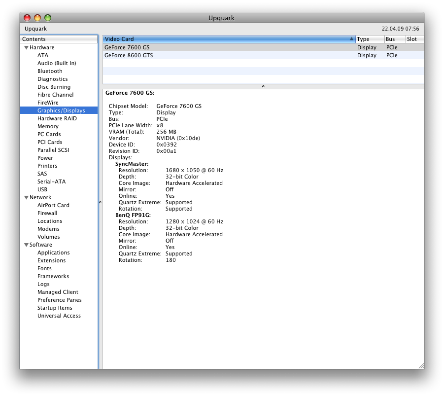

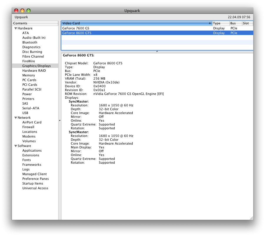

CaptainNemo Posted April 22, 2009 Author Share Posted April 22, 2009 Hi CaptainNemo,Thanks for the prompt feed back. I am a novice in this field so I don't know where to start. If you have some spare times, pls do continue with the newer version on GA-P35-DS3. Thanks for your time and have a good day. Hey helob, what exactly do you want me to do? Don't get it honestly Is it just regarding the Chameleon Bootloader? The rest on how to do it is written clearly on the very first post of mine. captain, you just said that the p35-ds3 accepted the 45nm quad even with the F12, but with the wrong ID??? It works fine??? because I got a p35-ds3 and a q8200 , and it was f12, refuses to power on... Hey braid, indeed. My GA-P35-DS3 Rev. 1.0 works with the Q9650 on F12, but I also mentioned, that I had installed the buggy "BETA" of the 14C installed before. Does it makes sense? Not really if you ask me - but it works. I think that the BIOS Update clears the previous one completly and the information by Gigabyte says that you can JUST install this CPU with F14C. So, also for me, it's kinda confusing. What I recommend to you: Don't get a CPU for your board that is NOT supported in F12. If you've already done it, maybe the F14C works for you better than for me. Please also notice that I can JUST speak about the "GA-P35-DS3 Rev 1.0", no -R,-P,-4,-S or higher Revisions like 2.0! A warning about this: You could damage your CPU doing this! So be careful! If the system simply won't boot with this CPU, it's a clear message that you better stop using it with the currently installed BIOS! Also, I mentioned some sluggy reactions from the OSX when using the CPU in the GA-P35-DS3, but this seems to be more a problem of my GeForce 8600GTS. Using EFI (comfortable made with OSx86 Tools) let me use the system without any more issues. I also have some news from the ASUS board. I managed to install it meanwhile smoothly. The sluggy part also seems to come from the NVkush. I've just added 2x PCIe x16 cards (the 2nd one is driven as x8 Lanes) which are GeForce 8600GTS + GeForce 7600GS (both passive) to the board and used to install the EFI strings into the boot.com.Apple.plist with OSx86 Tools. The result: A very nice and fast system and I was able to attach 4 TFT screens (3x 22" + 1x 19" above the middle 22" display). I think the time is right to write the ASUS P5Q Deluxe tutorial. Pictures: Both cards running side-by-side The next step is to do this with my 1 card width passive GeForce 8400GS instead of the 7600GS (which takes 3 slots width) to be able to do the next step and put my PCIe x8 ARECA RAID Controller into the 2nd (of 3 PCIe x16) slots and use the full juicy power of my 6TB RAID5 (If I can make it work to boot from)... Anyway - to newcomers and interested persons, I still recommend to get a Gigabyte board, they are just better supported. I would not call my buy of the ASUS board an "epic fail", but it makes the things a bit more complicated. Ciao Nemo Link to comment Share on other sites More sharing options...
