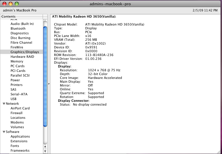

ridgeline Posted February 5, 2009 Share Posted February 5, 2009 Using a little help SkyXD was just able to get his card working on the same laptop I am waiting on screenshot Screenshot: Link to comment https://www.insanelymac.com/forum/topic/149872-ati-moblity-radeon-hd-3650-on-ideneb-13/page/7/#findComment-1070269 Share on other sites More sharing options...
Fujilives Posted February 5, 2009 Share Posted February 5, 2009 Using a little help SkyXD was just able to get his card working on the same laptop I am waiting on screenshot Screenshot: What laptop does he have? Internal display or DVI/VGA connected display? Link to comment https://www.insanelymac.com/forum/topic/149872-ati-moblity-radeon-hd-3650-on-ideneb-13/page/7/#findComment-1070306 Share on other sites More sharing options...
Boombeng Posted February 5, 2009 Share Posted February 5, 2009 Nice, so we now have to find what in this Toshiba laptop makes Megalodon send signal to the internal display instead of external as on all the HD2XXX mobility... I also want to point out that for the moment this HD3650 mobility success (Toshiba) and half success (IcemanPT) doesn't bring anything for HD34XX mobility cards Link to comment https://www.insanelymac.com/forum/topic/149872-ati-moblity-radeon-hd-3650-on-ideneb-13/page/7/#findComment-1070307 Share on other sites More sharing options...
ridgeline Posted February 5, 2009 Share Posted February 5, 2009 He is on the A300-10g Toshiba and no external display was connected well it is a good place to collect the info on why it works and what won't at least now we have more than one instance even if it is on the same laptop A question was raised on if these laptops used mxm cards instead of intergrated Link to comment https://www.insanelymac.com/forum/topic/149872-ati-moblity-radeon-hd-3650-on-ideneb-13/page/7/#findComment-1070315 Share on other sites More sharing options...
