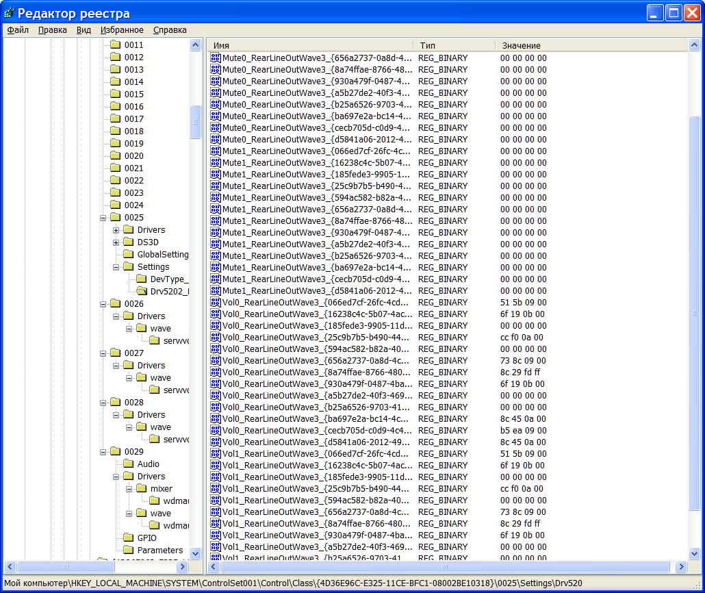

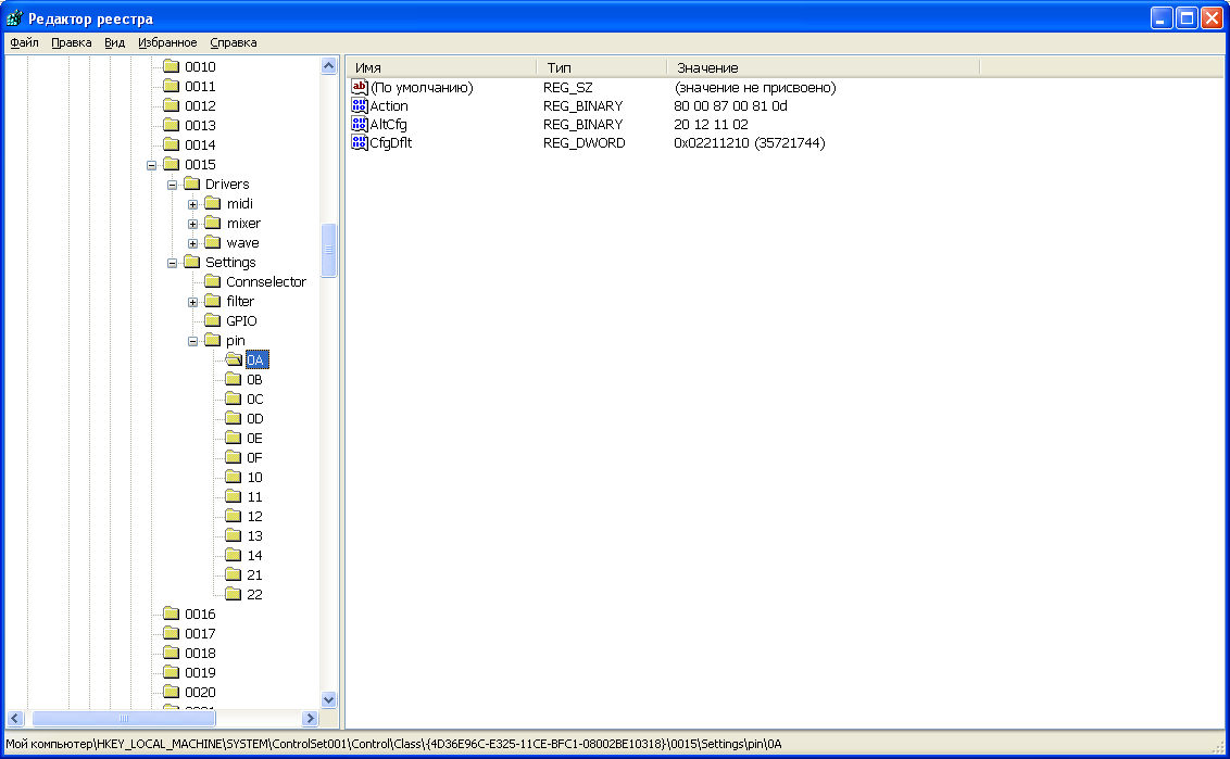

Slice Posted December 26, 2008 Share Posted December 26, 2008 In WinXP I found only this. Is it the same? How to use it? Link to comment https://www.insanelymac.com/forum/topic/137188-how-to-pin-config/page/2/#findComment-1014636 Share on other sites More sharing options...

Slice Posted December 31, 2008 Share Posted December 31, 2008 Slice that's incomplete, so now I have created a new version for vista. Check my thread.Guys I've created a new version in where it looks for more than one pinconfig so guys try and see if it works for you. Thank you, but I need a tool for WinXP that has another registry. My found is good but not for novice yet. I am on the road of testing. Other problem - in Comp#1 I have no such entries. Link to comment https://www.insanelymac.com/forum/topic/137188-how-to-pin-config/page/2/#findComment-1020836 Share on other sites More sharing options...

Slice Posted January 3, 2009 Share Posted January 3, 2009 Slice what Farx was trying to say is that you should find that information in your registry, if you can find it let us know where is it. By the way this is my latest pinconfig in where you now can have all your audio devices without needing to go to control panel. In my registry there is no such information. Because I have only XP but not Vista. Link to comment https://www.insanelymac.com/forum/topic/137188-how-to-pin-config/page/2/#findComment-1025524 Share on other sites More sharing options...

Slice Posted January 13, 2009 Share Posted January 13, 2009 One note. I complete best driver for my Sigmatel9228 and now I know best PinConfig. It differs from WindowsXP information! In XP I see Node 12 = 400003fb - that means absent device Node 14 = 0281103e - that means LineIn External Front Jack 1/8 Node 19 = 90a60330 - Mic Internal Other Digital connector Really I got true sound (thanks to gbonilla) using Node 12 - LineIn Node 14 - Mic internal May be Vista driver is better but I can't check. Link to comment https://www.insanelymac.com/forum/topic/137188-how-to-pin-config/page/2/#findComment-1039104 Share on other sites More sharing options...
