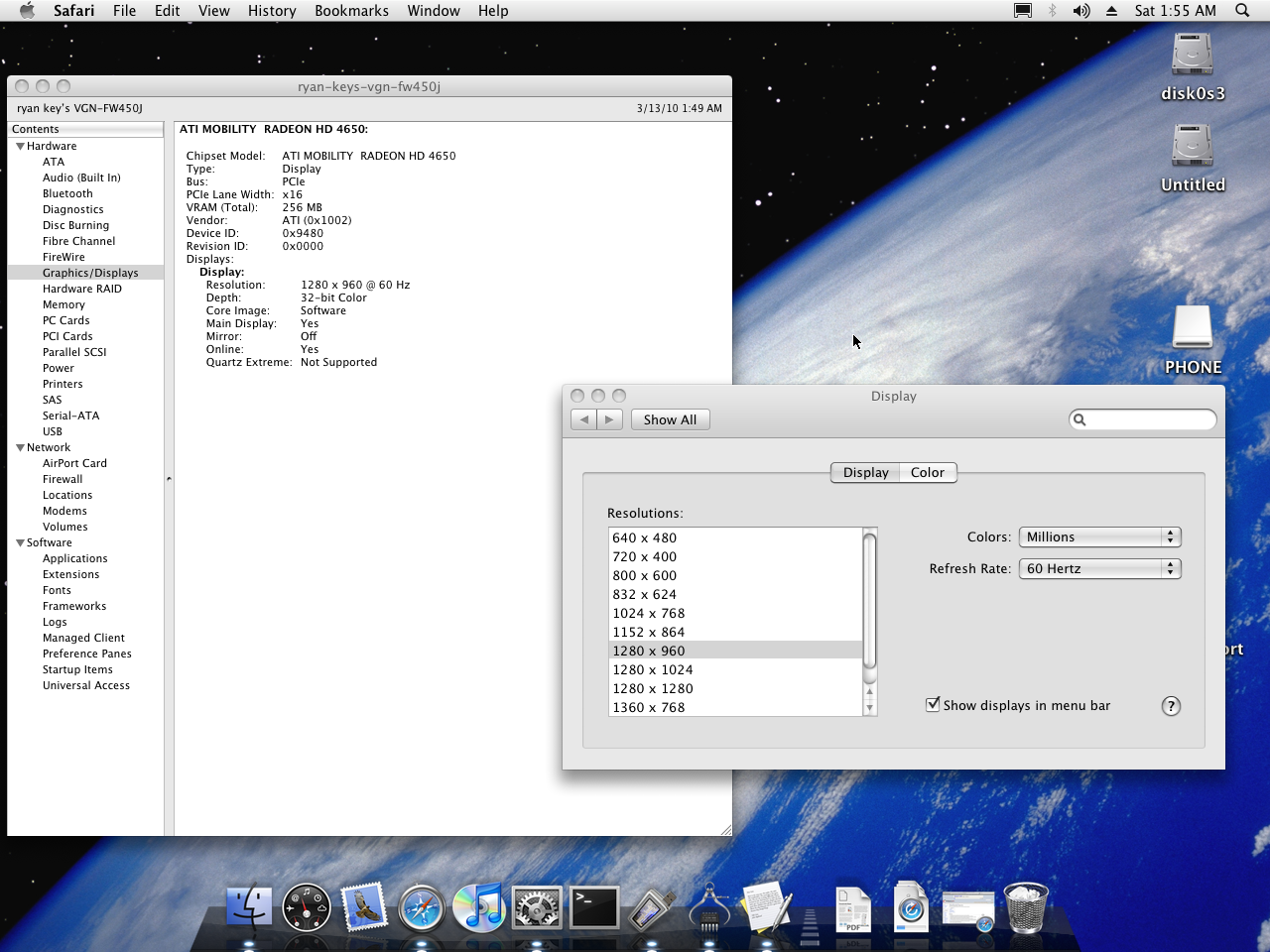

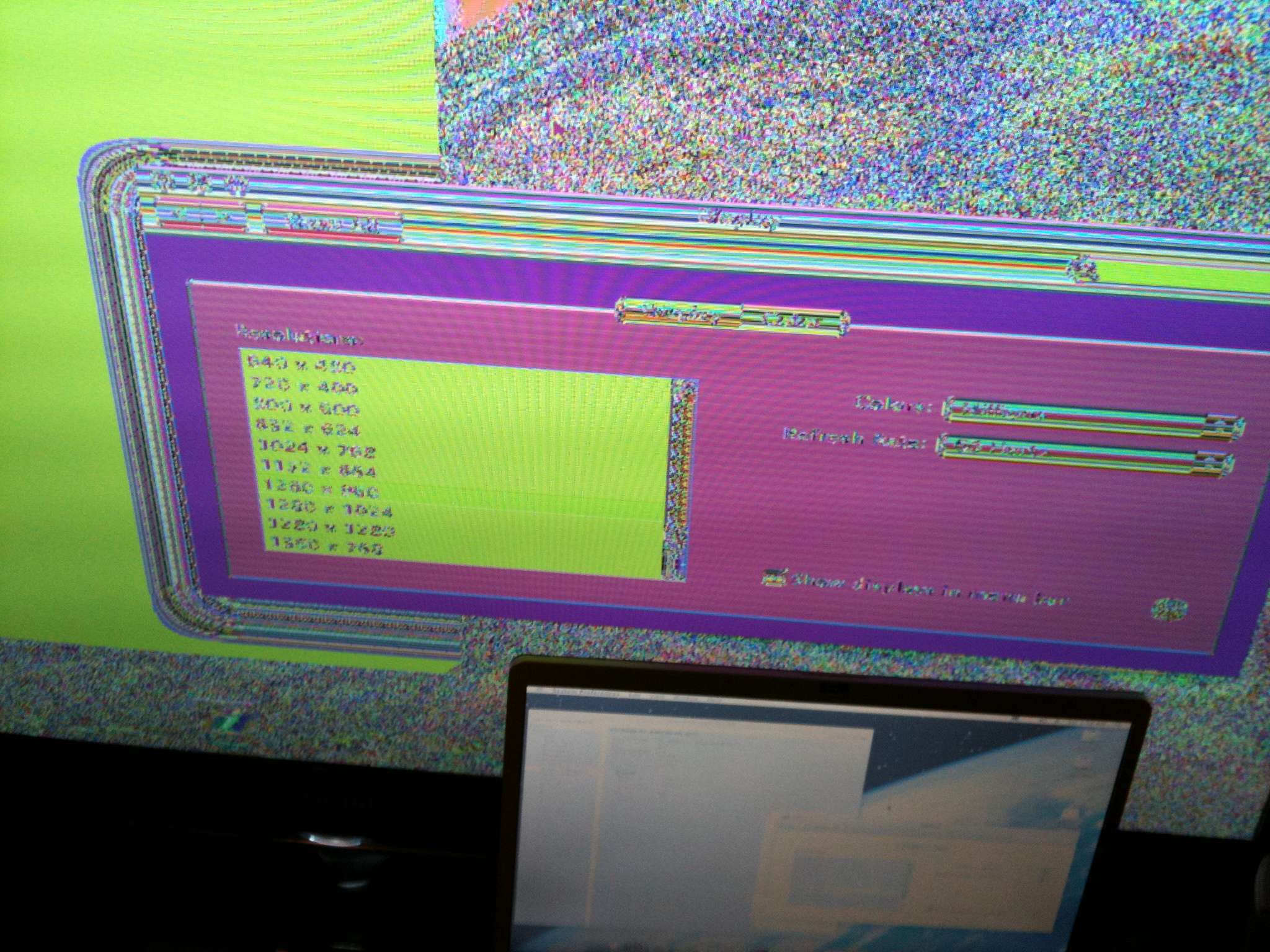

supershags2005 Posted March 12, 2010 Share Posted March 12, 2010 Ok, so right now I'm on OS 10.5.1, and I have an ATI Mobility Radeon HD 4650, my problem is with dual displays, I have an HDMI port that I have connected to my Samsung TV. This is what it looks like. It seems to be displaying on the TV in 256 colors, or something low like 8 bit, but the display on the laptop is fine, if anyone knows any way possible to get the TV display to change to 32 bit, I'd really appreciate the help, this is my first time with MAC. In the System Display settings I don't have the option for arranging displays, but I can change the color to thousands on both displays and they both look purple at the same time, I can change resolution on both displays, I just can't get the TV to do millions. This is what the laptop looks like though. Link to comment https://www.insanelymac.com/forum/topic/136296-do-ati-4670-and-4650-cards-work-under-osx/page/3/#findComment-1427755 Share on other sites More sharing options...
