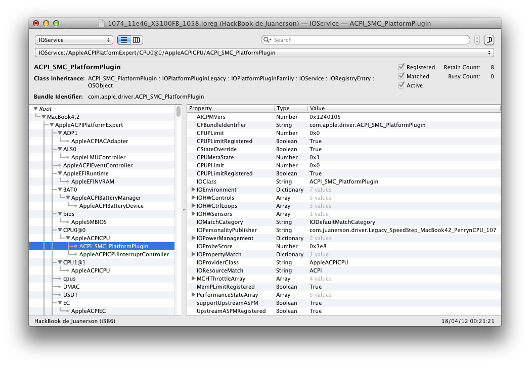

Some news. Lion 10.7.4 beta built 11e46 (see with Pacifist -- inside the Delta update) has NEW GMAX3100 DRIVERS! I have NOT tested yet...
...I will try, but first revert back to native Lion driver with lags (X3100FB.kext version 7.0.52), restart and then install the Delta Update 10.7.4 to see what happens.
EDITED: Tested the "new" recompiled drivers, BUT mouse lag appear again. So, back to the most stable framebuffer for Lion X3100FB.kext from 10.5.8 vanilla Combo.
Also, see another interesting new things about power management in 10.7.4... seems too many changes, some vestiges of Mountain Lion, look:
Edited by juanerson

(Before there I also have screen freeze with GMAX3100)
If DropSSDT=Yes + GenerateP&C-States=Yes -> Generates C&P successufull in dmesg. But in IORegExplorer see only PerfomaceStates and LPC warning in dmesg
(I understand than C-States is but dont controkked by system)
If replace my SSDT-5,SSDT-6 with your for Merom,
(other my SSDT 0,1,2,3,4,7,8 stay in Extra and loaded with your)
DropSSDT=Yes, GenerateP&C-States=No - >
have PefomanceStates & AICPMVers in IOregExplorer,
and no LPC warning in dmesg.
Juanerson, can you explaint what you do with SSDT for get work and visible C-States(AICPMVers) ?
And what I need to do with my replaced SSDT 5-6 ?
Thanks, and sorry for my english.
