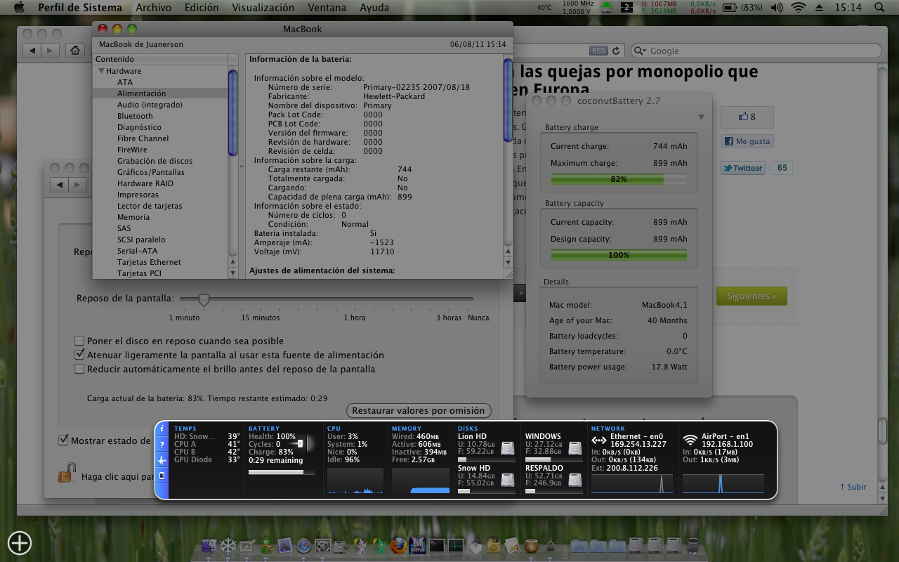

EDITED: The gsly's driver (Now SmartBattery) works great in S.L. I want to share my actual Battery involved DSDT code. This is a basic reference of declarations to replace from the DSDT V0.20 (only if you know what are you doing) for compile it:
C1C9=ECOK
C1D2=ECOR
C225=SMTX
C22C=UBIF
C230=UBST
C22F=PBIF
C22E=PBST
battery_involved_code.dsl.zip

Today I came across this kext. I installed and solved the battery X issue an the fan kicked in and working so the temp is now much lower. I will perform some more test later.
Thats version 1.3.5, from 10.6.7 I guess. I would like to know if is untouched or has some patch on it.
Im downloading 10.6.7 combo update to extract this kext and try it in Lion
