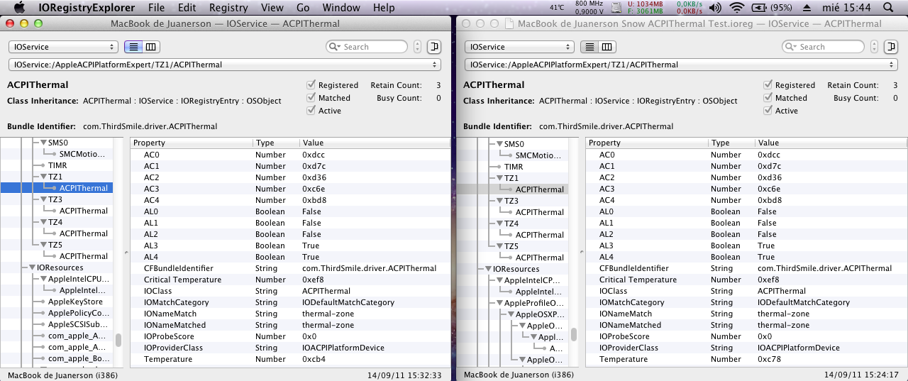

BlackCH Posted September 22, 2011 Author Share Posted September 22, 2011 @All, I am experimenting a problem after wake in Lion... related to overheating, because TZones "critical temperatures" change drastically (see in IOReg), so no good Active Cooling waking from Sleep for me. I am almost sure the problem coming from another broken part in the DSDT... you know too. What do you think? I can confirm that everytime the thermal driver unloads and loads these values change. Sometimes the difference between them is very big. I cannot confirm overheating because Im not really using Lion on regular basis. I will take a spin on the weekend to test this issue Link to comment https://www.insanelymac.com/forum/topic/135410-hp-6520s-6720s-6820s-550-sl-install-package/page/48/#findComment-1751538 Share on other sites More sharing options...
ThirdSmile Posted September 22, 2011 Share Posted September 22, 2011 @All, I am experimenting a problem after wake in Lion... related to overheating, because TZones "critical temperatures" change drastically (see in IOReg), so no good Active Cooling waking from Sleep for me. I am almost sure the problem coming from another broken part in the DSDT... you know too. What do you think? Critical temperature is not used in driver(driver simply reads it and store in IOReg). I can confirm that everytime the thermal driver unloads and loads these values change. Sometimes the difference between them is very big.I cannot confirm overheating because Im not really using Lion on regular basis. I will take a spin on the weekend to test this issue Now driver takes this values from ACPI, if there are bugs under lion - we can hardcode them in driver or in DSDT. Now I am not using lion, but under snow leopard this values seams to be correct. Link to comment https://www.insanelymac.com/forum/topic/135410-hp-6520s-6720s-6820s-550-sl-install-package/page/48/#findComment-1751574 Share on other sites More sharing options...
juanerson Posted September 25, 2011 Share Posted September 25, 2011 ... but under snow leopard this values seams to be correct. That's the exactly reason why I said: I am almost sure the problem coming from another broken part in the DSDT... Probably is not a bug (something wrong) in the driver, because only happen on Lion. Maybe, the problem is still in the DSDT. Link to comment https://www.insanelymac.com/forum/topic/135410-hp-6520s-6720s-6820s-550-sl-install-package/page/48/#findComment-1752895 Share on other sites More sharing options...
