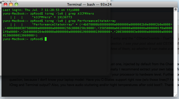

Zprood Posted July 7, 2011 Share Posted July 7, 2011 Hi, good find. From I know, that's the "Universal" C-State definition, adding the first ones C1, C2 and C3 (maybe is just one of them working), injected by default from the Chameleon flag to the Scope PR (in SSDT). So, it should works for your CPU to basic level without problem. But personally I recommend extract your own tables (for your laptop model), I think is a better idea, which will enable all the C-States for your processor to hardware level. Furthermore, I have a question, because I don't know your laptop model: Have you C-States support right now (w/o those lines)? I am talking about IOreg and Terminal output? Also, you have audio stuttering and/or hight temperatures after cold boot?. Thank you. Thanks for explanation that, my laptop is Lenovo Xuri C466M which is too old by now, the hardware is similar with hp 6520s. I think the C-state&P-sate is working, I just add three C-state from SSDT table before, and then I add all of them. P-state works by add PLimitDict in the IOPlatformThermalProfile. For the audio card, i haven't that issue, you mentioned the "high temperatures" means the fan doesn't spin with cool boot ? The fan problem is always in my place, if the laptop boots up with cool, fan doesn't spin, only I put it sleep and wakeup or restart. --Here are some information of my laptop:zprood.zip Regards. Link to comment https://www.insanelymac.com/forum/topic/135410-hp-6520s-6720s-6820s-550-sl-install-package/page/42/#findComment-1710304 Share on other sites More sharing options...
BlackCH Posted July 7, 2011 Author Share Posted July 7, 2011 OK. I think you don't want to try this, but maybe others. haha, relax my friend. Im just saying I have it working without the tweaks you outlined. In my case I dont see fit to apply them. I would test them if I find some free time in the weekend though, for the sake of knowing. Also I think C-States apply for the whole family of a particular CPU core: if you have any merom core based CPU you can use the MacBook3,1.plist as it is and it would work just fine. Same goes for penryn and the MacBook4,1.plist Anyway, I wanted to share some thoughts about Lion. The graphic performance is awful. To me, the freeze mouse pointer problem looks like a background process of some kind taking resources (maybe a hardware check?). I say this because the freeze would happens at regular intervals of time (I would say something like every 5-7 seconds). Eventhough this problem disappear replacing the drivers with the ones from snow, the graphic performance still very bad, the GUI is very chunky compared with 10.6 Link to comment https://www.insanelymac.com/forum/topic/135410-hp-6520s-6720s-6820s-550-sl-install-package/page/42/#findComment-1710449 Share on other sites More sharing options...
