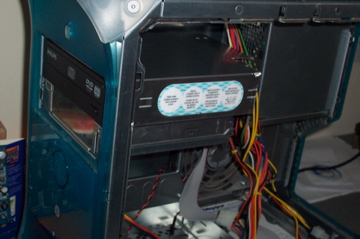

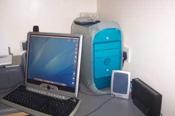

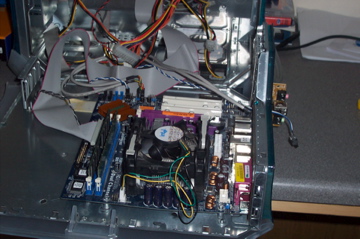

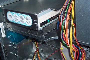

loonytunes1234 Posted March 29, 2006 Share Posted March 29, 2006 Hi, someone gave me a broken g3 b&w so i thought i would have a bash at getting my pc into it, way easier than i thought, used a hacksaw and some superglue, no kidding! The power supply was a standard atx 400w jobbie, fitted straight in, motherboard is an asrock p4 dual, used the original posts from the old logic board, literally pulled them off the tray with a pair of pliers and stuck them back down in the right position for the asrock, optical tray was hacked with a hacksaw to allow the two ram sticks to sit otherwise it got in the way and wouldnt let the tray/side close properly, all i have to do now is get the power switch wired up, and some lighting, i have used an old pc switch which is hanging out the back out of the way for now, whole thing took about three hours in total...Just thought you might be interested to see it...... Link to comment https://www.insanelymac.com/forum/topic/13351-quick-and-dirty-pc-into-a-g3-case-mod/ Share on other sites More sharing options...

g0ldr4k3 Posted September 24, 2006 Share Posted September 24, 2006 that's cool! I was doing the same thing...I got the apple studio monitor too!! but esterday I had a bad news...my new motherboard doesn't fit. the ddr2 modules are hitting against the cd tray....when I found I was going madness!! Link to comment https://www.insanelymac.com/forum/topic/13351-quick-and-dirty-pc-into-a-g3-case-mod/#findComment-194757 Share on other sites More sharing options...
OSXtotheZ Posted September 28, 2006 Share Posted September 28, 2006 I had some trouble with my mobo's dimms hitting too so I tried turning the board a different direction. And presto! Not as factory finish and will need to run some extensions to make usb ports more accessible but 100% funtional and now I have access to all 4 dimm slots! Only challenging part was the need modify a couple of capacitors that were still hitting the internal drive cage. Take a look see if you can live with it. http://www.illstyleproductions.com/pixelmix/g4casemod/ Link to comment https://www.insanelymac.com/forum/topic/13351-quick-and-dirty-pc-into-a-g3-case-mod/#findComment-197312 Share on other sites More sharing options...
