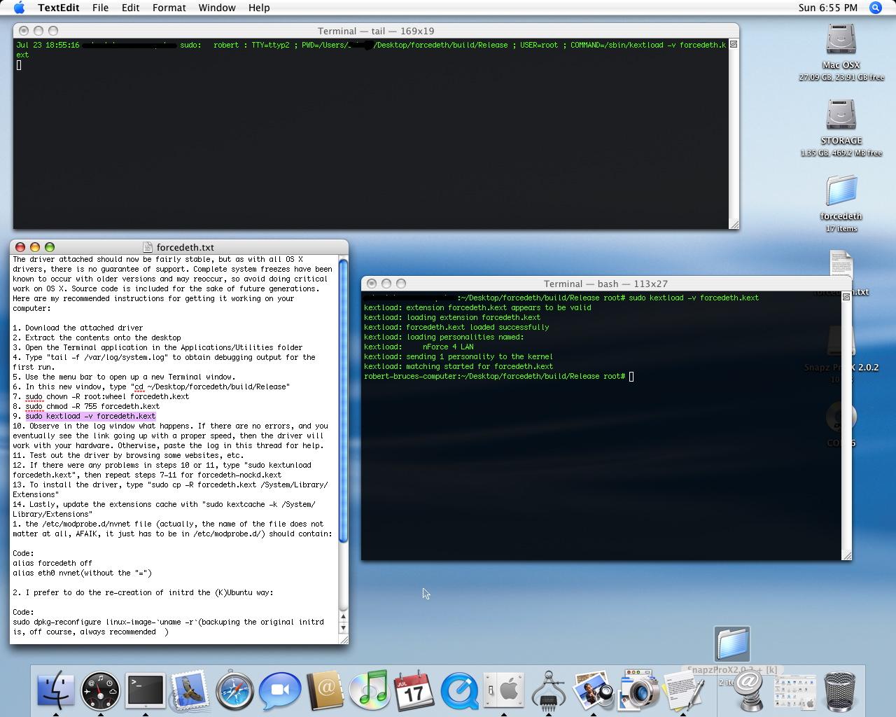

pupdawg Posted July 24, 2006 Share Posted July 24, 2006 Hello... I've been so excited to use OSX on my PC almost there... I have an nForce 410 chipset and I'm tring to get the forcedeth drivers to work. Many people are having luck but not me, I installed the driver and there is basicaly zero output from the driver... please see attached screenshot. Any ideas... I have X-Code loaded now and I'm going to start digging for a solution so if anyone can point me in the right direction, thanks. Link to comment https://www.insanelymac.com/forum/topic/12933-driver-for-nforce4-lan/page/7/#findComment-149325 Share on other sites More sharing options...
jape Posted July 24, 2006 Share Posted July 24, 2006 You have to look at the system log after kextload. Issue the "sudo dmesg" command on the Terminal, or open the Console application and select the system.log file. Link to comment https://www.insanelymac.com/forum/topic/12933-driver-for-nforce4-lan/page/7/#findComment-149358 Share on other sites More sharing options...
pupdawg Posted July 24, 2006 Share Posted July 24, 2006 Thanks but the first terminal in that screen shot shows the output of system.log there is nothing. You have to look at the system log after kextload.Issue the "sudo dmesg" command on the Terminal, or open the Console application and select the system.log file. Link to comment https://www.insanelymac.com/forum/topic/12933-driver-for-nforce4-lan/page/7/#findComment-149389 Share on other sites More sharing options...
jape Posted July 24, 2006 Share Posted July 24, 2006 Oops. Maybe the network card device id has changed on nForce 410? You may check this in Windows: Open Device Manager, right click your card, properties, details tab, and read. In my A8N-E "NVNET_DEV0057" appears on the string. Link to comment https://www.insanelymac.com/forum/topic/12933-driver-for-nforce4-lan/page/7/#findComment-149464 Share on other sites More sharing options...
pupdawg Posted July 24, 2006 Share Posted July 24, 2006 My MSI board has the ID NVNET_DEV0269 can I just edit the kext info.plist to make this work?? I'm going to try that now anyway. Thanks Oops. Maybe the network card device id has changed on nForce 410? You may check this in Windows: Open Device Manager, right click your card, properties, details tab, and read. In my A8N-E "NVNET_DEV0057" appears on the string. Link to comment https://www.insanelymac.com/forum/topic/12933-driver-for-nforce4-lan/page/7/#findComment-149610 Share on other sites More sharing options...
pupdawg Posted July 24, 2006 Share Posted July 24, 2006 One step closer... ok I added my ID's to the forcedeth.kext info.plist and now I get the following output that looks promising... The MAC address is correct but I get a 169 IP address and no connection. Jul 24 09:06:54 robert-computer kernel[0]: NMAC: family specific matching fails Jul 24 09:06:54 robert-computer kernel[0]: forcedeth: Initializing. Jul 24 09:06:54 robert-computer kernel[0]: forcedeth: Probing. Jul 24 09:06:54 robert-computer kernel[0]: forcedeth: WARNING - your nVidia device 0x10DE:0x0269 is not known to work, but it could be supported in the future. Please contact the coder. Continuing anyway... Jul 24 09:06:54 robert-computer kernel[0]: forcedeth: Starting. Jul 24 09:06:54 robert-computer kernel[0]: forcedeth: PCI system 0x10DE:0x0269, subsystem 0x1462:0x7207 opened. Jul 24 09:06:54 robert-computer kernel[0]: forcedeth: Mapped from 0xF9FDC000 of length 4096. Jul 24 09:06:54 robert-computer kernel[0]: forcedeth: Allocated 3072 bytes of contiguous memory for DMA: rx at 0x22bf9000, tx at 0x22bf9400, wired at 0x5405000. Jul 24 09:06:54 robert-computer kernel[0]: forcedeth: Found nForce4 LAN with MAC: 00:13:D3:EC:0A:07. Jul 24 09:06:54 robert-computer kernel[0]: forcedeth: Found PHY 0x0000:0x0020 at address 1. Jul 24 09:06:54 robert-computer kernel[0]: com_triton_forcedeth: Ethernet address 00:13:d3:ec:0a:07 Jul 24 09:06:54 robert-computer kernel[0]: forcedeth: Enabling... 1 2 3 4 5 6 7 Jul 24 09:06:54 robert-computer kernel[0]: forcedeth: Starting transmit/receive engines Jul 24 09:06:54 robert-computer kernel[0]: forcedeth: Network link down. Jul 24 09:06:56 robert-computer kernel[0]: forcedeth: Link speed now 100Mbps, code 0x10064. Jul 24 09:07:01 robert-computer launchd: Server 0 in bootstrap 1103 uid 0: "/usr/sbin/lookupd"[88]: exited abnormally: Hangup Jul 24 09:07:01 robert-computer configd[50]: executing /System/Library/SystemConfiguration/Kicker.bundle/Contents/Resources/enable-network Jul 24 09:07:01 robert-computer configd[50]: posting notification com.apple.system.config.network_change Jul 24 09:07:01 robert-computer lookupd[175]: lookupd (version 369.5) starting - Mon Jul 24 09:07:01 2006 Jul 24 09:07:01 robert-computer ntpdate[187]: can't find host time.apple.com\n Jul 24 09:07:01 robert-computer ntpdate[187]: no servers can be used, exiting Jul 24 09:07:01 robert-computer configd[50]: target=enable-network: disabled UPDATE: I've also ran the forcedeth-nockd.kext and have attched the output... My MSI board has the ID NVNET_DEV0269 can I just edit the kext info.plist to make this work?? I'm going to try that now anyway. Thanks forcedethlog.rtf Link to comment https://www.insanelymac.com/forum/topic/12933-driver-for-nforce4-lan/page/7/#findComment-149621 Share on other sites More sharing options...
pupdawg Posted July 25, 2006 Share Posted July 25, 2006 SUCCSESS!! Ok... what I did to make this all work. First make sure your using the newest drivers... there are two posts with driver attachments in this thread the second one suggests that it is more current but it is the one attached to the first post that is newer... I also had to use the forcedeth-nockd.kext and edit the info.plist file in that package to add my nforce 410 ID's. The nforce ID I have is 0269 if anyone would like to add them into the driver for the future After doing this everything is working fine... but I get a lot of debug output to the logs and can't seem to use the forcedeth-nock.kext as it say's it is not a valid package. <--- anyone know how to fix this ? Thanks. Link to comment https://www.insanelymac.com/forum/topic/12933-driver-for-nforce4-lan/page/7/#findComment-150091 Share on other sites More sharing options...

Aien Posted July 28, 2006 Share Posted July 28, 2006 this sounds very promising... but what do u edit (exactly) and into where? what i did: -followed steps 1-3 (using zip attached to 1st post), -followed steps 6-9 (replacing all forcedeth.kext referances with forcedeth-nockd.kext, and replacing both instances of 0057 with 0269 in info.plist in \forcedeth\build\release\forcedeth-nockd.kext package) ..which didn't work.. FYI i have a 410 mobo (biostar 6100) I have the same mobo. What happens when you do the install? Link to comment https://www.insanelymac.com/forum/topic/12933-driver-for-nforce4-lan/page/7/#findComment-151314 Share on other sites More sharing options...
pupdawg Posted July 29, 2006 Share Posted July 29, 2006 The MB I use is the K8NGM2-L also... the biostar may not use the same ID's... use Device Manager in Windows and look up the NVIDIA nForce Networking Controller Properties and then Details Tab you'll see a reference of NVNET_DEVXXXX <---XXXX is your ID. If you get a 169 address power down your system and unplug it from the wall for 30 sec... I think the forcedeth driver being used may suffer from the same ACPI bugs that the older Linux forcedeth driver did and after booting into windows and then back to Linux the driver would not work untel you remove the power to the card for 30 sec... you do need to unplug the power from the wall because most cards have wake on lan power even when the system is powered off. this sounds very promising... but what do u edit (exactly) and into where? what i did: -followed steps 1-3 (using zip attached to 1st post), -followed steps 6-9 (replacing all forcedeth.kext referances with forcedeth-nockd.kext, and replacing both instances of 0057 with 0269 in info.plist in \forcedeth\build\release\forcedeth-nockd.kext package) ..which didn't work.. FYI i have a 410 mobo (biostar 6100) Link to comment https://www.insanelymac.com/forum/topic/12933-driver-for-nforce4-lan/page/7/#findComment-151794 Share on other sites More sharing options...

sotl Posted July 30, 2006 Share Posted July 30, 2006 Thanks A TON Planetbeing/Pupdawg for helping me get my ethernet up and running on my NForce 4 mobo (nvidia ethernet dev 0269). After shutting down and unplugging my power cord for 30 seconds because DHCP was not assigning properly it all worked. I now respond from Camino browser 1 down, 2 to go (sound/graphics) Link to comment https://www.insanelymac.com/forum/topic/12933-driver-for-nforce4-lan/page/7/#findComment-152135 Share on other sites More sharing options...
mb2 Posted July 30, 2006 Share Posted July 30, 2006 Aien/pupdawg; are my actions outlined in 'what i did' exactly the same as u did? (i'm still not sure of my editing for the device ID; but i do know my device ID is 0269.) and nothing more? (i'm think i've read u have to do something else to get it to work after a restart.. but maybe i'm wrong..) i'm not sure how i can find out weather i'm getting a 169 or not.. i dont think i ever got (doing what i outlined^^^) an NIC found in the system properties.. please make it 100% idiot-proof if possible, as it can get a little confusing/fustrating ..i'd like to know if i'm doing the right thing before i try again (with the 30s off..) ~thanks Link to comment https://www.insanelymac.com/forum/topic/12933-driver-for-nforce4-lan/page/7/#findComment-152187 Share on other sites More sharing options...
