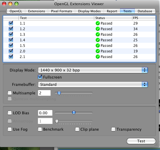

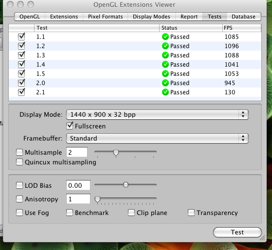

Alex DeWolf Posted September 13, 2008 Author Share Posted September 13, 2008 how do u know is slow? I think the attached image shows pretty slow opengl tests. Also HalfLife2 on Crossover is really slow on this machine, on a Mac Book with the ATI X3100 it is much smoother and faster. Alex Link to comment https://www.insanelymac.com/forum/topic/125713-opengl-in-osx/#findComment-888859 Share on other sites More sharing options...
Slice Posted September 13, 2008 Share Posted September 13, 2008 I think the attached image shows pretty slow opengl tests. Also HalfLife2 on Crossover is really slow on this machine, on a Mac Book with the ATI X3100 it is much smoother and faster. Alex OpenGL Extension Viewer is a strange program. As well as XBench. Better try Open Mark and Cinebench. Crossover uses windows drivers so I doubt it can run fast OpenGL. What is ATI X3100? May be you mean Intel X3100? It would be nice if you publish your config sudo -skextstat >kextstatDeWolf.txt ioreg -l -x -w 2048 >ioregDeWolf.txt Link to comment https://www.insanelymac.com/forum/topic/125713-opengl-in-osx/#findComment-888891 Share on other sites More sharing options...

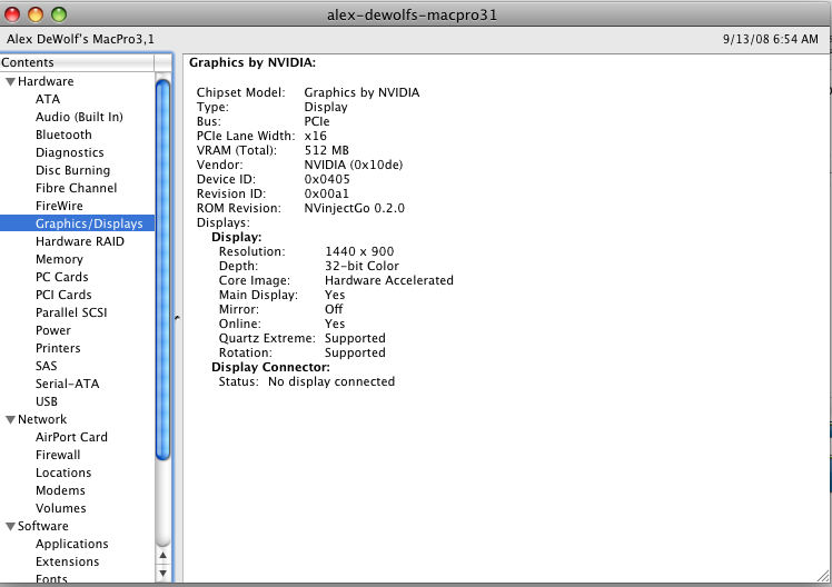

aqua-mac Posted September 13, 2008 Share Posted September 13, 2008 Can you show your info from system profiler under the section Graphics card. I doubt very much that you do actually have QE or CI enabled. Link to comment https://www.insanelymac.com/forum/topic/125713-opengl-in-osx/#findComment-888901 Share on other sites More sharing options...

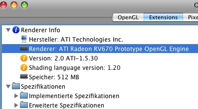

mitch_de Posted September 13, 2008 Share Posted September 13, 2008 OpenGL Extension Viewer is a strange program. As well as XBench. Better try Open Mark and Cinebench.Crossover uses windows drivers so I doubt it can run fast OpenGL. What is ATI X3100? May be you mean Intel X3100? It would be nice if you publish your config No, OpenGL Extensions Viewer benches are very good and reliable - much better than Xbench, where GMA950 are faster than ATI 2600XT!!!! Xbench OpenGL values are for the trash (rest of valuesa are OK). Perhaps you use Softwarerendering mode (CPU) , not hardware OpenGL mode(GPU)! how check if sw rendering (CPU!!) or hw (GPU) rendering: Look in TAB Extensions , there should NOT be an Apple Software Renderer .... Rendering, insted Intel GMA X3100 Renderer (HW) I posted my ATI HD3850 Info : Renderer: ATI..... (GPU) and my Bench Vales at 1600x1200/32 Bit/BenchMode Also in the test this is shown upper left corner Renderer: If it shows Intel GMA X3100 then all is right, i would set the framebuffer as standard). X3100 isnt so fast in higer resolution - as yours. Link to comment https://www.insanelymac.com/forum/topic/125713-opengl-in-osx/#findComment-888909 Share on other sites More sharing options...
Alex DeWolf Posted September 13, 2008 Author Share Posted September 13, 2008 Attached is the system profiler screen shot, ioreg and kext txt files. Thanks for everyone's help. Alex DeWolf ioregDeWolf.txt kextstatDeWolf.txt Link to comment https://www.insanelymac.com/forum/topic/125713-opengl-in-osx/#findComment-889267 Share on other sites More sharing options...

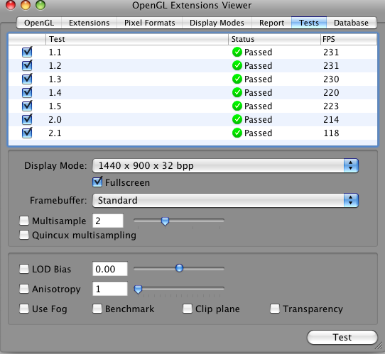

Cheops Posted September 13, 2008 Share Posted September 13, 2008 Try setting one of your corners in expose to put the display to sleep then re awake it and re-run the tests Ade. Link to comment https://www.insanelymac.com/forum/topic/125713-opengl-in-osx/#findComment-889272 Share on other sites More sharing options...
Alex DeWolf Posted September 13, 2008 Author Share Posted September 13, 2008 No, OpenGL Extensions Viewer benches are very good and reliable - much better than Xbench, where GMA950 are faster than ATI 2600XT!!!! Xbench OpenGL values are for the trash (rest of valuesa are OK). Perhaps you use Softwarerendering mode (CPU) , not hardware OpenGL mode(GPU)! how check if sw rendering (CPU!!) or hw (GPU) rendering: Look in TAB Extensions , there should NOT be an Apple Software Renderer .... Rendering, insted Intel GMA X3100 Renderer (HW) I posted my ATI HD3850 Info : Renderer: ATI..... (GPU) and my Bench Vales at 1600x1200/32 Bit/BenchMode Also in the test this is shown upper left corner Renderer: If it shows Intel GMA X3100 then all is right, i would set the framebuffer as standard). X3100 isnt so fast in higer resolution - as yours. Well what I was saying is that it seems like rendering on my Asus laptop with the Nvidia 9500M and 512MB VRAM is slower than my Mac Book with the Intel (sorry not ATI) X3100 with shared memory. Here is a screenshot of the extensions tab. Thanks Alex Link to comment https://www.insanelymac.com/forum/topic/125713-opengl-in-osx/#findComment-889273 Share on other sites More sharing options...

Alex DeWolf Posted September 13, 2008 Author Share Posted September 13, 2008 Try setting one of your corners in expose to put the display to sleep then re awake it and re-run the tests Ade. I did this and no change. Alex Link to comment https://www.insanelymac.com/forum/topic/125713-opengl-in-osx/#findComment-889281 Share on other sites More sharing options...

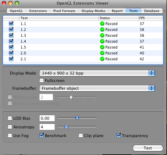

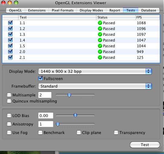

Alex DeWolf Posted September 13, 2008 Author Share Posted September 13, 2008 Try setting one of your corners in expose to put the display to sleep then re awake it and re-run the tests Ade. Well check this out. There is an almost 10 fold speed improvement in the opengl test (1st screenshot is before and 2nd is after) However, HalfLife2 is still choppy. Alex Link to comment https://www.insanelymac.com/forum/topic/125713-opengl-in-osx/#findComment-889531 Share on other sites More sharing options...

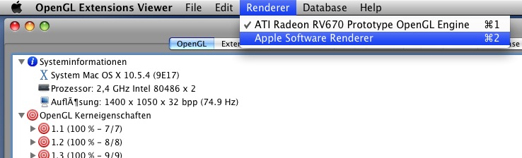

mitch_de Posted September 14, 2008 Share Posted September 14, 2008 So it is proven that on laptops there are problems getting the nvidia hardware activated. Even though it says hardware accelorated the fact is it lies and isn't true so beware laptop users with nvidia cards we need a fix for this ASAP. Thanks Ade To check this you can test with OpenGLExtensionvierer the results from "hw opengl" and Apple Software Rendering". If the two OpenGLExtemsiomsViewer Benchmark values are near the same hw opengl isnt really/not 100% working - even shown in systemprofiler as CI/QE card. If HW Bench values are at least by 10* higher(faster) than SW bench values, hw opengl is working, maybe some driver glitches with your mobile gpu. HOW: Look at my screenshoot , easy switch between those 2 modes (HW OPENGL / Apple Softwarerendering). My ATI3850 is in Apple Software Rendering Mode > 200 Times (openGl 1.1 -2.0) SLOWER than HW Rendering, At 2.1 20 times faster. Running in my res: 1600x1200/ 32 Bit, C2D 2.4 GHZ. The smaller the resolution or faster the CPU, the less the difference between both modes. So your Mobile GPUs should be at very least 20 times faster in HW OpenGL Mode in all is OK, or even 10 times faster with some OpenGL driver problems. Link to comment https://www.insanelymac.com/forum/topic/125713-opengl-in-osx/#findComment-890193 Share on other sites More sharing options...
Alex DeWolf Posted September 14, 2008 Author Share Posted September 14, 2008 To check this you can test with OpenGLExtensionvierer the results from "hw opengl" and Apple Software Rendering".If the two OpenGLExtemsiomsViewer Benchmark values are near the same hw opengl isnt really/not 100% working - even shown in systemprofiler as CI/QE card. If HW Bench values are at least by 10* higher(faster) than SW bench values, hw opengl is working, maybe some driver glitches with your mobile gpu. HOW: Look at my screenshoot , easy switch between those 2 modes (HW OPENGL / Apple Softwarerendering). My ATI3850 is in Apple Software Rendering Mode > 200 Times (openGl 1.1 -2.0) SLOWER than HW Rendering, At 2.1 20 times faster. Running in my res: 1600x1200/ 32 Bit, C2D 2.4 GHZ. The smaller the resolution or faster the CPU, the less the difference between both modes. So your Mobile GPUs should be at very least 20 times faster in HW OpenGL Mode in all is OK, or even 10 times faster with some OpenGL driver problems. OK I ran this first using Apple software rendering then Nvidia's open GL engine. Ineed the Apple software rendering is like 100 times slower. What I am wondering about are the numbers for the last 2 tests. Is this why HalfLife2 is so slow? Alex Link to comment https://www.insanelymac.com/forum/topic/125713-opengl-in-osx/#findComment-890419 Share on other sites More sharing options...

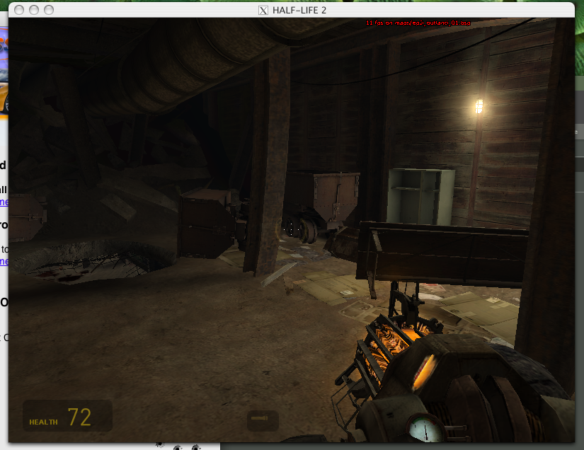

Alex DeWolf Posted September 14, 2008 Author Share Posted September 14, 2008 Here is a HalfLife2:Episode 2 screenshot with FPS displayed (11 FPS). I still can't figure this out. Alex Your Nvidia is really fast. I have no such result while all other tests and games work fine.OneGl Extension Viewer in WindowsXP run with the same speed as sowtware renderer in MacOSX. Try Cinebench that exists in both WinXP and in MacOX Cinebench R10 results (NOTE:I have to boot with cpus=1 so only single cpu results): CINEBENCH R10 **************************************************** Tester : Alex DeWolf Processor : Intel T9300 MHz : 2.4 GHZ Number of CPUs : 1 Operating System : OS X 32 BIT 10.5.4 Graphics Card : NVIDIA GeForce 8600 GTS OpenGL Engine Resolution : <fill this out> Color Depth : <fill this out> **************************************************** Rendering (Single CPU): 2462 CB-CPU Rendering (Multiple CPU): --- CB-CPU Shading (OpenGL Standard) : 4370 CB-GFX **************************************************** Alex Your Nvidia is really fast. I have no such result while all other tests and games work fine.OneGl Extension Viewer in WindowsXP run with the same speed as sowtware renderer in MacOSX. Try Cinebench that exists in both WinXP and in MacOX Here are my Cinebench R10 results (NOTE: I have to boot with cpus=1 so there are only single cpu results): CINEBENCH R10 **************************************************** Tester : Alex DeWolf Processor : Intel T9300 MHz : 2.4 GHZ Number of CPUs : 1 Operating System : OS X 32 BIT 10.5.4 Graphics Card : NVIDIA GeForce 8600 GTS OpenGL Engine Resolution : <fill this out> Color Depth : <fill this out> **************************************************** Rendering (Single CPU): 2462 CB-CPU Rendering (Multiple CPU): --- CB-CPU Shading (OpenGL Standard) : 4370 CB-GFX **************************************************** Alex Here's the Cinebench 10 results. I have top boot with cpus=1 so only single cpu usage: CINEBENCH R10 **************************************************** Tester : Alex DeWolf Processor : Intel T9300 MHz : 2.4 GHZ Number of CPUs : 1 Operating System : OS X 32 BIT 10.5.4 Graphics Card : NVIDIA GeForce 8600 GTS OpenGL Engine Resolution : <fill this out> Color Depth : <fill this out> **************************************************** Rendering (Single CPU): 2462 CB-CPU Rendering (Multiple CPU): --- CB-CPU Shading (OpenGL Standard) : 4370 CB-GFX Link to comment https://www.insanelymac.com/forum/topic/125713-opengl-in-osx/#findComment-890701 Share on other sites More sharing options...
