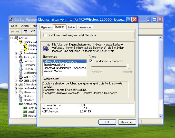

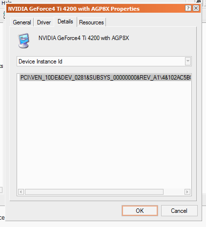

Ivewind Posted April 10, 2006 Share Posted April 10, 2006 here's how i do it in windows xp. * right click My Computer, hight light and select Management * Computer Management window pops up. On the left pane, select "Device Manager" * On the right pane, expand Network Devices * Highlight your wireless card, right click and select properties * The Device Properties window pops up, click on Detail tab * On the pull down below, select Hardware IDs * Vendor ID is the four-digit character after "Vend_" * Device ID is the four-digit character after "Dev_" all though the goal of this page is to provide quick links to information, it helps to use the search if the information is not located here. you might just stumble on new interesting information you can learn from. good luck. can anyone post a screenshot of the point " On the pull down below, select Hardware IDs" I'm from germany so it is quite hard for me to find this point in the german os. thx Icewind p.s. in german it looks like this Link to comment https://www.insanelymac.com/forum/topic/11816-hp-compaq-laptop-with-x200-southbridge-resource-v01a/page/2/#findComment-93063 Share on other sites More sharing options...
glennpratt Posted April 10, 2006 Share Posted April 10, 2006 can anyone post a screenshot of the point " On the pull down below, select Hardware IDs"I'm from germany so it is quite hard for me to find this point in the german os. thx Icewind p.s. in german it looks like this Looks like you need to go one tab right. You can generally see the info you need on the Device Instance ID tab as well. I used my graphics card, but they all look the same. In this case Vendor ID = 10DE; Device ID = 0281 Link to comment https://www.insanelymac.com/forum/topic/11816-hp-compaq-laptop-with-x200-southbridge-resource-v01a/page/2/#findComment-93269 Share on other sites More sharing options...
Ivewind Posted April 10, 2006 Share Posted April 10, 2006 finally i fixed the problem i installed sp2 and the detail button appeared seems like there is no detail button in sp1 but thx for the help Link to comment https://www.insanelymac.com/forum/topic/11816-hp-compaq-laptop-with-x200-southbridge-resource-v01a/page/2/#findComment-93430 Share on other sites More sharing options...
