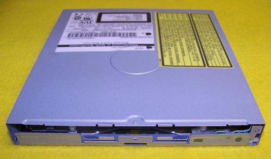

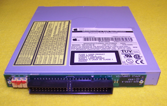

macspc Posted July 30, 2008 Share Posted July 30, 2008 I just bought the Intel Mini Itx board. I plan on building my own case so I have a question on hardware. I would like a slot load DVDrom. I found some apple versions that are available on various sites that are less expensive. Will these work in this mini ITX board? It looks like they have the regualr IDE connector but I am dumbfounded to how they are powered up. I can't see the power connector in the picture. Anyone have any ideas? Link to comment https://www.insanelymac.com/forum/topic/113623-build-a-perfect-mac-for-less-than-250/page/9/#findComment-839345 Share on other sites More sharing options...
DiaboliK Posted July 30, 2008 Share Posted July 30, 2008 I just bought the Intel Mini Itx board. I plan on building my own case so I have a question on hardware. I would like a slot load DVDrom. I found some apple versions that are available on various sites that are less expensive. Will these work in this mini ITX board? It looks like they have the regualr IDE connector but I am dumbfounded to how they are powered up. I can't see the power connector in the picture. Anyone have any ideas? thats an older drive that takes less power so it gets power from the ide cable. (keep in mind its a apple drive, they like to mess with the power, take the macbook air superdrive for example.) nowadays you have an adaptor just like it but it has a 4pin berg connector to supply power to the drive. they also come in various flavors from ide or fdd ribbon cables or usb. -D- Link to comment https://www.insanelymac.com/forum/topic/113623-build-a-perfect-mac-for-less-than-250/page/9/#findComment-839379 Share on other sites More sharing options...
