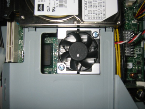

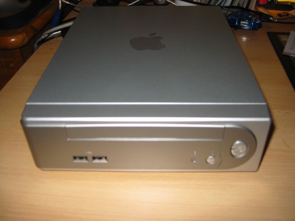

rickberman66 Posted August 21, 2008 Share Posted August 21, 2008 hi, i get the file here in the forum somewhere, dont know where exactly that was. anyway, here is the File. btw. i get my morex cubid 3677 case today, great case, but i had to "dremel" the hdd&dvd-drive holder a little bit, so that the CHipset cooler fits. and i had to solder the 4pin 12v power connector for the board to the atx power cable, because there was none. only the dvd drive isnt here, using an usb external atm. AppleACPIPlatform.kext_restart_fixed.zip Link to comment https://www.insanelymac.com/forum/topic/113623-build-a-perfect-mac-for-less-than-250/page/13/#findComment-864269 Share on other sites More sharing options...
