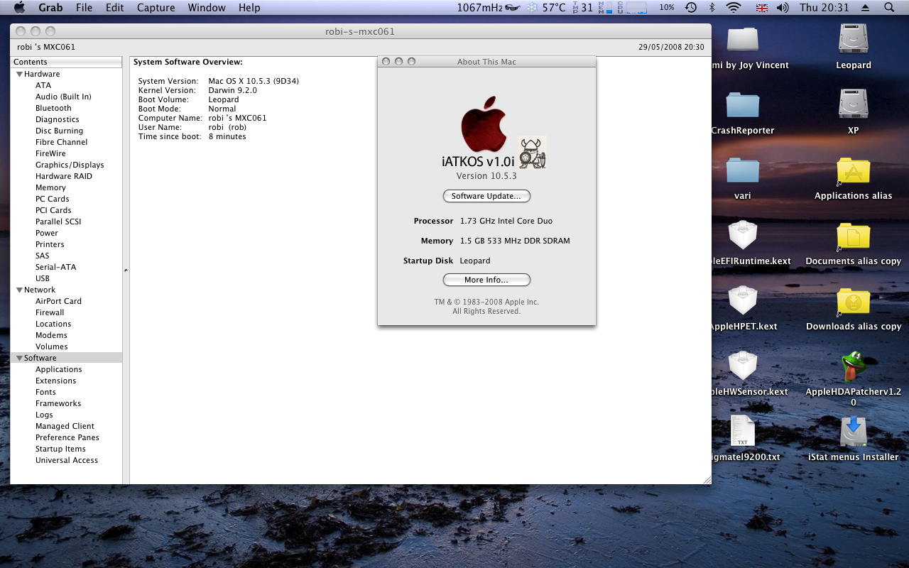

robi62 Posted May 29, 2008 Share Posted May 29, 2008 Latest update on my dell 640m.I installed upgrade from package not with pacifist then I tried to replace my important kext with kext helper woud not let me.It said failed to log in as root.So i booted up from usb leo install replaced applesmbios , applehpet ,appleintegratedframebuffer, appleacpiplatform,appleccpupowermanagment,and mach kernel with my old ones.I rebooted first with -f -v then with -xIt started but I had to reinstall appleintegratedframebuffer with kext helper.Rebooted but now I get cpu panick but if I boot in safe mode is fine any suggestions ????????I have speedstep kernel installedHere is my pic to show running update it took no more than 20 minutes with pacifist took me an hourI also noticed my mouse artifact is now gone I used to get it a lot when I used Flock browser just tried now and is not there I also noticed the only thing not working is battery meter anymore........and because I am running in safe mode my cpu does not have speed step so running at full speed and fan coming on a lot....... have sorted every thing out. I was getting cpu panic because I did not reinstall all kexts with kext helper after 2nd boot i only did appleintegratedframebuffer becuse was showing as not installed properly. I did them all and also I reinstall my sound with apple hda patcher + sigmatel 9200 and bingo all running except battery meter . I am sure some wiz will find solution..... PS after reinstalling all kexts unfortunately got mouse artifact back.I wonder which kext is responsible for this........... Link to comment https://www.insanelymac.com/forum/topic/107417-1053-experiences-whats-it-break/#findComment-763369 Share on other sites More sharing options...
00diabolic Posted May 30, 2008 Author Share Posted May 30, 2008 Latest update on my dell 640m.I installed upgrade from package not with pacifist then I tried to replace my important kext with kext helper woud not let me.It said failed to log in as root.So i booted up from usb leo install replaced applesmbios , applehpet ,appleintegratedframebuffer, appleacpiplatform,appleccpupowermanagment,and mach kernel with my old ones.I rebooted first with -f -v then with -xIt started but I had to reinstall appleintegratedframebuffer with kext helper.Rebooted but now I get cpu panick but if I boot in safe mode is fine any suggestions ????????I have speedstep kernel installedHere is my pic to show running update it took no more than 20 minutes with pacifist took me an hourI also noticed my mouse artifact is now gone I used to get it a lot when I used Flock browser just tried now and is not there I also noticed the only thing not working is battery meter anymore........and because I am running in safe mode my cpu does not have speed step so running at full speed and fan coming on a lot....... have sorted every thing out. I was getting cpu panic because I did not reinstall all kexts with kext helper after 2nd boot i only did appleintegratedframebuffer becuse was showing as not installed properly. I did them all and also I reinstall my sound with apple hda patcher + sigmatel 9200 and bingo all running except battery meter . I am sure some wiz will find solution..... PS after reinstalling all kexts unfortunately got mouse artifact back.I wonder which kext is responsible for this........... Not sure I can help with that, never had artifacts except in tiger.. Hey what is that sunglasses icon a part of? Also is that snowflake part of coolbook (i'm guessing you paid for it)? Hope someone can help you out. Can you list out your full specs. Link to comment https://www.insanelymac.com/forum/topic/107417-1053-experiences-whats-it-break/#findComment-763549 Share on other sites More sharing options...

robi62 Posted May 30, 2008 Share Posted May 30, 2008 Not sure I can help with that, never had artifacts except in tiger.. Hey what is that sunglasses icon a part of? Also is that snowflake part of coolbook (i'm guessing you paid for it)? Hope someone can help you out. Can you list out your full specs. the sunglasses is called shades it control the brightness of the screen on my dell because default keys not working yes coolbook i paid for it unfortunately does not throttle with vanilla kernel although he reads cpu speed was only working on 2 speeds,also it works only with applesmbios with id macbook or mac pro not with netkas . my specs cpu t2250 1.73 ghz only working 1 cpu booting with cpus=1 string in applebootlist fsb 533 hdd 80 gb sata lan broadcom 4400 gma 950 memry 1.5gb 533 wlan dell 1500n audio sigmatel 9200 Everything works from 1st boot except audio I use patcher hda v1.20 with sigmatel 9200 dump Link to comment https://www.insanelymac.com/forum/topic/107417-1053-experiences-whats-it-break/#findComment-763818 Share on other sites More sharing options...
