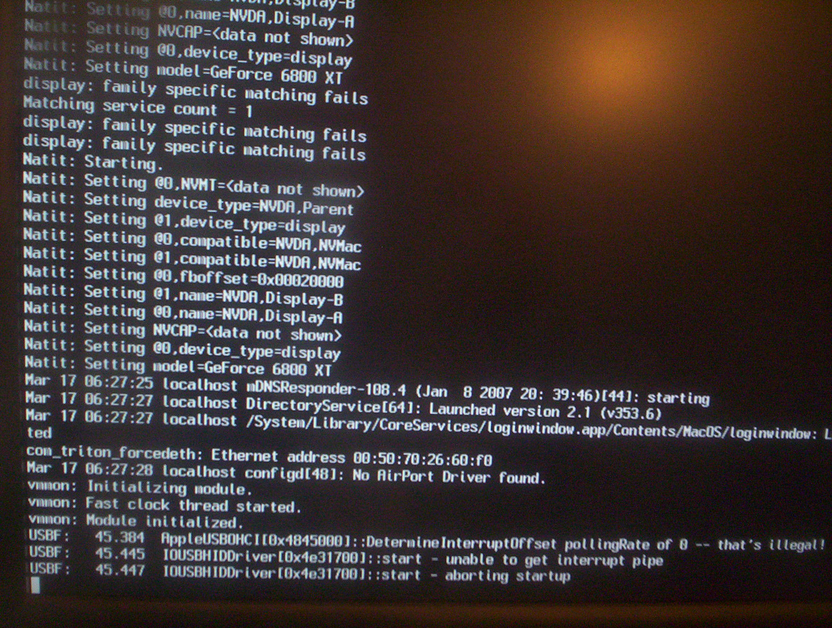

  • Location:Portland, OR
used netkas loginwindow fix can get to desktop in vmware but native it freezes up during boot.

If you can get in vmware it's either natit crapping out or your id isn't in one of the nvidia kexts or the new nvidia kexts hate your card.
First check the id in all the kexts , if it's in try with titan , try booting with -f -x too
