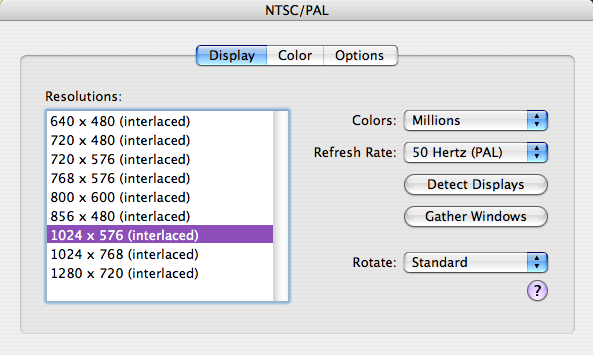

Atmosfear Posted November 22, 2006 Share Posted November 22, 2006 (edited) Hi, just wanted to notice you, that you should be able to get proper Composite or S-Video TV-Out using Apples DVI to Video Adapter sold for about 20 EUR. The adapter says "requires Mac mini or Power Mac G5" but it works fine on my MacBook Pro 17" aswell as my 10.4.8 Hackintosh w/Natit Radeon X1900 XT. The adapter is detected as second monitor "NTSC/PAL" and offers these interlaced Resolutions in both PAL and NTSC-Refreshrates: 640x480 VGA 720x480 4:3 SD NTSC 720x576 4:3 SD PAL 768x576 Square-Pixel SD PAL 800x600 SVGA 856x480 16:9 SD NTSC 1024x576 16:9 SD PAL 1024x768 XGA 1280x720 HD 720p I suspect this will also work fine with Dual-Screen capable Nvidia cards using Natit and also with GMA900/950 if a PCIe DVI-Connector-Card is installed. The output quality is pretty good and I'll be using it as control monitor out for Final Cut Pro HD (or for watching movies ;-)). Although my device is labled for PAL it supports NTSC as well, I guess it just uses PAL as default when used as bootup screen. Edit: Seems not to work with Nvidia Cards for now ... Have Fun, Atmos Edited February 8, 2007 by Atmosfear Link to comment Share on other sites More sharing options...
