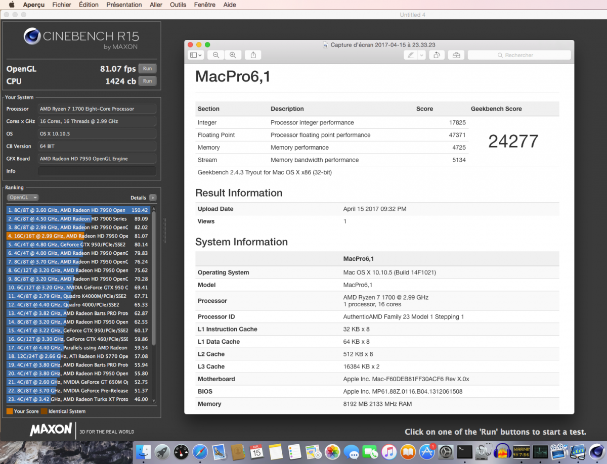

Ryzen !

Ryzen no works,
point final

no Sierra :)
