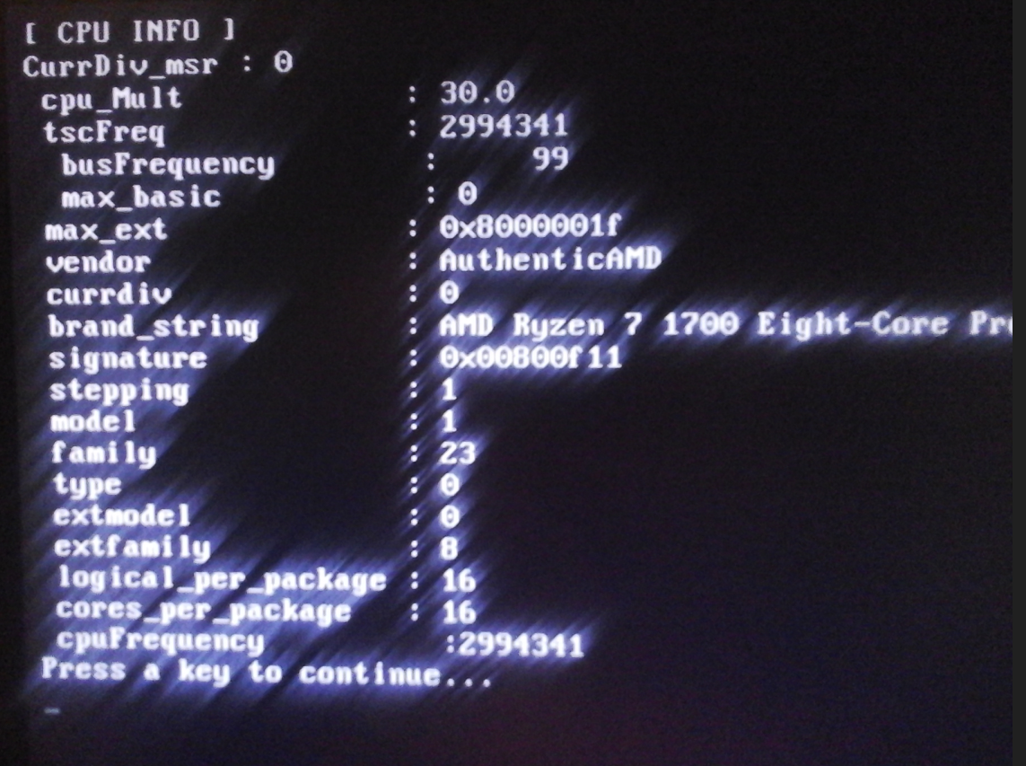

gills83 Posted July 16, 2017 Share Posted July 16, 2017 Micky made changes for Nvidia on Sierra with Enoch. I did not know this flag !! It's good nV works with chameleon OpenGL results are still as bad with nV Enoch (r2890 Ryzen Test) [2017-07-16 14:48:26] Logging started: 2017/07/16, 19:57:46 [ CPU INFO ] Looking to disable C1E if is already enabled by the BIOS: Attempting to scan GPT boot volumes [biosdev=80h]: Attempting to read GPT Read GPT Reading GPT partition 1, type C12A7328-F81F-11D2-BA4B-00A0C93EC93B Reading GPT partition 2, type EBD0A0A2-B9E5-4433-87C0-68B6B72699C7 Reading GPT partition 3, type 48465300-0000-11AA-AA11-00306543ECAC Reading GPT partition 4, type 48465300-0000-11AA-AA11-00306543ECAC Reading GPT partition 5, type 426F6F74-0000-11AA-AA11-00306543ECAC Reading GPT partition 6, type 48465300-0000-11AA-AA11-00306543ECAC Reading GPT partition 7, type EBD0A0A2-B9E5-4433-87C0-68B6B72699C7 Attempting to scan GPT boot volumes [biosdev=81h]: Attempting to scan FDISK boot volumes [biosdev=81h]: Scanning device 80... Boot UUID of 'sierra' (GPT HFS+): 3C2CFA8A-F0EA-3157-9866-AF0229C65BA5 No kexts.plist replacement found. Kernel Cache file path (OS X 10.11 and newer): /System/Library/PrelinkedKernels/prelinkedkernel Loading Kernel Cache from: 'sierra' (GPT HFS+) Booting on macOS 10.12.6 (16G24b) System Integrity Protection status: disabled (Default Configuration). CsrActiveConfig = 0x67 (1100111) Configuration: Kext Signing: disabled Filesystem Protections: disabled Task for PID: disabled Debugging Restrictions: enabled Apple Internal: enabled DTrace Restrictions: disabled NVRAM Protections: disabled Decompressing Kernel Cache: - Decompressing Kernel Using lzvn [ KERNEL PATCHER START ] Will patch for 16.5.0 kernel version compatible. KernelBooter_kexts state: enabled! KernelPm state: enabled! KernelLapicError state: disabled! KernelLapicVersion state: disabled! KernelHaswell state: disabled! KernelcpuFamily state: disabled! KernelSSE3 state: disabled! - Searching for booter extensions pattern: Found Sierra EXT pattern: patched! 1 substitution(s) made. - Patching kernel power management... Kernel power management patch region not found! Kernel patcher: end! [ KEXTS PATCHER START ] Patching NVDAStartupWeb (force load w/o nvram): 1 substitutions made! Kexts patcher: end! ACPI Table not found: DSDT.aml No DSDT found, using 0 as uid value. Using PCI-Root-UID value: 0 [ ETHERNET DEVICE INFO ] Class code: [0200] EthernetBuiltIn = Yes Location number: 1 Setting up lan keys Realteck RTL8111/8168 PCI-E Gigabit Ethernet [10ec:8168] PciRoot(0x0)/Pci(0x1,0x3)/Pci(0x0,0x2)/Pci(0x6,0x0)/Pci(0x0,0x0) [ ETHERNET DEVICE INFO ] Class code: [0200] EthernetBuiltIn = Yes Location number: 2 Setting up lan keys Realteck RTL8111/8168 PCI-E Gigabit Ethernet [10ec:8168] PciRoot(0x0)/Pci(0x1,0x3)/Pci(0x0,0x2)/Pci(0x7,0x0)/Pci(0x0,0x0) SMBIOS orig was = f05e0 SMBIOS new is = 2c32000 SMBIOS rev.: 2.4, DMI rev.: 2.4 Handle: 0x0000, DMI type 0, 24 bytes BIOS Information Vendor: Apple Inc. Version: IM142.88Z.0118.B00.1309031249 Release Date: 03/09/13 BIOS Revision: 0.1 Handle: 0x0001, DMI type 1, 27 bytes System Information Manufacturer: Apple Inc. Product Name: iMac14,2 Version: 1.0 Serial Number: ** PRIVATE ** UUID: ** PRIVATE ** Wake-up Type: Power Switch SKU Number: Default SKU# Family: iMac Handle: 0x0002, DMI type 2, 16 bytes Base Board Information Manufacturer: Apple Inc. Product Name: Mac-27ADBB7B4CEE8E61 Version: Rev X.0x Serial Number: ** PRIVATE ** Asset Tag: Default Asset Tag# Location In Chassis: Default string Type: Motherboard Handle: 0x0003, DMI type 3, 21 bytes Chassis Information Manufacturer: Apple Inc. Type: Unknown Version: Default string Serial Number: ** PRIVATE ** Asset Tag: Default Asset Tag# Handle: 0x0023, DMI type 11, 5 bytes OEM Strings String 1: Default string String 2: Default string String 3: PEPSI String 4: Default string String 5: FFFFFFFFFFFFF String 6: FFFFFFFFFFFFF String 7: FFFFFFFFFFFFF String 8: Default string Handle: 0x002E, DMI type 4, 38 bytes Processor Information Socket Designation: AM4 Type: Central Processor Family: 0x6B Manufacturer: Advanced Micro Devices, Inc. ID: 0x178BFBFF00800F11 Version: AMD Ryzen 7 1700 Eight-Core Processor External Clock: 0 MHz Max Speed: 2994 MHz Current Speed: 3000 MHz Upgrade: <OUT OF SPEC> Serial Number: ** PRIVATE ** Asset Tag: Unknown Part Number: Unknown Core Count: 8 Core Enabled: 8 Thread Count: 16 Handle: 0x0030, DMI type 17, 27 bytes Memory Device Error Information Handle: No Error Size: 8192 MB Form Factor: DIMM Locator: DIMM_A1 Bank Locator: BANK 0 Memory Type: DDR4 Speed: 2400 MHz Manufacturer: Unknown Serial Number: ** PRIVATE ** Asset Tag: Not Specified Part Number: CMK8GX4M1A2400C14 Handle: 0x0033, DMI type 17, 27 bytes Memory Device Error Information Handle: No Error Size: No Module Installed Form Factor: Unknown Locator: DIMM_A2 Bank Locator: BANK 1 Memory Type: RAM Speed: 0 MHz Manufacturer: Unknown Serial Number: ** PRIVATE ** Asset Tag: Not Specified Part Number: Unknown Handle: 0x0035, DMI type 17, 27 bytes Memory Device Error Information Handle: No Error Size: No Module Installed Form Factor: Unknown Locator: DIMM_B1 Bank Locator: BANK 2 Memory Type: RAM Speed: 0 MHz Manufacturer: Unknown Serial Number: ** PRIVATE ** Asset Tag: Not Specified Part Number: Unknown Handle: 0x0037, DMI type 17, 27 bytes Memory Device Error Information Handle: No Error Size: No Module Installed Form Factor: Unknown Locator: DIMM_B2 Bank Locator: BANK 3 Memory Type: RAM Speed: 0 MHz Manufacturer: Unknown Serial Number: ** PRIVATE ** Asset Tag: Not Specified Part Number: Unknown Handle: 0x0038, DMI type 131, 6 bytes Apple specific Processor Type Cpu-type = 0x0402 Handle: 0x0039, DMI type 132, 6 bytes Apple specific Processor Interconnect Speed QPI = 0 MT/s Handle 0x003a, DMI type 127, 4 bytes End of Table Adding device-properties string to DT [ ACPI PATCHER ] ACPI Table not found: DSDT.aml Generating P-States config: No Generating C-States config: No ACPI Table not found: SSDT.aml No ACPI version 1 found. Ignoring RSDP version 2 found @f05b0. Length=36 RSDT @cea21028, Length 100 TABLE FACP, FADT found @cea21148, Length 132 Not an Intel platform, FACP Restart Fix will not be applied! Hardware Signature=0x77F9FFA7: using. TABLE APIC, TABLE FPDT, TABLE SSDT, TABLE SSDT, TABLE FIDT, TABLE SSDT, TABLE CRAT, TABLE CDIT, TABLE SSDT, TABLE MCFG, TABLE HPET, TABLE SSDT, TABLE UEFI, TABLE IVRS, TABLE SSDT, RSDT: Original checksum 153, New checksum 45 at 2c38000 XSDT @0;cea21098, Length=164 FADT found @0cea29240, Length 276 Not an Intel platform, FACP Restart Fix will not be applied! Hardware Signature=0x77F9FFA7: using. copied (OEM) copied (OEM) copied (OEM) copied (OEM) copied (OEM) copied (OEM) copied (OEM) copied (OEM) copied (OEM) copied (OEM) copied (OEM) copied (OEM) copied (OEM) copied (OEM) copied (OEM) RSDP: Original checksum 138, New checksum 237 RSDP: Original extended checksum 196, New extended checksum 119 ACPI version 2 patching finished Adding booter spec to the Platform Expert Starting Darwin/x86_64 [Darwin Kernel Version 16.5.0: –≤—Ç–æ—Ä–Ω–∏–∫, 9 –º–∞—è 2017 –≥. 15:57:49 (MSK); root:xnu-3789.51.2/BUILD/obj/RELEASE_X86_64] Boot Args: npci=0x2000 dart=0 NVIDIAWebDrv=Yes busratio=30 fsb=100 Mhz T NVIDIAWebDrv=Yes Luckily you are there Shaneee, I think the boot to Bronya should work with this flag 3 Link to comment https://www.insanelymac.com/forum/topic/322433-ryzen/page/3/#findComment-2464181 Share on other sites More sharing options...

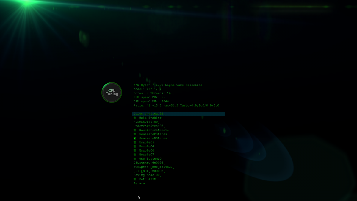

Bronya Posted July 16, 2017 Share Posted July 16, 2017 Finally Clover , Min/Max Ratio for ALL AMD and RYZEN )))) Fixed more for all cpu's AMD ! Thank papiercul for test ! Soon release Clover ! 4 Link to comment https://www.insanelymac.com/forum/topic/322433-ryzen/page/3/#findComment-2464306 Share on other sites More sharing options...
gills83 Posted July 16, 2017 Share Posted July 16, 2017 thanks Bronya, works very well 1 Link to comment https://www.insanelymac.com/forum/topic/322433-ryzen/page/3/#findComment-2464307 Share on other sites More sharing options...

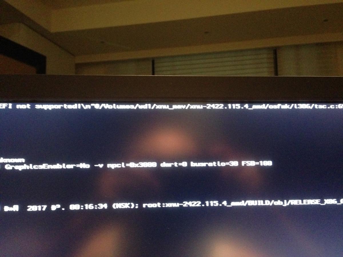

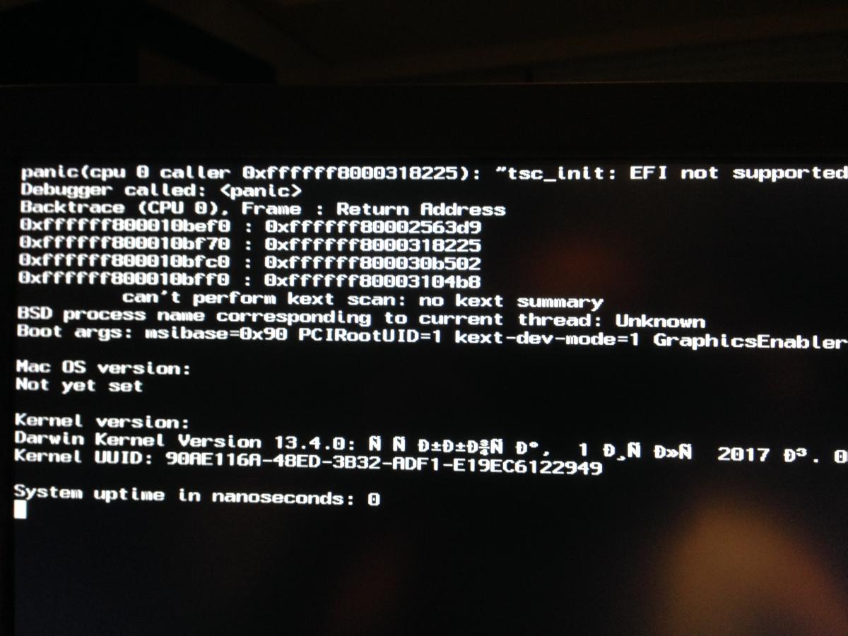

jsl Posted July 17, 2017 Share Posted July 17, 2017 Can anyone with Rayzen do some test on this? Credits to Bronya. Enoch 2890 Ryzen Test --> Enoch_2890_Ryzen_Test.zip ErmaC Thanks for this new boot, but it can not work in my Ryzen 1700X hackintosh. To boot partition at MBR HD it always got blank screen then reboot. To boot partition at GPT it always got KP with error message: unable to load tsc-init at EFI. Link to comment https://www.insanelymac.com/forum/topic/322433-ryzen/page/3/#findComment-2464345 Share on other sites More sharing options...
Bronya Posted July 17, 2017 Share Posted July 17, 2017 Try flag fsb=100 and busratio=... and here answer . Link to comment https://www.insanelymac.com/forum/topic/322433-ryzen/page/3/#findComment-2464394 Share on other sites More sharing options...
jsl Posted July 17, 2017 Share Posted July 17, 2017 Try flag fsb=100 and busratio=... and here answer . Thanks for this instruction which works in Ryzen 1700X hackintosh now. I need set both parameters are correct, otherwise it always got instant reboot or KP as reported before. Looking forward to your new Clover EFI which can boot all AMD CPUs at 10.9.5 to 10.12.x. Link to comment https://www.insanelymac.com/forum/topic/322433-ryzen/page/3/#findComment-2464667 Share on other sites More sharing options...

ErmaC Posted July 17, 2017 Share Posted July 17, 2017 New Enoch for Ryzen Test All the credits go to Bronya, I only compile the version following his suggestion. Enoch 2892 Ryzen Bronya -> removed ErmaC 4 Link to comment https://www.insanelymac.com/forum/topic/322433-ryzen/page/3/#findComment-2464954 Share on other sites More sharing options...

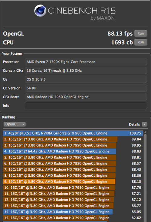

jsl Posted July 17, 2017 Share Posted July 17, 2017 (edited) Please without flag fsb=... It still need this flag fsb=100 without busratio=nn now. Otherwise it will reboot after blank screen. Excellent performance by Cinebench R15 in Ryzen 1700X hackintosh and also fix reboot issue at 10.9.5, 10.11.6, & 10.12.6. But at 10.10.5 it still got interrupted sound output for VoodooHDA 2.8.9 and unable to correctly reboot as before. That means the kernel of 10.10.5 need some patch or optimization. Edited July 18, 2017 by jsl 2 Link to comment https://www.insanelymac.com/forum/topic/322433-ryzen/page/3/#findComment-2464970 Share on other sites More sharing options...

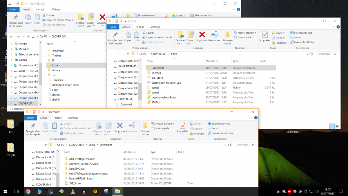

gills83 Posted July 18, 2017 Share Posted July 18, 2017 hi ! I make is chameleon , the supports fractional number . This for test ! And if works , then will make in Enoch ! try boot without flags ! boot_ryzen_new.zip Hello Bronya why ? bootloader fat 32, the kernel in key usb, now flag = Extra/kernel/rd(2,5) -f 2,5 is volume start thanks boot block "system/Libray....." now root: Extra/kernel/rd(2,5)/System/Library/coreservices/boot.efi is good ? ahahahahah !!! Link to comment https://www.insanelymac.com/forum/topic/322433-ryzen/page/3/#findComment-2465444 Share on other sites More sharing options...
