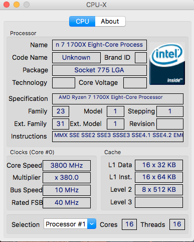

Thanks for this rc3 boot file which still got wrong parameter if BIOS is AUTO (1st photo).
Hi !
Thank for test !
I is have fx ! Also wrong parameter !
But this correctly ! Because FX only chooses independently !
If load Win and run CPU-Z , also wrong show if in bios is auto !
Need install MANUAL Multiplier !

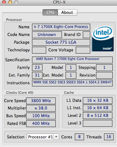

Thanks for this new Enoch_2893_Bronya bootloader which can boot to desktop without flag of "-f" at 10.12.6 & 10.11.6 for FX-6300 hackintosh.
But in Ryzen 1700X hackintosh it still need flag of "fsb=100" to boot and cpu-x showed different values of Bus Speed, Rated FSB & Multiplier
Can it be fixed ? Or it's a bug of cpu-x because console showed the correct values at 10.9.5 ?

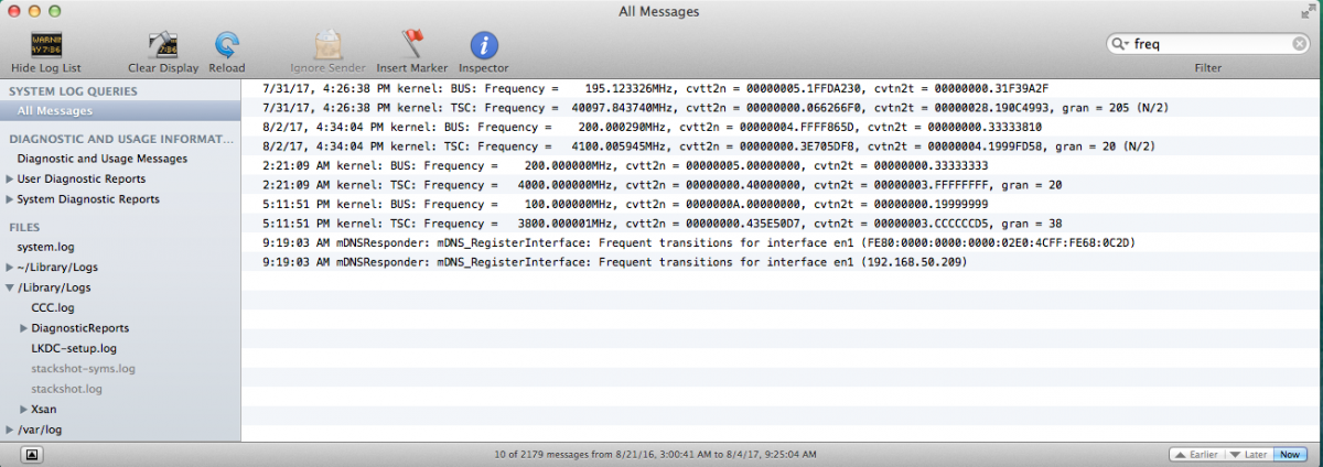

Hi !
Yes , on my FX with this  Enoch_2893_Bronya.zip i gets also wrong fsb ... without flag fsb=... not works and get panic tsc_init ...
Need fix Enoch_2893 ...

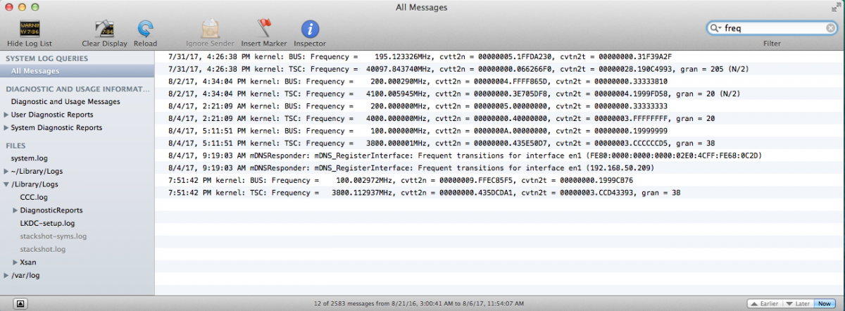

Thanks for this Enoch_2893_Bronya_Fix boot.
At 10.11.6 it can boot to desktop without flag of "fsb=200" in FX-6300 hackintosh.
At 10.12GM, 10.12.4 or 10.12.6 it still need flag of "fsb=200" in FX-6300 hackintosh, if without this flag it always got trap ip errors which was showing too fast to be identified by vision.
In Ryzen 1700X hackintosh it can boot to desktop without flag of "fsb=100" at 10.9.5, 10.10.5, & 10.12.6.
Both cpu-x and console showed the correct values.
But at 10.11.6 it need both flags of "fsb=100" and "busratio=38" to boot correctly.
