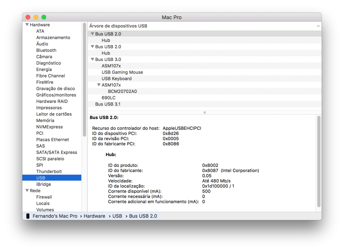

Attached my ioreg dump.
Post your clover folder.
Here ;)
Let's try this and see if this works... (I doubt it'll work, but worth a shot). Post an IOReg when you've loaded it up.
Also, I redid your GPU injection because the old way is just... yeah... no.

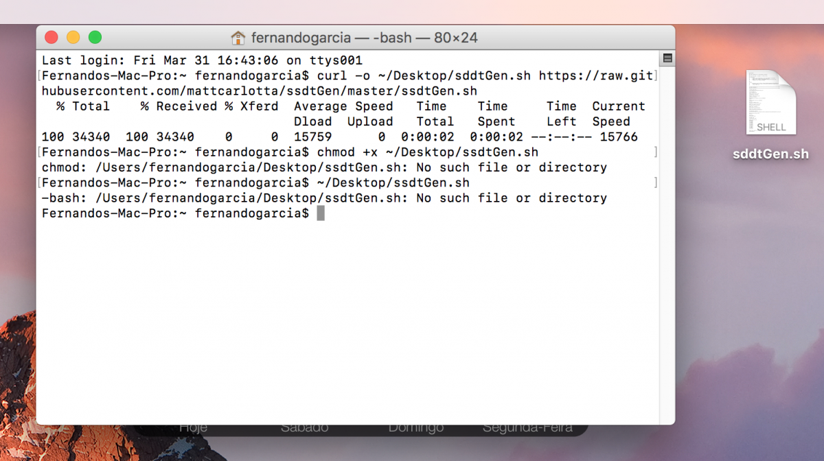

Also... I highly recommend you run my ssdtGen tool (if you do, then remove dsdt.aml + ssdt-gfx1.aml -- the other ssdts can stay in there)
I think I messed up on the Thunderbolt SSDT. Try the SSDT inside SSDT-BR1B.aml.zip if the one I've provided in the "patched.zip" doesn't work...
ssdtGen updated to 0.0.4beta
ssdtGen changelog 0.0.4b:
✓ Unfound device properties no longer kill entire script
✓ Added and trimmed down user choice commands (see below)
✓ Updated help instructions to reflect new commands
0.0.4 Script Commands:
-ba (will attempt to build all SSDTs)
-b NAME (will attempt to build a single SSDT)
-d (will attempt to build all SSDTS while generating a debug_output.txt file)
-h (will display help instructions)
-e (will exit the script)
Should be good for awhile... unless someone finds something script breaking.

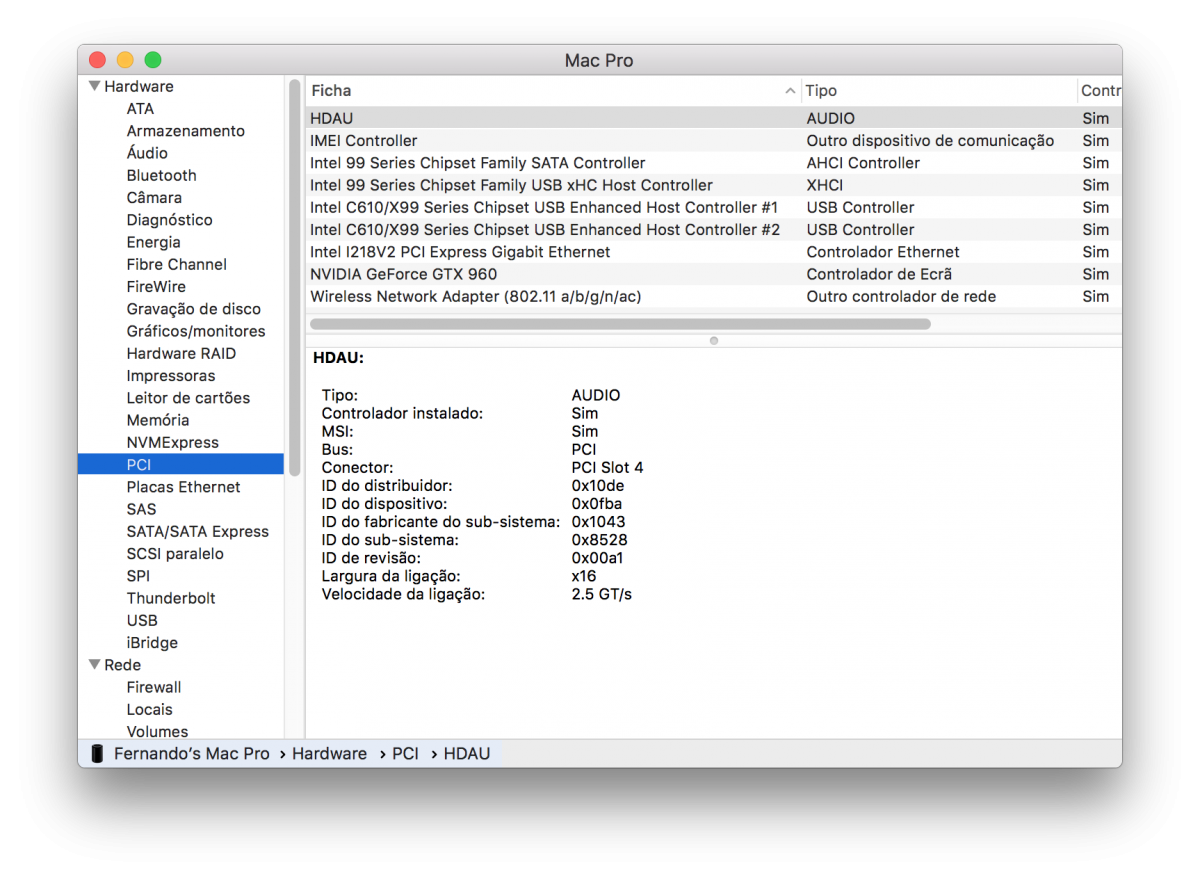

Hello.
Your GFX injection not work. Black screen. So i use my old one, works fine for me. The Thunderbolt SSDT is not working. Uploading a ioreg later :)
Hello.
Hmmm, strange. The GPU injection should have worked. I'll have to see your IOReg.
In the meantime, I've done some edits. Try the attached GFX1.aml below first, and if that doesn't work, then try attached BR3A.aml below (test each with the DSDT.aml from "patched.zip").
SSDT-BR3A.aml.zip
SSDT-GFX1.aml.zip

Wasn't your fault. Looks like there's something funky going on with "curl -o" and saving it to the desktop.
Here's a fix...
You can download the latest version of ssdtGen to your Desktop by entering the following command in a terminal window:
cd ~/Desktop && curl -O -L https://raw.githubusercontent.com/mattcarlotta/ssdtGen/master/ssdtGen.sh
You can then verify the downloaded size (should be about 34kb):
wc -c ssdtGen.sh
You must change the file permissions to make it executable:
chmod +x ssdtGen.sh
Lastly, use this command to run the script:
~/Desktop/ssdtGen.sh
