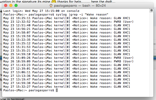

WaldMeister Posted May 27, 2015 Share Posted May 27, 2015 The intel 9 series usb patch from palms repo was applied? It does not differ from the 7/8 series patch, so i applied the usb3.0 multiplex patch. Don't know if it is an USB issue, but worth a try. Can you also type in terminal: syslog |grep -i "Wake reason" DSDT.aml.zip 1 Link to comment Share on other sites More sharing options...
Paologas91 Posted May 27, 2015 Author Share Posted May 27, 2015 The intel 9 series usb patch from palms repo was applied? It does not differ from the 7/8 series patch, so i applied the usb3.0 multiplex patch. Don't know if it is an USB issue, but worth a try. Can you also type in terminal: syslog |grep -i "Wake reason" this is the output... Link to comment Share on other sites More sharing options...

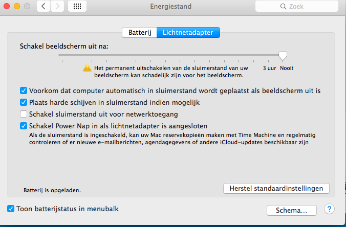

WaldMeister Posted May 27, 2015 Share Posted May 27, 2015 Under power management disable the option about network access. Netwerktoegang = Network Access. About the USB, might be causing the issue, let me know if the DSDT solves the issue. 1 Link to comment Share on other sites More sharing options...

Paologas91 Posted May 27, 2015 Author Share Posted May 27, 2015 Did not work for me in the past, in my own DSDT i used the patch from RehabMan's repo: Name (_PRW, Package (0x02) // _PRW: Power Resources for Wake { 0x6D, 0x03 }) Changed from the standard 0x09, 0x04. Might just be that just disabling the Network thing solves it. i tried disabling the network option but it has no effect.....still having problem... EDIT: I found this link where a guy has my problem and fixed it......what do u think? http://olarila.com/forum/viewtopic.php?f=31&t=4065 Link to comment Share on other sites More sharing options...

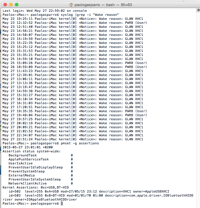

WaldMeister Posted May 27, 2015 Share Posted May 27, 2015 Well, the DSDT has been edited multiple times, the Network option has been disabled, could you do another: syslog |grep -i "Wake reason" And also: pmset -g assertions Link to comment Share on other sites More sharing options...
Paologas91 Posted May 27, 2015 Author Share Posted May 27, 2015 Well, the DSDT has been edited multiple times, the Network option has been disabled, could you do another: syslog |grep -i "Wake reason" And also: pmset -g assertions it tells GLAN but i only left-click mouse to wake the system (the first sleep) Link to comment Share on other sites More sharing options...

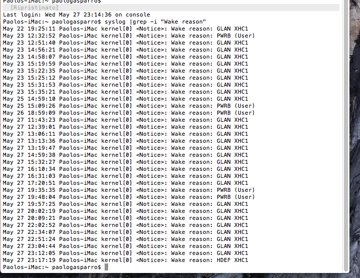

WaldMeister Posted May 27, 2015 Share Posted May 27, 2015 _PWR also removed from GLAN. DSDT-3.aml 2.zip Link to comment Share on other sites More sharing options...
Paologas91 Posted May 27, 2015 Author Share Posted May 27, 2015 _PWR also removed from GLAN. still not working but now with the last dsdt the result of syslog |grep -i "Wake reason" has changed as u see in screenshot (HDEF) Link to comment Share on other sites More sharing options...
