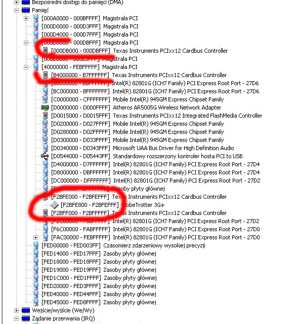

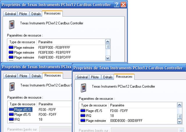

patouman Posted February 6, 2007 Share Posted February 6, 2007 hi, i have question and problem....! 1) why the memory range are different between Windows (see joined jpg /4 memory range) and ubuntu with lspci..(under /2 memory range).. 07:06.0 CardBus bridge: Texas Instruments Unknown device 8039 Subsystem: Toshiba America Info Systems Unknown device ff10 Flags: bus master, medium devsel, latency 168, IRQ 185 Memory at de007000 (32-bit, non-prefetchable) Bus: primary=07, secondary=08, subordinate=0b, sec-latency=176 Memory window 0: 50000000-51fff000 (prefetchable) Memory window 1: 52000000-53fff000 -----> I/O window 0: 00004400-000044ff -----> I/O window 1: 00004800-000048ff 16-bit legacy interface ports at 0001 2) when i put the glichman kext, edit the plist file (ADP 2,1; with 4 memory range !) , put the kext, correct security, etc.... - Sometimes kext seems to load and said "FFFFFFF unknown error", checks your setting - sometimes kext seems to load, say "Texas Instrument PCIxx12 rev 00" and system HANG !!! Does someone have an idea ? is there a difference between the past of the computer; Reboot, On, Off, XP, etc...or something else 3) which i have to follow Win or Linux ? why it is so strange ? Thank's in advance... Link to comment Share on other sites More sharing options...

patouman Posted February 11, 2007 Share Posted February 11, 2007 hi... does someone have an idea...? Probono, do you have an idea too..? Do i make a (or several) mistake(s) ? where...? Why sometimes it's seem to load and the compter HANG and sometimes it doesn't load and the computer works... please see my previous post (5 post before...Posted Feb 6 2007, 10:39 PM) In my previous post i made a mistake about ADRESS. i put some "------>" on bad ligne, (IO Adress) but i was talking about Memory windows... Please give me a way to follow or an idea... Toshiba A100-386 Link to comment Share on other sites More sharing options...

r5a Posted March 1, 2007 Share Posted March 1, 2007 Can someone help me out with this? I am trying to get this working with my HP Pavilion dv8230ca notebook running the 10.4.8 - 8.8.1 kernel from the JaS Install DVD. Name: Texas Instruments PCIxx12 Cardbus Controller Device ID: PCI\VEN_104C&DEV_8039&SUBSYS_30A5103C&REV_00\4&2EC23395&0&30F0 my memory ranges from XP look like this: D2004000-02004FFF F2BFF000-F2BFFFFF DC000000-DFFFFFFF Then I have TWO IO ranges: FE00-FEFF FD00-FDFF Then one more memory range 000DF000-000DFFFF I have already put in glitchman's extensions, I just don't know how to edit this last file. Thanks! Link to comment Share on other sites More sharing options...

r5a Posted March 6, 2007 Share Posted March 6, 2007 Okay so after using property list editor to edit the .kext to add in my memory ranges and IO values from XP. I get this on boot. IOPCCard notice: AdjustResourceInfo: Bad size Anyone know what this means? Link to comment Share on other sites More sharing options...
