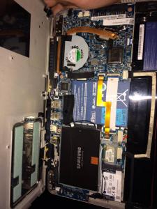

Acer Aspire S3-391 Specifcations
Project closed left with:
  • Sleep function, it only works running on batteries;
  • The brightness key fn+arrow keys not working;

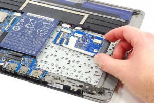

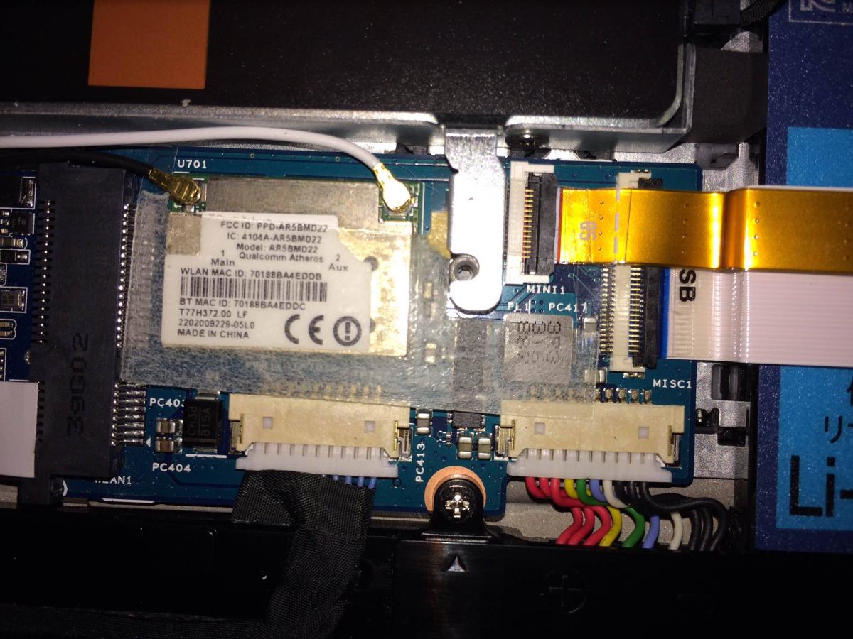

There are two kind of setups with different daughterboards for this notebook (the daughterboard on the Acer s3-391 is a extra board next to the mainboard for controlling msata and/or wifi).
  • Setup 1. Daughterboard with mini-pcie (with mini wifi card).
  • Setup 2. Daughterboard with MSATA and soldered shared Atheros wifi+bluetooth.
As OS X doesn't support the soldered Atheros wifi you have two options.
  • Option 1. You can buy the cards online and swap them, i'm still figuring out what the matching part numbers are (i did removed my MSATA 20GB SSD already before starting with triple boot)..

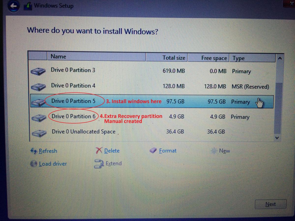

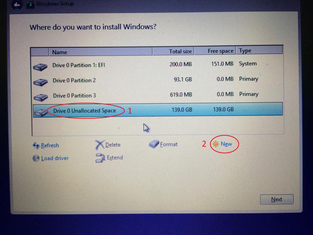

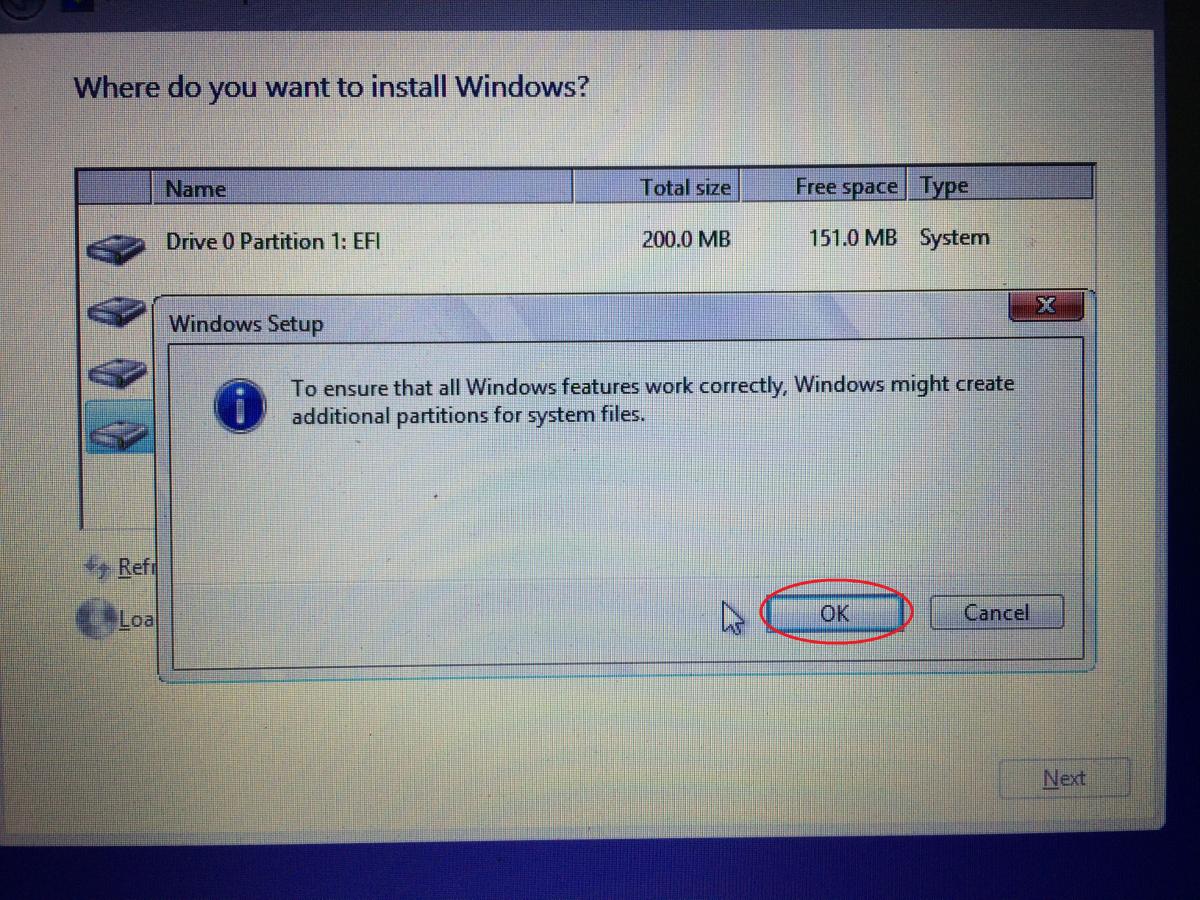

Windows USB Installer
You can only use a x64 dvd/iso, combined x32-x64 versions won't work.
  1. Format your USB-drive to FAT32 using Disk Utility or Windows Disk Management. (MBR or GPT, does'nt mather);
  2. Copy your Windows 8 DVD/ISO contents to the root of this USB-drive.

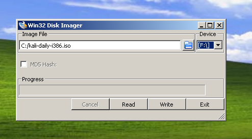

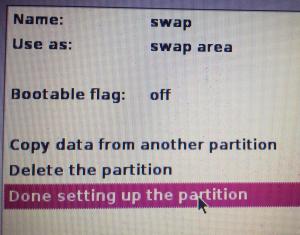

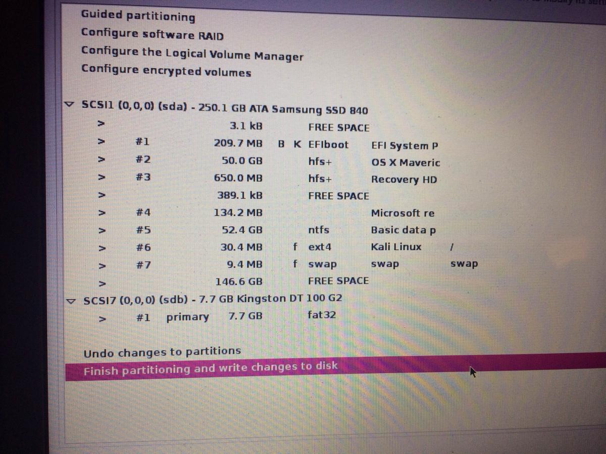

Kali Linux USB Installer
You can only use a x64 dvd/iso.
  1. Format your USB-drive to FAT32 using Disk Utility or Windows Disk Management (MBR or GPT, does'nt mather);
  2. Make sure you use my steps and not other tools, the latest 1.0.8 image of kali linux has a Hybrid *.iso, what means if you mount it in windows you will see mbr installation files. But i you mount it in OS X you will only see the EFI installation files. Anyway neither of that will work. I found out the original guide works perfectly:
  • Place the USB and start Win32 Disk Imager
  • Choose the kali linux image and enable MD5 hash. (this is just a check if the iso you have downloaded is good). Now Write.
  • If the image has been finished, Remove the USB Drive on a safe way from youre Windows machine. You can now use the usb as a installer for UEFI.

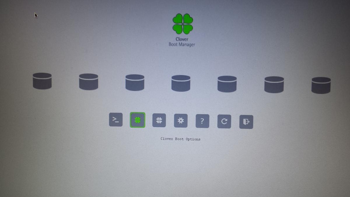

  • Boot from you're Clover usb;
  • In the Clover bootloader, select "Boot OS X Install from Install OS X Mavericks", The installer should work now/continue; (for acer s3 you might need to hit spacebar and use without cache with injected kext).

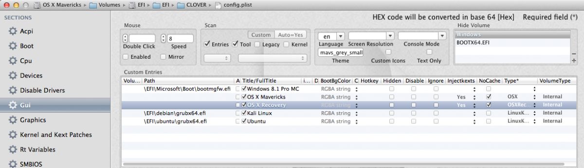

Themes
  1. Copy theme files to you're main /EFI/Clover/themes folder (i got three nice themes in the mavs_themes.zip, provided in the first post);
  2. Open Clover Configurator;
  3. Open you're main EFI/Clover/config.plist;
  4. Go to the GUI tab;
  5. Set the name of the theme here;
  6. Save the config.plist.

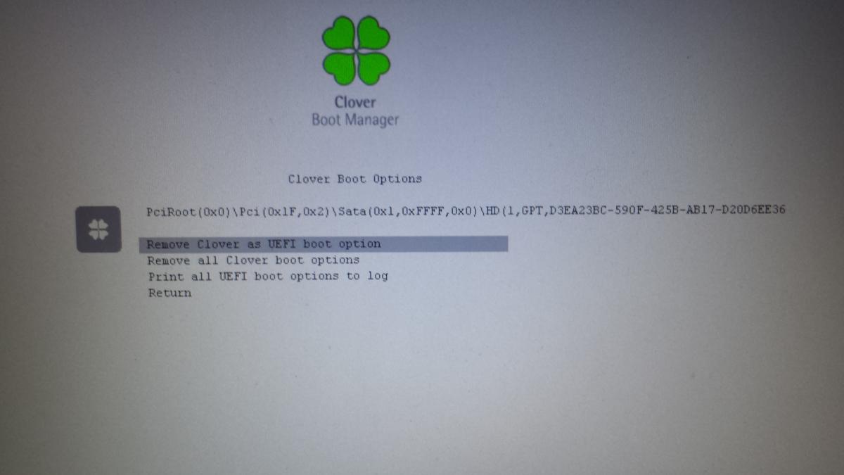

OS X should now be able to boot from the hdd/sdd without the usb. If you do not see the clover on you're hdd/ssd, boot to the clover boot menu with youre usb installer, you will see two option boxes bellow. Hit space bar on on of it.
If you look again youll see \Sata in there or \USB. You need the one with \SATA or maybe you have \IDE
Like you would know by know is that you need to select and use Add Clover as UEFI boot option.

Installing Windows 8.1 UEFI Mode
Boot the Windows 8 usb installer
Once in the setup it's almost straight forward:
post-688682-0-30650900-1385984243_thumb.jpgpost-688682-0-48442600-1385984248_thumb.jpgpost-688682-0-36331800-1385985978_thumb.jpg
1. Select unallocated space
2. Click "New", and choose partition size for windows (keep in mind you need to keep 5Gb for manual Recovery partition, and more for all extra operating systems you wanne install. You will see that windows need to add extra partitions, click "OK" to continue.
4. Again, click unallocated space and create a Recovery partition (5GB). (Only if windows didn't create it automaticly, otherwise skip this step) (i never used it, cause i image my notebook)
5. Now select youre first Primary partition after the MSR (Reserved) and click "Next" to install windows.
Be aware! READ this post till the end before continuing.
The computer can start Windows automaticly without giving you an option to boot OS X from Clover. Read the next post to fix this.
Finish the recovery partition and make it active (Only if windows didn't created it automaticly) again, im not using this im just making a disk image if all is setup correct.

Fix Clover bootloader to dual boot OS X Mavericks / Windows 8.1 from ssd/hdd
First Part:
Really easy, go to youre BIOS and go to the Boot tab. Find UEFI Hard Disk Drive BBS options or something simulair to what i have.
Then set Clover as primairy. Like we did in post #6.
That should be it. Confirm working, If you do not have a option to change it in bios then you should use the second part of this post.
Second part:
Optional, if the first part didn't work for you then proberly you uefi firmware is badly written by youre manufacter. Some times you need the next steps to succesfully boot into clover.
Like a year ago with my old clover we had to use these following steps. Prpbery cause of old Clover back then. So if its booting straiglty to Windows instead of Clover and the first part didnt fixed it, then read this.
  1. Boot from the OS X Clover usb again. (If you cant boot from usb and it goes to windows automaticly, just reset youre pc, as soon as it shows bios loading, reset it again, and then select usb as boot device)
  2. Mount the main EFI with Clover configurator;
  3. Open the main EFI file drive on the desktop, browse to EFI/Clover and copy CLOVERX64.efi  to /EFI/Mircosoft/Boot.
  4. In EFI/Microsoft/Boot rename the file bootmgrfw.efi to bootmgfw-orig.efi
  5. In EFI/Microsoft/Boot rename the file CLOVERX64.EFI to bootmgfw.efi
  6. Reboot without the Clover USB
Clover entrie for Windows
Now you should have a working Dual boot OS X Mavericks and Windows 8.1 from the interal Clover EFI partition.

Boot from youre Kali installer USB, try to boot Kali Non persisent Mode, and confirm it works. If it fails to load you need to debug youre neccesairly boot drivers or try backtrack instead that it based on ubuntu.

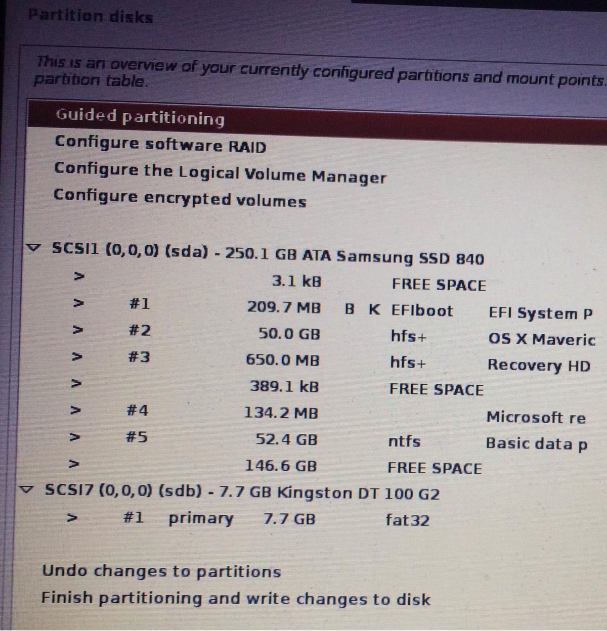

  3. While at step Partition Disk do the next thing choose "manuel" and you should see this: (the picture doesnt show the Recovery HDD of Microsoft, but your'e system will have it and show it when you followed this guide.

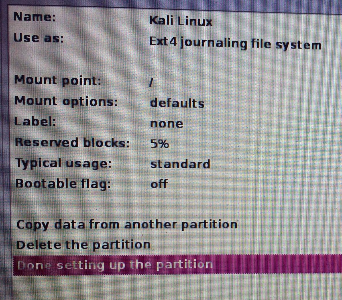

  4. Double click on the "FREE SPACE" partition
  5. Create a new partition --> choose any size for Kali (Kali use at least 10GB)
  6. "Beginning"
  7. Make the setup simular to this picture
  8. "Done setting up the partition"
  9. Double click "FREE SPACE" again

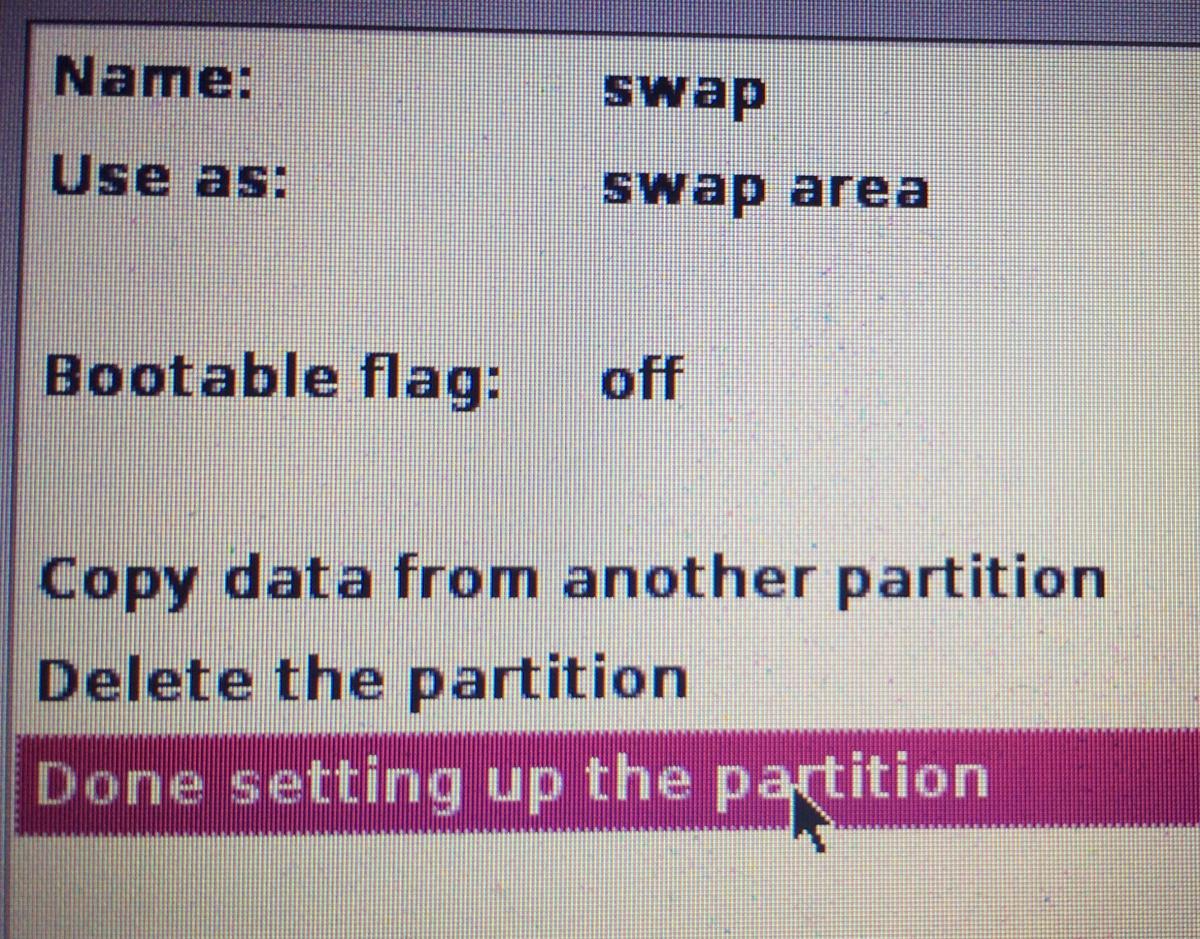

  10. "Create a new partition"
  11. Double amount of internal memory (i have 4GB internal memory, so i use 8GB)
  12. "Beginning"
  13. Again make the setup simulair to the next picture
  15. "Done setting up the partition"
  16. If you did right you now see this:
  17. "Finish partition and write changes to disk""Yes"
  18. Let setup install

Some times you have to add debian manually to Clover. Use my preview below. Take a look at the /EFI/debian/grubx64.efi, for ubuntu its /EFI/ubuntu/grubx64.efi, simple.
Start Clover Configurator then choose -->File --> Open /EFI/Clover/config.plst
