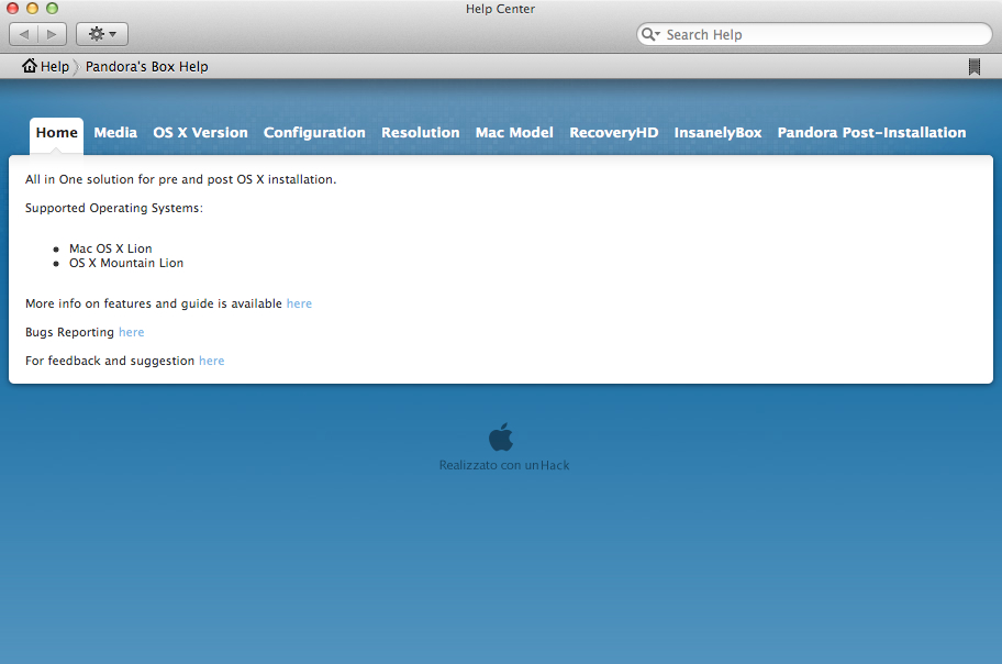

The App has the new Info Window, Help section, Preferences Window and the menu is localized in 9 language. We have implemented the Sparkle Framework to auto update the App at the latest version.
Help Window
For the off-line help we have implemented a solution that can help you to choose the correct options for the customizations.

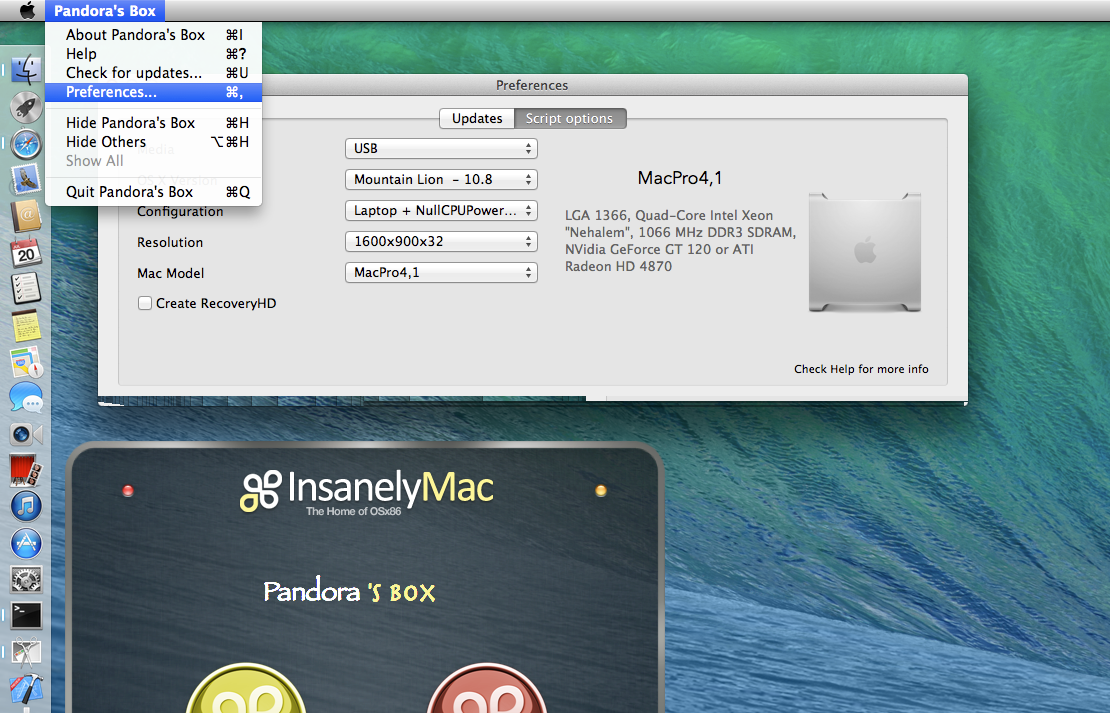

Preferences Window

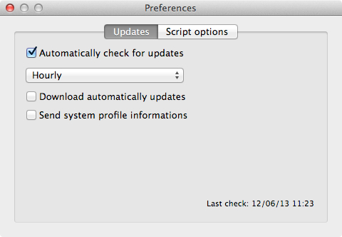

In the first tab there are the options for the Updates side. You can choose:
  • Automatically check for updates - The App check automatically for updates with an interval chosen in the select-box above
  • Download automatically updates
  • Send system profile informations - This send us your App usage. At moment we not receive the infos and you can check or not check. It's not different.

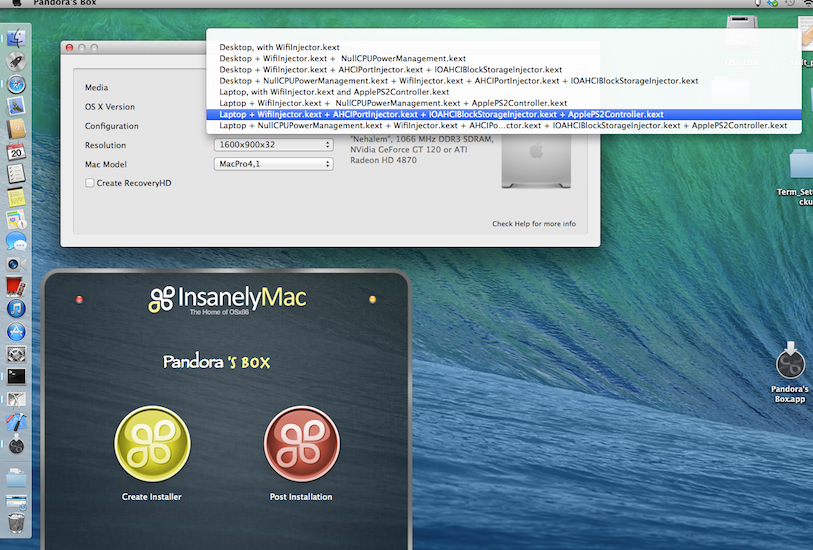

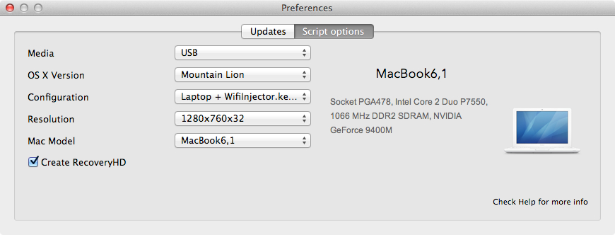

In the second tab there are the options for the Script side. Here you can choose:
  • Media - The support where the script create the image.
  • OS X Version - The version of the system to be restored on the media chosen above.
  • Configuration - Here you can choose the configuration of the system. (If you have an i3-5-7 choose an option with NullCPUPowerManagement)
  • Resolution - Resolution for boot loader and, if you boot with -x option and your video card is not supported by the system, is the main resolution in OS while running.
  • Mac Model - The model that match with your computer.
  • Create RecoveryHD - This option create the RecoveryHD with the BaseSystem of you DMG
All the select-box have an empty option at first place, select it to choose in the script execution the option. The "Create RecoveryHD" must have a "-". The preferences is stored separately for each user. If you change computer (or if you use the App for the first time) you must re-select the options.

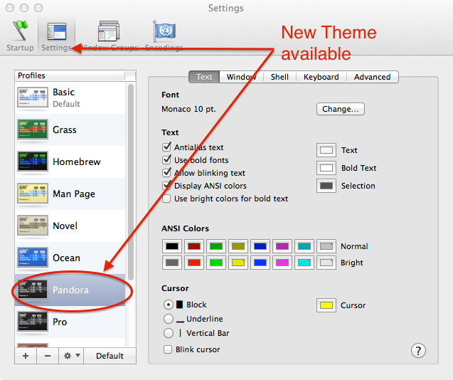

This time there is a new method to import the new Thema, specifically for Pandora:

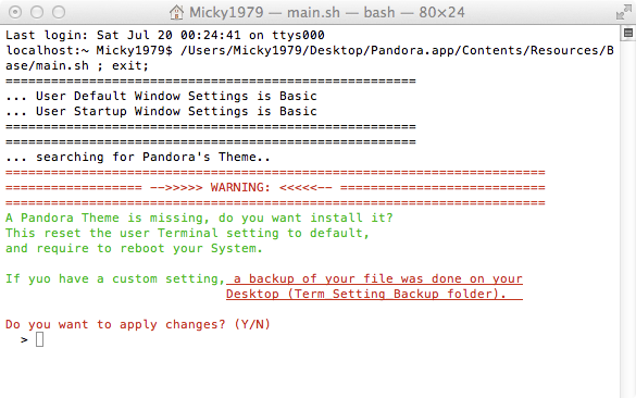

- The first time you launches Pandora to create an Installer (yellow icon), Pandora realize that the thema requested is not present, and will be asked if you want to install it:
as already mentioned, if you accepted, the com.Terminal.plist will be delete, then the Pandora's thema will be copied in the dedicated place, and the system will restart automatically.  At next log-in to OSx this will be the result:

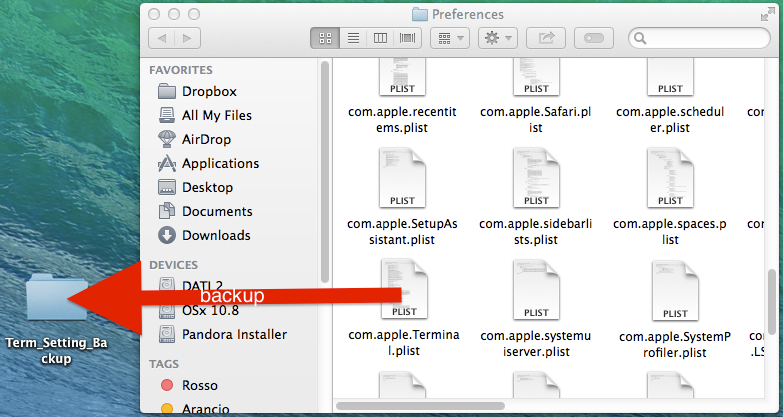

RESTORED TO DEFAULT window "Basic" + Pandora theme suitable now for Pandora.app
a backup of the old configuration will be done on your Desktop in a folder called Term_Setting_Backup.
If you have not made ​​any changes, or yes, the settings will now be the same as those of a clean installation.
(This theme can always be used by you, if you like it, setting it as the default in the Terminal Preferences)

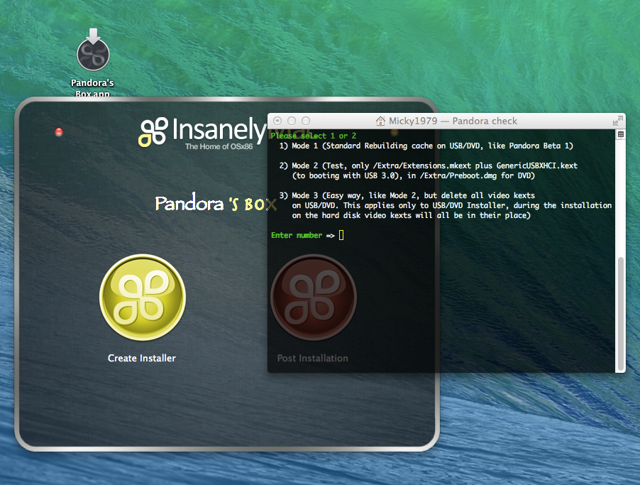

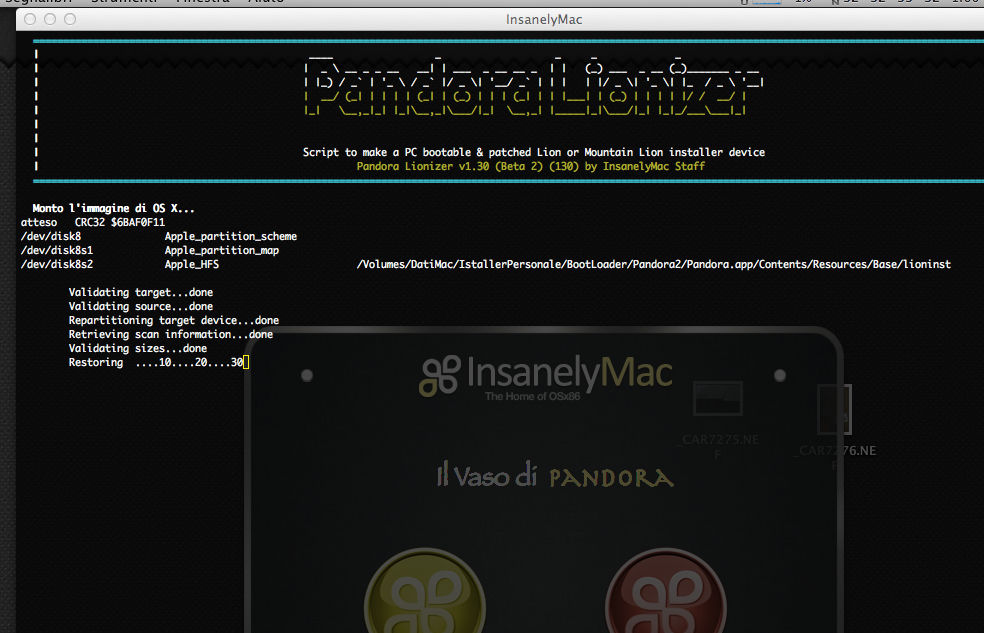

OK, now Pandora is ready, and you can press rounded yellow icon, and Pandora will put you in front of 3 difference choices, for 3 different modes of use, to create your USB/DVD media installation:

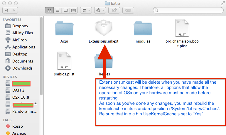

- Mode 1) the kernel cache is rebuilded in a standard position for USB media (/System/Library/Caches/.. etc, as was the case for Pandora Beta 1
- Mode 2) the cache is rebuilt in /Extra/Extensions.mkext for USB, and in  into Extra/Preboot.dmg for DVD media.
In addition to the kext that you have been chosen in the Preferences panel:
...a GenericUSBXHCI.kext is added for booting with working USB 3.0 ports!
Note: the kexts we're talking about (you have chosen from the Preferences panel of Pandora + GenericUSBXHCI.kext), will not be copied to the final installation disk, so during installation, all you needed kexts still be selected again from the "InsanelyMac Options" of the Pandora System.
- Mode 3) Same behavior as Mode 2, but here Pandora erases all video kexts:
this might be useful where there are graphics problems while starting OSx like with black screen, forcing OSx to use  the standard VESA driver. There will be no graphic acceleration, but it's really easy to get OSX GUI (Installer screen) to proceed with normal installation....
Mode 3 Recommended for those who are not expert: graphics can be arranged later.
WARNING
In the picture below, you can see that Mode 2 and Mode 3, use Extra/Extensions.mkext to start the OSx Installer:
when you start installer and the installation has been near to be completed, Extensions.mkext will be deleted automatically and after rebuilt again, but only with the kexts that have been chosen among the "InsanelyMac Options", and present at that time in /System/Library/Extensions/
remember to select, during installation, all the kexts or patches you need,  or even to eliminate again, for example, the video kexts.

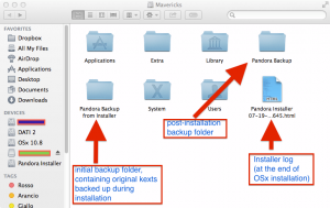

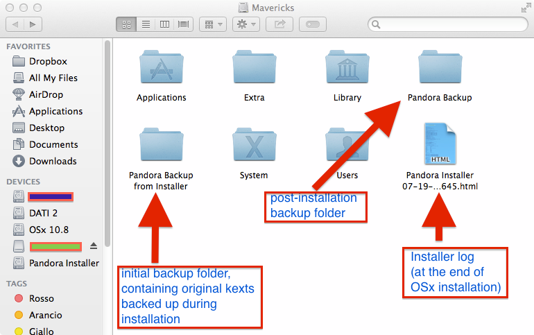

As in previous versions, html log is created in the root of the disk at the end of OSX installation and all the details are available here: very important for us!
As you can see from the picture:
you can see the backup folders, one called "Pandora Backup from Installer" containing the modified kexts during OSx installation, another called simply "Pandora Backup" that contains the backed up kexts that are changed during the  post-installation sessions: for each session a sub folder (with date and time) is created, so you always know what has been done chronologically.
So another HTML log is created on your desktop at the end of post-installation session:

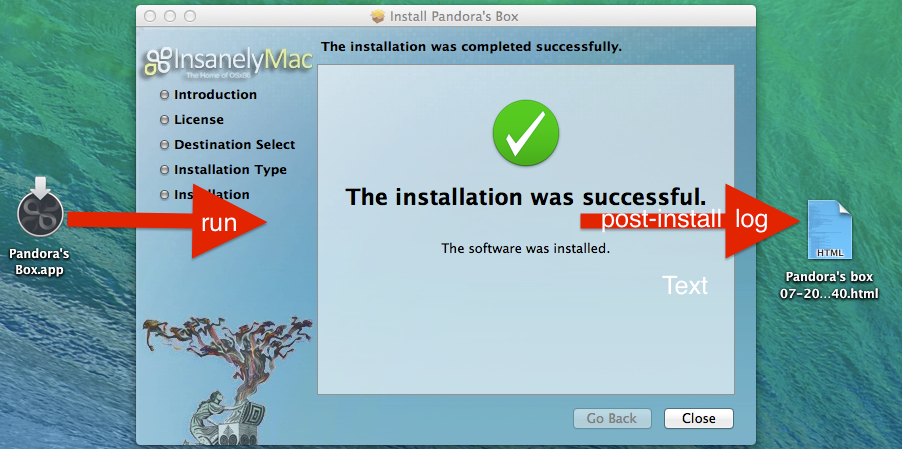

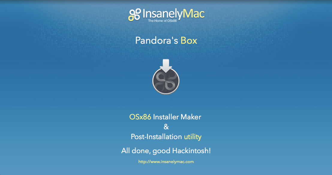

At the end of Pandora Installer Maker process:
If all goes well you can see this on your browser:

Similar, but now Pandora has a Preferences panel, which you can reach from the top bar:
If you do not select any option, Pandora will work as before (so no need for another Tutorial). If you add your options, however, will not be asked during the process!

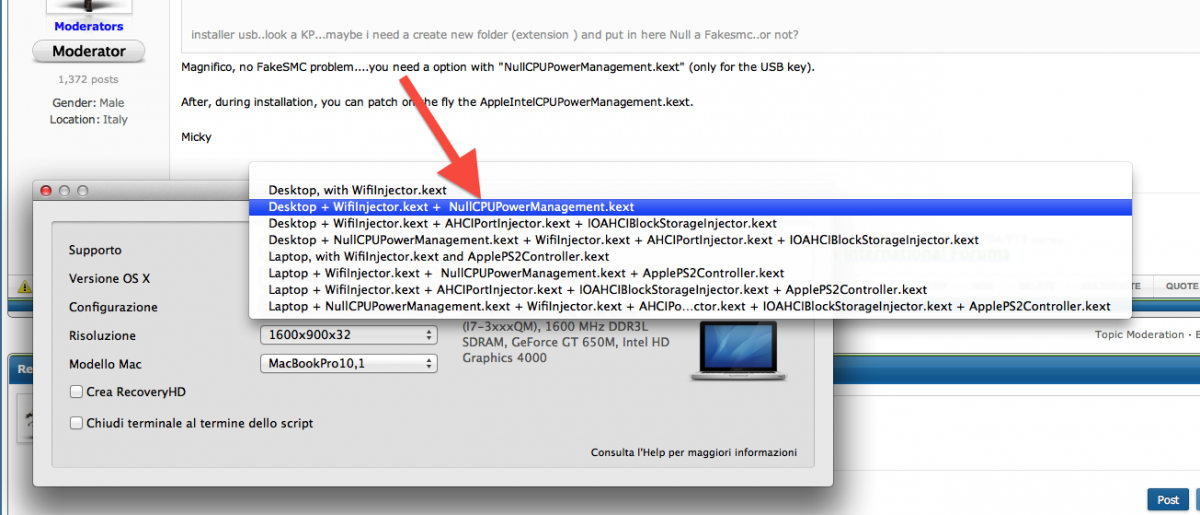

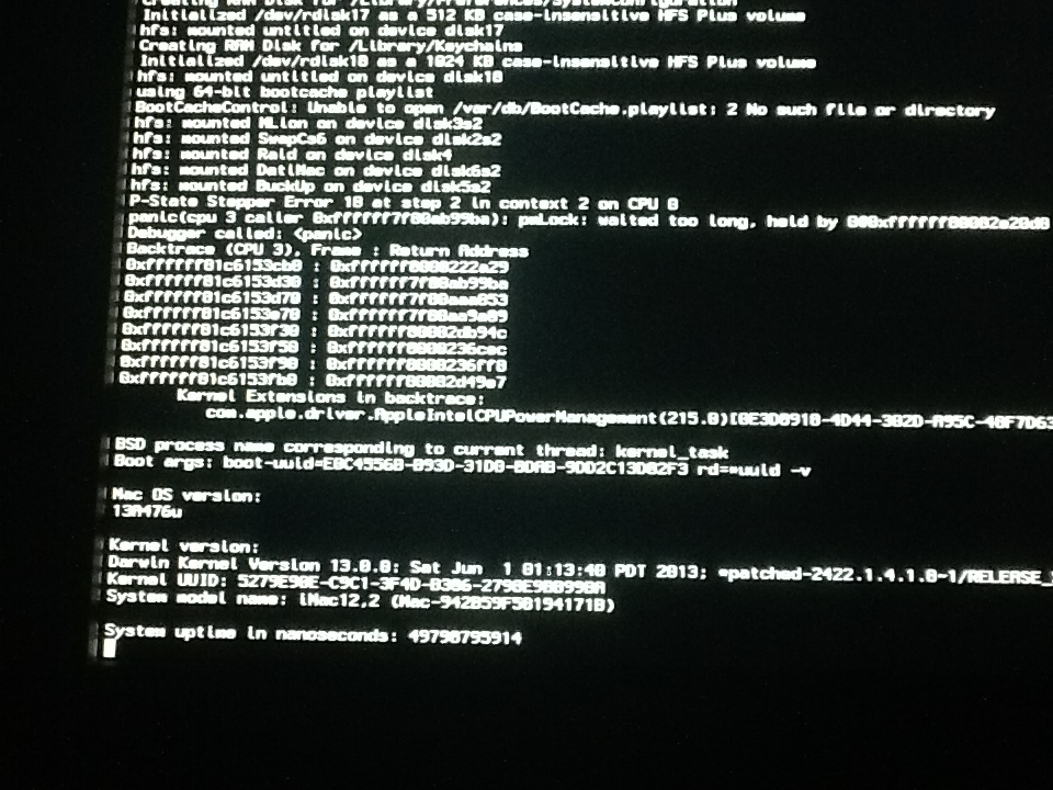

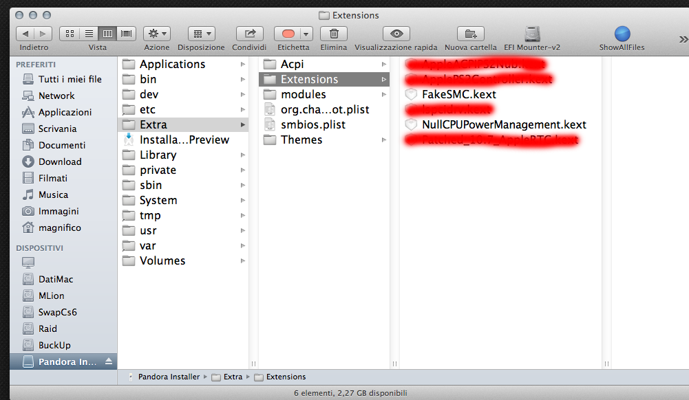

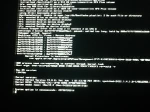

Mike listen me..have KP ..mhmm maybe i need a NullCpu , but i dont see Fakesmc
Where?..into new Volume Pandora Installer or DVD Installer?
Micky
installer usb..look a KP...maybe i need a create new folder (extension ) and put in here Null a Fakesmc..or not?
Magnifico, no FakeSMC problem....you need a option with "NullCPUPowerManagement.kext" (only for the USB key):
After, during installation, you can patch on the fly the AppleIntelCPUPowerManagement.kext.

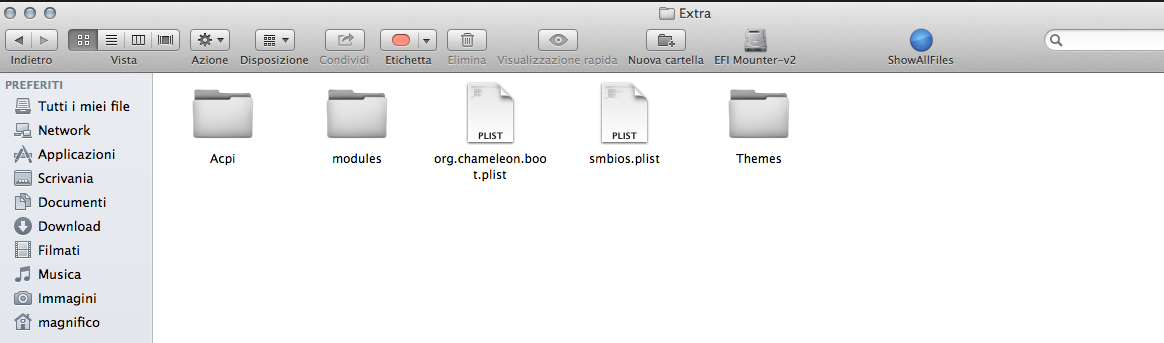

No need for Extra/Extensions folder on Lion, ML or Mavericks, however  the KernelPatcher.dylib (into Extra/modules/), enables the use of it.

I dont see this in my procedure installation ( USB )
But i have put Folder extension in Extra and now work
PS: But where is this option in installer usb ?

See my previous post:
...but really not needed  if you select an option with NullCPUPowerManagement.kext before :)
The problem is that so you will need to remove it at the end of installation manually, otherwise the Speed ​​Step does not work (also the Sleep). Instead, as I told you I (and you  selecti AICPM patch during installation) no problem!
