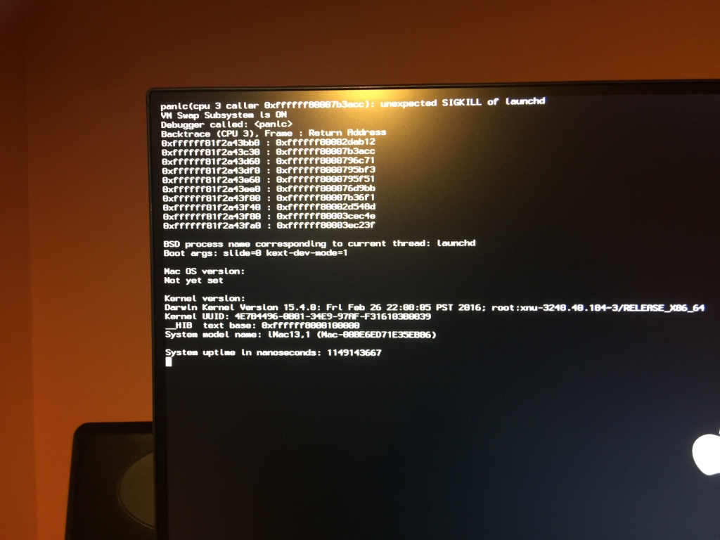

Hi Kynyo,  updated my sig - already on latest BIOS. Thanks for pointing it out.

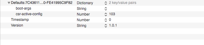

However, with csr-active-config=103 in the Defaults plist it still goes into a reboot loop. I booted into recovery and csrutil status said it was already disabled. I imagine the update has to disable sip to work and would  turn it back on afterwards, so it looks like the defaults plist is doing its stuff.
I'll wait to see if anyone else has problems.
My normal approach has been to make a CCC backup and then install the update. If the update fails, I restore from the backup. However, that produces issues, with VoodooHDA not loading, and other stuff needing to be set up again. So now, I'll get another disk, clone to the disk and update the clone, then if it goes pearshaped I can just revert to the original disk and still have an intact backup if needed.

ok so you are providing a ready-made Defaults.plist with SIP disabled...
Ok SIP must be disabled while upgrading and rebuilding the kext cache after the upgrade..
Does it need to stay disabled afterwards or can it be re-enabled ?
OK. I bit the bullet and cloned the disk and did the update on the clone after disconnecting my main disk. Restart brought the reboot loop as before, although I'm happy that my Defaults.plist is set up correctly. So I restarted while pressing Cmd+OPt+P+R. I got the Oz expanding msgs, then the screen changed colours a few times and then it booted ...... to the EFI shell. Why? Because the HD had disappeared. It's in the map but not in the bcfg boot dump. If I plug in another disk known to boot OK, that doesn't appear either. Is there some way to get the BIOS to rebuild the boot list? I did load defaults in the BIOS.
I had this situation before and by plugging and unplugging disks (with power off) it came back eventually, but I've no idea how or why.
Any suggestions?
