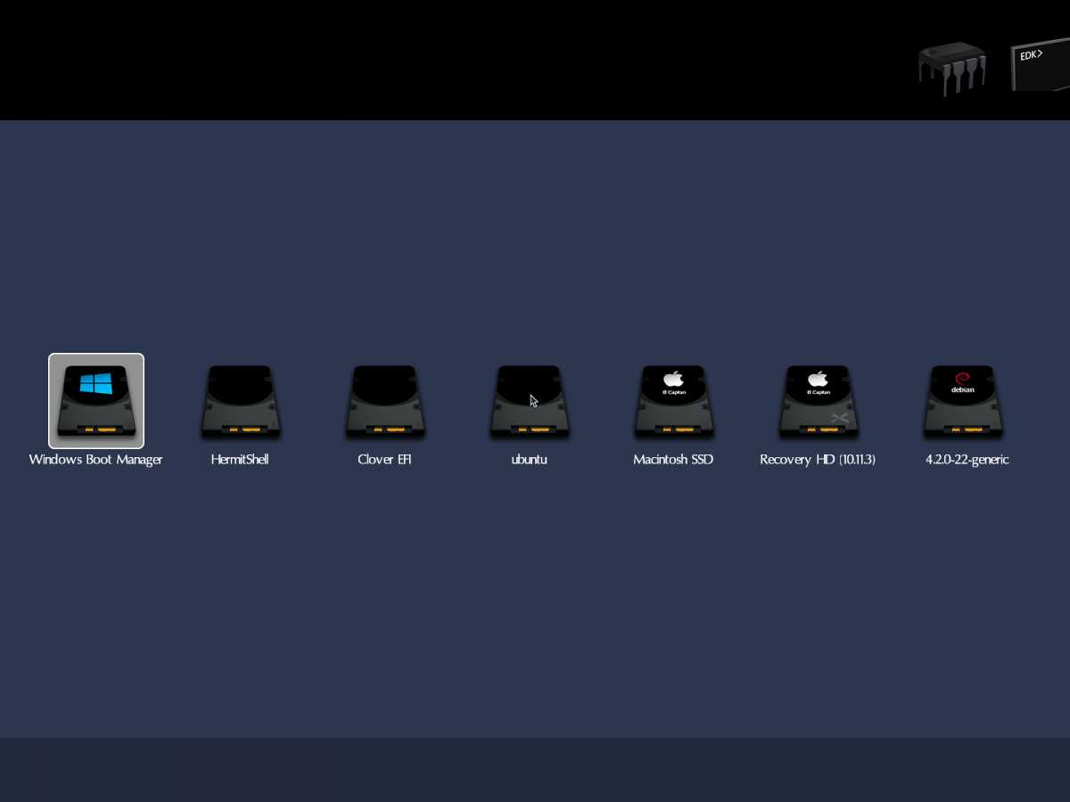

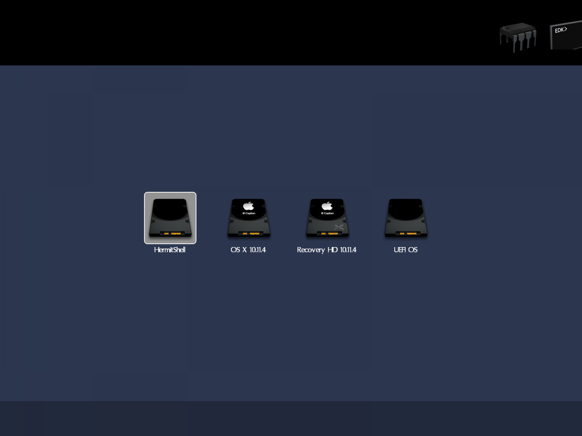

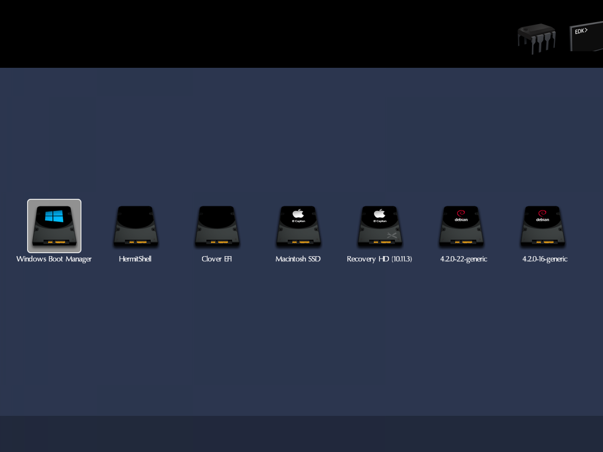

How did you manage to appear HermitShell and Clover UEFI over Oz Boot splash. I can't scced that and I have HermitShell in my bios but it doesen't appear on F12 boot menu even.
How we can custom rename entryes displayed like in those two photos?

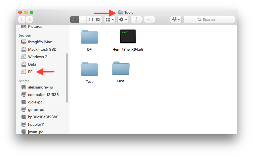

First photos-> press F10 and after boot and mount ESP in Oz folder you have a GUI photos.

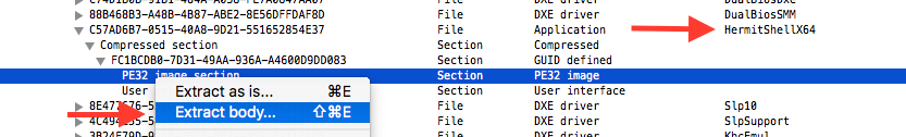

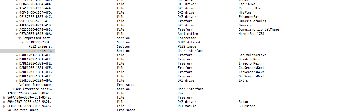

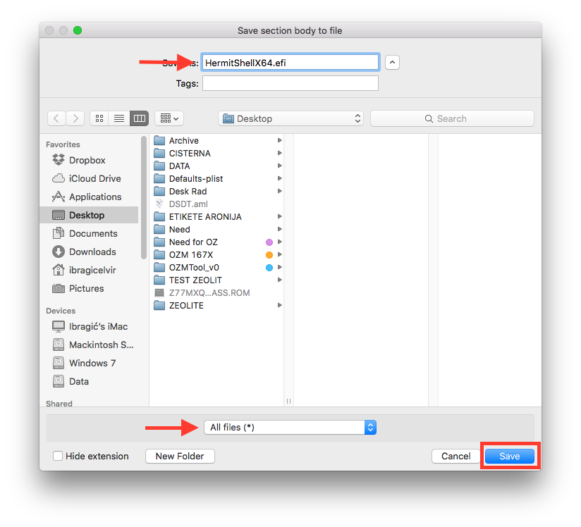

HermitShell- follow pic
first extract hermitshell from Z77MXQUOAOS.H2O.167X-MASS.ROM
Later put hermitshellX64.efi in EFI/Tools
now boot PC with my EFI folder and you going to shell and write like this
bcfg boot add 1 fs0:\EFI\Tools\HermitShellX64.efi "HermitShell"
and press enter.
