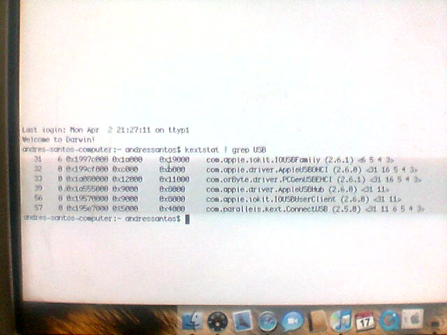

spy_charly Posted April 3, 2007 Share Posted April 3, 2007 Hi I d like to help, but you need to include in your post info on: OSx86 version & Kernel and system mobo. Beyond that the following would help. kextstat | grep USB ioreg -w0 -bl (this is long and is usually attached to the post) dmesg | grep USB advanced users can do kextload <path>PCGenUSBEHCI.kext Also pls. re-read the FAQs in the dmg's. Also pls. note that presently the driver has not been tested on 10.4.9 by myself. So I couldn't verify operation on that platform. Also, what happens when you plug a USB2 device in? Best ok i couldn´t get the other two but this is the first picture my mobo system is a foxconn 661FX7MI-RS my current version is 10.4.8 with kernel 8.8.1 Link to comment Share on other sites More sharing options...
orByte Posted April 3, 2007 Author Share Posted April 3, 2007 ok i couldn´t get the other two but this is the first picture<image> my mobo system is a foxconn 661FX7MI-RS my current version is 10.4.8 with kernel 8.8.1 Hi you can copy & paste from the terminal using edit>copy/paste from the terminal menu. The kext output looks in order. I note that you have parallells running. There is another post in this thread from a user with parallells (if I remember correctly) That might help. If you have trouble executing ioreg, e.g. you do not get the full output, then the problem might be with the SMBIOS kext, and you ll need to get Pauli's? SMBIOS. I wont be in front of my CPU for a few weeks so sorry for the rather sketchy explanations. Also have you tried sudo dmesg? Best. Link to comment Share on other sites More sharing options...

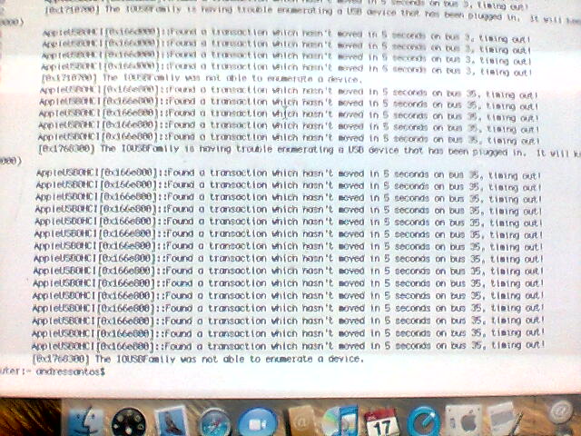

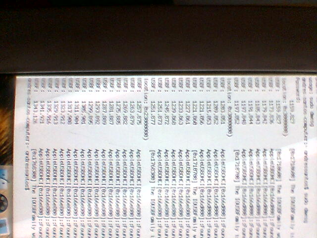

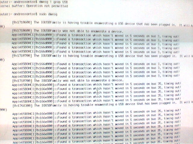

spy_charly Posted April 3, 2007 Share Posted April 3, 2007 hi thnax for your quick replies, yes i tried it returns several errors from the usb something about timing out...hold on a dew minutes i will post them the "ioreg -w0 -bl" returns as u mention a lot of information(hard to get it for me) this is the dmesg | grep USB picture, but it first returned an error, btw sorry for the pictures but i don not have any way to take them out of mac Link to comment Share on other sites More sharing options...
orByte Posted April 4, 2007 Author Share Posted April 4, 2007 the "ioreg -w0 -bl" returns as u mention a lot of information(hard to get it for me) this is the dmesg | grep USB picture, but it first returned an error, btw sorry for the pictures but i don not have any way to take them out of mac <images> Hi sorry I had not realized that you were missing networking. The error you are showing, I suspect that it relates to the sis controller. But it is a USB 1.0 error. (OHCI = USB 1x), (EHCI = USB2). If you run sudo su dmesg | grep EHCI do you get similar timeout errors. In short, I would suspect that this driver wont work for you. But if you have some time to post the above output, esp the EHCI kext driver output as it loads, that would be helpful for looking at how your BIOS treats legacy SMI events. Best Link to comment Share on other sites More sharing options...
spy_charly Posted April 5, 2007 Share Posted April 5, 2007 Hi sorry I had not realized that you were missing networking. The error you are showing, I suspect that it relates to the sis controller. But it is a USB 1.0 error. (OHCI = USB 1x), (EHCI = USB2). If you run sudo su dmesg | grep EHCI do you get similar timeout errors. In short, I would suspect that this driver wont work for you. But if you have some time to post the above output, esp the EHCI kext driver output as it loads, that would be helpful for looking at how your BIOS treats legacy SMI events. Best hi again... nope i do not get any messages of any kind, it just rewites the line of my user for example myuser~root:dmesg | grep EHCI myuser~root: and that's all Link to comment Share on other sites More sharing options...
orByte Posted April 6, 2007 Author Share Posted April 6, 2007 hi again... nope i do not get any messages of any kind, it just rewites the line of my user for example myuser~root:dmesg | grep EHCI myuser~root: and that's all Odd... The kext load could be failing before initialization starts. Best Link to comment Share on other sites More sharing options...
