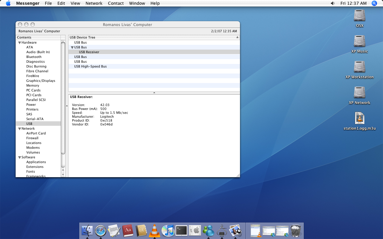

I am using PCGenUSBEHCI-2.6.1a on a Shuttle SN26P (nforce 4) machine because it was having the USB BIOS problem. It fixed everything but one problem remains...
I have a Logitech bluetooth mx-5000 keyboard/mouse which came with a USB/Bluetooth dongle. The dongle is recognized and shows up in the USB section of the System Profiler. The keyboard seems to work, but the mouse doesn't. Strangely, moving the mouse causes the volume settings to go up and down. The sound card is also a USB device - Creative Live! 24 USB.
I have an old Mac PowerPC so I tried the dongle/kb/mouse on it and it all works perfectly with no setup or configuration.
Since the USB did not work at all before your PCGenUSBEHCI driver, I do not know if it would have worked with the original AppleUSBEHCI.
Can anyone suggest a fix or anything which might clarify the problem?

UPDATE!!!
I read in another forum that the logitech contro center drivers do not work on os-x with bluetooth. But it also said that the SteerMouse driver *DO* work. So I installed them and yes, they fixed it!
Found them here:
www.apple.com/downloads/macosx/drivers/steermouse.html
Thanks for a great underlying driver that allowed me to get off the ground.

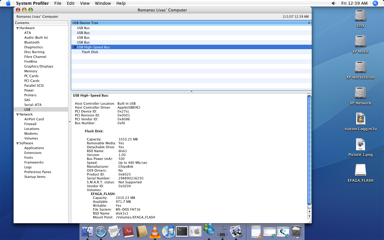

after installing i was unable to use usb disks, found this too
Extension "com.apple.iokit.IOUSBMassStorageClass" has no kernel dependency.

USBF:   15. 78  AppleUSBEHCI[0x1a0f800]::start EHCI controller will be unloaded across sleep
Means the driver has loaded successfully but will be fully unloaded when you sleep the machine. Nothing to worry about. All non-mac hardware is likely to display this message due to the way the usb driver detects power management.
The problem is here
This means that IOUSBMassStorageClass has NOT loaded. So you need to check that it is present in /System/Library/Extensions, and if yes check version and permissions as well. Version info: for 8.4.1-10.4.7/8 use 1.4.2 for 8.1.1/10.4.8 use: 1.4.2 as well. In sum, try version 1.4.2 and repair permissions. And hopefully that will fix the problem.
