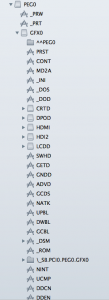

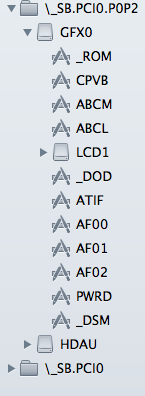

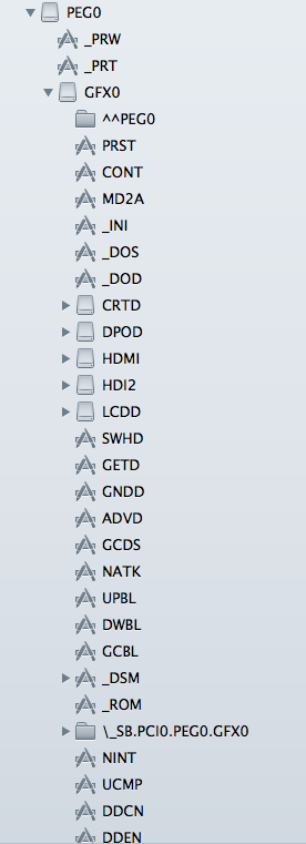

So I linked two files. First one is a dump of my DSDT from Windows, the second one is a dump of my EDID in bin and inf file from EDID with raw data. Hope it'll help.
Thanks for your help.
Maybe we will find what is going on and help other users too.

Sorry for the delay,  try this EFI String it contains your EDID
<ad0900000100000001000000a10900003300000002010c00d041030a000000000101060000010101060000007fff04002e000000400030002c004e005600440041002c0055006e006400650072007300630061006e004d0069006e00000008000000520000002c0000004e005600440041002c0069006e00760061006c00690064002d0063006f006e006600690067000000080000000000000022000000400030002c0064006900730070006c00610079002d00630066006700000008000000030408002e000000400030002c004100410050004c002c0062006f006f0074002d0064006900730070006c006100790000000400000014000000400032002c006e0061006d0065000000120000004e5644412c446973706c61792d43260000005600520041004d002c006d0065006d00760065006e0064006f007200490044000000060000000600180000004100410050004c00300030002c0054003400000008000000c800000028000000400031002c0063006f006e006e006500630074006f0072002d0074007900700065000000080000000004000022000000400031002c006400650076006900630065005f00740079007000650000000b000000646973706c617914000000400030002c006e0061006d0065000000120000004e5644412c446973706c61792d4120000000400032002c0063006f006d00700061007400690062006c00650000000e0000004e5644412c4e564d616314000000400031002c006e0061006d0065000000120000004e5644412c446973706c61792d421c000000400030002c00660062006f00660066007300650074000000080000000000030022000000400032002c0064006900730070006c00610079002d00630066006700000008000000ffffffff160000006200750069006c0074002d0069006e000000050000000020000000400033002c0063006f006d00700061007400690062006c00650000000e0000004e5644412c4e564d61632e000000400032002c004e005600440041002c0055006e006400650072007300630061006e004d0069006e000000080000005200000022000000400033002c006400650076006900630065005f00740079007000650000000b000000646973706c61792a0000004100410050004c00300030002c0044006100740061004a0075007300740069006600790000000800000001000000180000004100410050004c00300030002c0054003300000008000000c800000024000000400031002c00630061006e002d0068006f0074002d0070006c0075006700000004000000180000004100410050004c00300030002c005400370000000800000090010000280000004100410050004c00300030002c004c0069006e006b0046006f0072006d00610074000000080000000000000028000000400032002c0063006f006e006e006500630074006f0072002d0074007900700065000000080000000004000022000000400030002c006400650076006900630065005f00740079007000650000000b000000646973706c6179180000004100410050004c00300030002c00540032000000080000000100000022000000400031002c0064006900730070006c00610079002d00630066006700000008000000ffffffff240000004100410050004c00300030002c004c0069006e006b0054007900700065000000080000000000000022000000400032002c006400650076006900630065005f00740079007000650000000b000000646973706c617928000000400030002c0063006f006e006e006500630074006f0072002d0074007900700065000000080000000204000014000000400030002c00450044004900440000000401000000ffffffffffff004ca3445000000000011601049526157802a0558d515a962a1c5054000000010101010101010101010101010101015f3980dc70384040302035007ed71000001b0000000f0000000000000000003c9610fe00000000fe00474e3336548031373348540a2000000000000041219e0000000002010a202001d10000000000000000000000000000000000000000000000000000000000000000000000000000000000000000000000000000000000000000000000000000000000000000000000000000000000000000000000000000000000000000000000000000000000000000000000000000000000000000000000000000000000000000240000004100410050004c00300030002c004400750061006c004c0069006e006b0000000800000001000000180000004100410050004c00300030002c0054003600000008000000000000002e000000400031002c004e005600440041002c0055006e006400650072007300630061006e004d0069006e00000008000000520000001c0000006400650076006900630065005f00740079007000650000000f0000004e5644412c506172656e74100000006d006f00640065006c0000001b0000004e5649444941204765466f72636520475458203638304d220000005600520041004d002c0074006f00740061006c00730069007a00650000000800000000000080100000004e0056004300410050000000180000000501000000000100060000000000000f00000000180000004100410050004c00300030002c0054003100000008000000000000002a0000004100410050004c00300030002c0050006900780065006c0046006f0072006d00610074000000080000000000000020000000400030002c0063006f006d00700061007400690062006c00650000000e0000004e5644412c4e564d61631c000000400030002c006200750069006c0074002d0069006e00000004000000180000004100410050004c00300030002c00540035000000080000000100000022000000400033002c0064006900730070006c00610079002d00630066006700000008000000ffffffff360000004100410050004c00300030002c0049006e007600650072007400650072004600720065007100750065006e0063007900000008000000000000002e000000400033002c004e005600440041002c0055006e006400650072007300630061006e004d0069006e000000080000005200000014000000400033002c006e0061006d0065000000120000004e5644412c446973706c61792d4420000000400031002c0063006f006d00700061007400690062006c00650000000e0000004e5644412c4e564d6163200000004100410050004c00300030002c004400690074006800650072000000080000000000000028000000400033002c0063006f006e006e006500630074006f0072002d0074007900700065000000080000000008000026000000670072006100700068006900630073002d006f007000740069006f006e0073000000080000000c000000>
I also found this http://forum.noteboo...e-10-print.html  there are reports for the Alienware 680M with 120Hz working maybe this info could hep you
Good Luck
