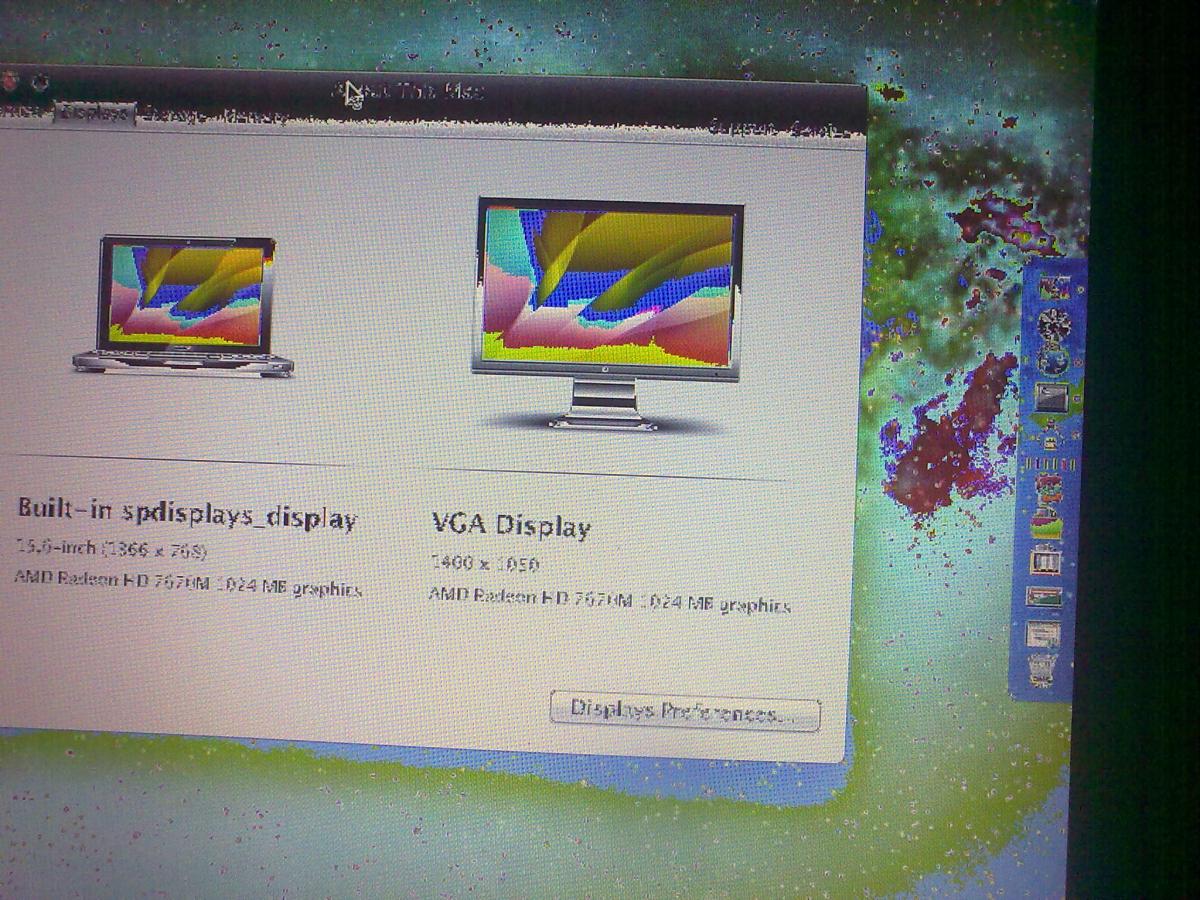

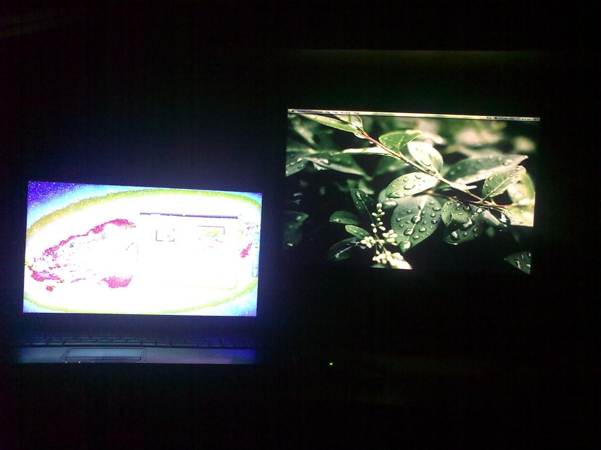

@Trucker MK Progress, at last! Thank you so much! It works but the LVDS has some severe false colouring and colour depth issue, the resolution is not detected on the VGA either

How did it work? With DSDT or ATY_Init? I solved inverted colors by using EDID from other notebook. I used the same EDID which solved it for me in ATY_Init kext. So if you enabled card with ATY_Init, you theoretically shouldn't have had this problem. I am now without OS X and can't see that DSDT from Trucker, but if it has your original EDID, you should replace it with the one I posted a few pages ago. Eventually, it is possible to solve inverted colors problem by using encoder value of 01 instead of 00 in connectors patch and original EDID, but then I have another problem - gradients or reduced color depth.

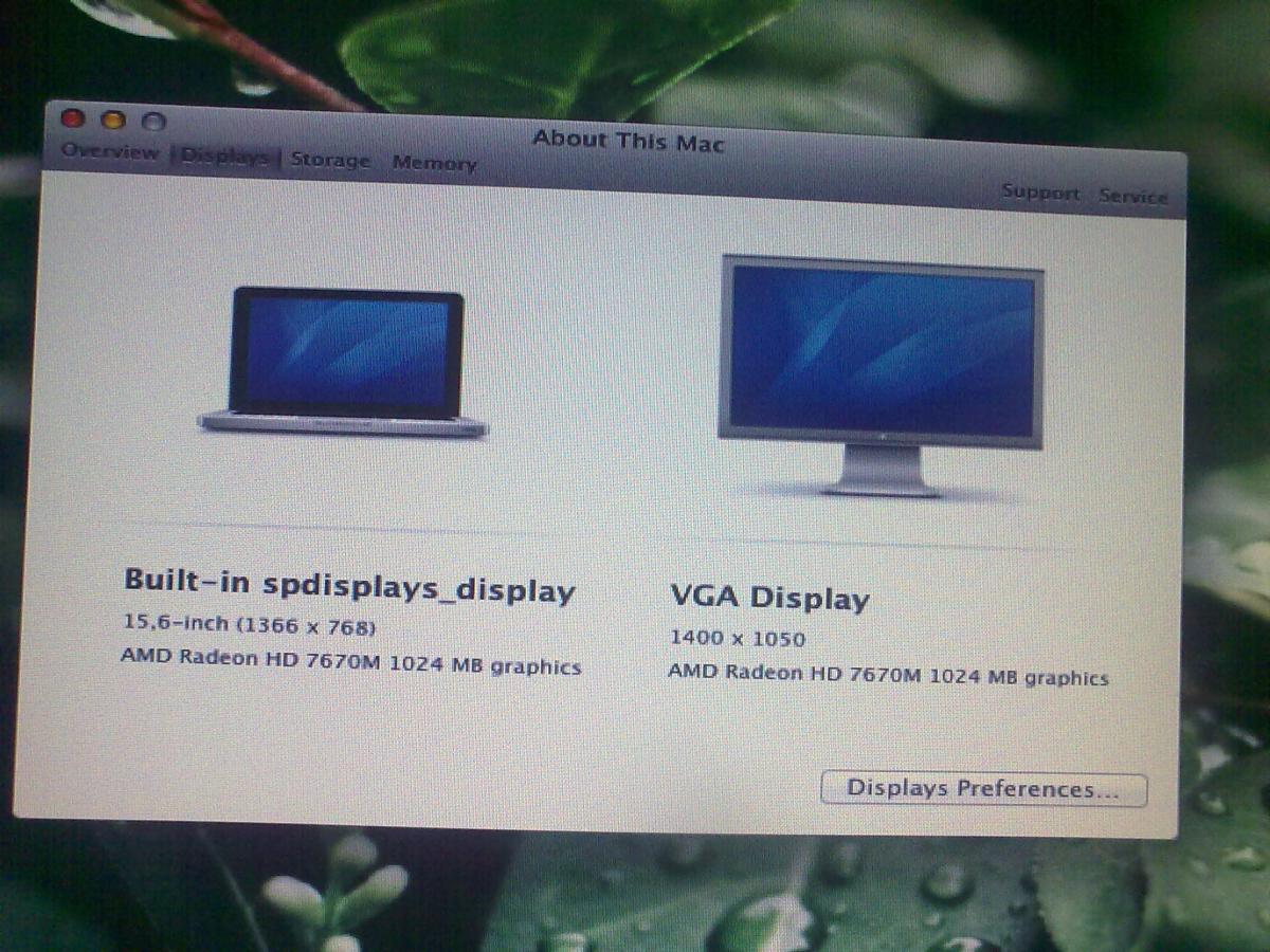

LVDS works perfectly with that EDID!

VGA works with those preset 4:3 resolutions, with some exceptions for 1080p, I am currently using 1400x1050@60hz instead of the native 1440x900@75hz.
