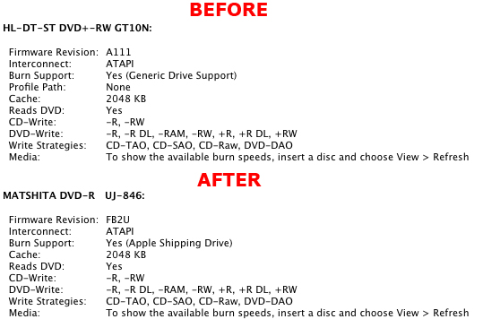

LatinMcG Posted February 27, 2012 Share Posted February 27, 2012 the cpu itself has to have VT remove the LAN0 _DSM { blabla } as you are using pci right ? theres a devicemergenub from andy that fakes superdrive for your dvd Link to comment Share on other sites More sharing options...

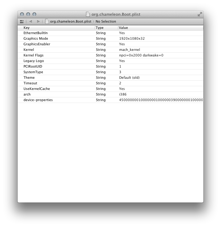

AnonMac Posted February 28, 2012 Share Posted February 28, 2012 I don't know the problem of the SuperDrive though. It never happened to me. Do you have the latest version of iDVD? As for the other problem. This is my org.chameleon.boot.plist file in the picture. This isn't the complete EFI strings, but the window would have been too large for it to show. See if this helps. I made it boot 32-bit because my WiFi card works only on 32-bit mode. ----------------- Ah that explains it. My CPU is an e5200 and after a Wikipedia search, maybe mine doesn't support VT. Lame. I'll try out the EFI flag but I doubt it'll fix anything. Since my card is unsupported I don't think it'll help. Unless Apple uses something other than the Ethernet/wifi to check verification. I read somewhere once that it has to be built-in, so with the boot flag, it should make Chameleon fool OS X into thinking that it is an official built-in network card. Link to comment Share on other sites More sharing options...
gygabyte666 Posted February 28, 2012 Author Share Posted February 28, 2012 My iDVD is v7.1.2 and i'm using iLife '11. Not sure if it's still the newest version or not. I've had it for a pretty long while now. About the picture....um, I can't see it. Did you upload it? Maybe my theme is messing with being able to see it. I'll try to change my theme around and see if it helps. EDIT: Yeah, just changed my theme to check and I still can't see a pic under your post. Bummer. >_> Link to comment Share on other sites More sharing options...

gygabyte666 Posted February 28, 2012 Author Share Posted February 28, 2012 I still have the latest? Wow! They seem to be pumping out everything else quicker than {censored} but not iLife? Lol that's kinda cool though. My plist is very similar to yours. Difference is that I'm not using x86 mode, npci, darkwake, PCIRoot, GraphicsEnabler or EthernetBuiltIn yet. I was planning on testing out npci, darkwake and ethernetbuiltin soon but have been busy so I haven't gotten around to it yet. Are you using a custom dsdt or are you just using modified kexts/chameleon flags with good results? I ask because my GraphicsEnabler flag was working great but since I have been bouncing between using so many different dsdts, it just stopped working so now I have to use NVEnabler. Also, what is the difference on your SystemType? Why is yours set to 3? I have the Optiplex mini tower and so I set it to 1 for desktop. What does 3 do differently for you? Thanks! UPDATE: Holy {censored}! The App Store just let me log in!!! No verified errors! Mind you, this is on SL. I still need to test Lion but still. Just checked. App Store works on both SL & Lion! I just rebooted and added in the following flags: npci=0x2000 (not sure what this does still) darkwake=0 (don't see any change using this) EthernetBuiltIn=Yes SystemType=3 (changed from 1) I also removed several lines that I had in, like these: DSDT=/Extra/dsdt.aml SMBIOS=/Extra/smbios.plist SMBIOSDefaults=No I doesn't matter that I removed these lines though because I discovered Chameleon by default loads smbios.plist & dsdt.aml if it finds them. A quick check of my System Profiler is telling me I was right about that too so, they still got loaded. It must have been EthernetBuiltIn, that's the only one that makes sense. Still, thanks for your help Anon! Something is fixed!!! Now if only I could manage to get that annoying iDVD error fixed, all be doing much better. I've looked ALL DAY and EVERYWHERE and can't find a decent resource for fixing the no SuperDrive error. I can't believe no one has a fix or a simple patch I could apply. Boo! Link to comment Share on other sites More sharing options...

LatinMcG Posted March 2, 2012 Share Posted March 2, 2012 LPC ich10 in patches/desktops dvd mergenub... get the id info as specified in post of superdrive faking. then we add it to the info.plist (im booted on osx about to mountain lion my desktop leopard 10.5.8 bye bye) so i can work on dsdt for a little bit but leaving to get son from school soon just to clear up PCI0 graphicsen.. the fix is the _UID, 0x00 right ? also hpet has a line if OSID 0x7D else returns. .. that has to be fixed the else return to 0x0F Edit: i see problem the Shutdown fix is pointing to 0x430 the cpu says 0x810 which means its in the 800 address range not 400 .. so it needs 0x830 not 0x430 also.. did u add power states in dsdt or did this come in dsdt ?? Scope (_PR.CPU0) { Method (_PSS, 0, NotSerialized) { Return (Package (0x04) { Package (0x06) { Zero, Zero, 0x0A, 0x0A, 0x0922, Zero }, more code... all under _PTS section the _PSS is ACPI Power States Specified (overrides chameleon GenratePStaes) Link to comment Share on other sites More sharing options...
