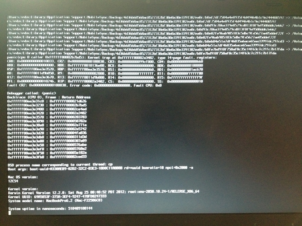

Now I get a kernel panic when I use the patches/addons in #109
What Chameleon Version do you use? I use rev.2050. Is it ok?
Edit: just copied over again default-Kext (from a vanilla 10.8.0 installation) and your patches/addons Kext.
Now it's booting but stops at "resetting iocatalogue"
I'll reinstall everything again. It would be nice to get the information what Chameleon version do you use. Thanks.

Lets figure out on what step do you get KP and what message it say. Take a photo if you can or just put down it somewhere
I think, its just not complete cleanup from oner kexts or something. All this kexts was tested on new 10.6-10.7-10.8 installs and everything was fine
I use Chameleon 2050 as you do and also I tried it with Clover boot loader too fine

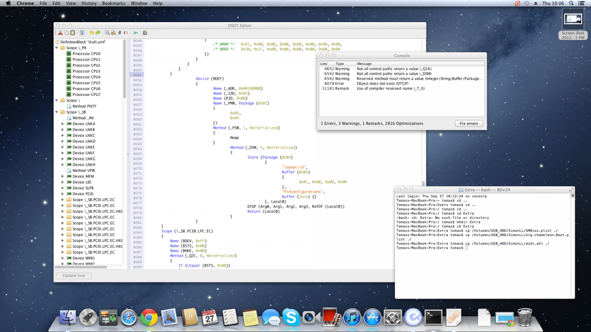

Just replace current section to this
Device (HDEF)
			    Name (_ADR, 0x001B0000)
			    Name (_S3D, 0x03)
			    Name (RID, 0x00)
			    Name (_PRW, Package (0x02)
				    0x0D,
				    0x04
			    Method (_PSW, 1, NotSerialized)
				    Noop
					    Store (Package (0x04)
							    "layout-id",
							    Buffer (0x04)
								    0x0C, 0x00, 0x00, 0x00
							    "PinConfigurations",
							    Buffer (Zero) {}
						    }, Local0)
					    Return (Local0)
