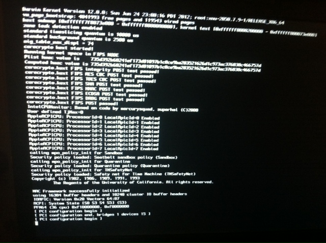

Joshhh firstly thanks for putting such an excellent guide together. I have followed your steps on my W510 using the dsdt you posted for the W510 (renaming it to dsdt.aml and copying over the dsdt.aml you had zipped up in the Extra folder. I boot to the bootloader and enter the "-v -f npci=0x2000" value. The drive boots but stops at the end of loading the .Kext files and appears to lockup (CapsLk stops working)
The final 3 messages on screen are:
[ PCI configuration begin ]
[PCI configuration end, bridges 1 devices 15]
The machine then stops and does not continue.
I am very keen to follow your method as I would like to get my shutdown/sleep/hibernate to disk functions working. I have been trying a few other methods to get the machine working but so far everything is working - except the power management and battery functions. If I can get your method working I think I'll be there - bar the hack on the Bios to allow me to use an intenal Wifi card).
Can you suggest what might be going wrong? Have I dont the right thing by copying the other w510 dsdt.aml into the Extra folder and overwriting yours?
What causes the hang at this point normally?
Thanks again for all your inputs on this approach - looks ideal for me to learn more on.
Paul

Hello Paul!
I can patch latest bios and remove whitelist from it. Also you can flash now latest version of bios and get dsdt from working machine, most of parts in dsdt should be the same but memory allocation regions may differ. So you can get it from live cd ubuntu or from AIDA64 in windows
About
in common situation this may be FakeSMC error or maybe or AppleACPIPlatform, wold be great if you make photo of boot log so I can get more details from it

Are you definitely boot with -v -f npci=0x2000 with no quotes? Possible npci=0x3000 may help instead of 0x2000
Hi Joshhh
here is a pic of the hang.
Joshhh I have made some progress since my last message. "The machine is now booting to DSMOS has arrived"! I have tried setting GraphicsEnabler=no but it still just stops there. When I boot to the single user/command line I dont have a keyboard. I think have finally worked out how to extract the DSDT.bin ( :thumbsup_anim: ) and have added it to this post. Slowly getting there I think.Here is my DSDT

I have renamed the .aml file to dsdt.aml and copied it into the extra folder. graphicsenabler=yes makes not difference to the behavior. Does the cloverleaf boot option need to have dsdt.aml specified? It have an option for DSDT with a value "BIOS.aml" next to it....
The symptoms I am seeing are still the same. THe machine's keyboard stops taking inputs when the ACPI stuff kicks in. I am using the voodoops2controller from the .zip files you shared. Is there another one I should be using?
Can you confirm the full string I need to use?
right now I have been using
-v -f graphicsenabler=yes npci=0x2000 (and also 0x3000)

Progress. I used -v -f graphicsenabler=yes npci=0x4000 and was able to boot to the GUI. Still no keyboard and trackpad/trackpoint I dont have a spare USB keyboard :os
I've used the voodoops2controller.kext you shared in your guide. What other options are there for me to try? What are the .kext files I need to replace in order to get the internal keyboard/trackpad and trackpoint working?

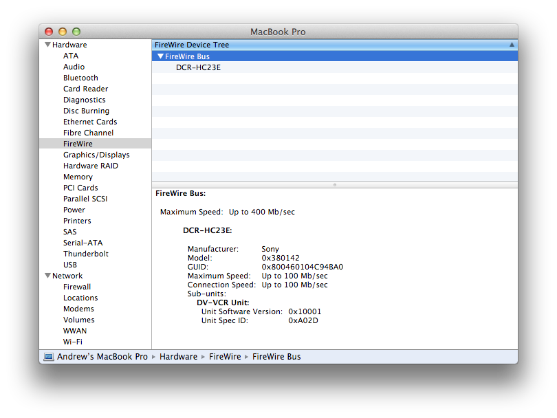

Has anyone tried out the firewire with ML yet? According to System Information, the firewire is detected:
FireWire Bus:
 Maximum Speed: Up to 400 Mb/sec
I'm considering buying an audio interface and just wondering if it's worth trying out a firewire one.

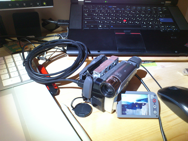

I can try to connect my old dv camcoder to ieee bus tomorrow and check it. I think it should work fine
FireWire Bus:

Thanks for offering to check the firewire. It'll be good to know if it works properly.
DV camcoder works well
I think its also possible to use IEEE port as network adaptor as I did a lot time before with my first generation 15" unibody macbook pro and desktop hackintosh
Could be onto something there. The laptop went into sleep mode while I wasn't there, before I had remembered to disable it in power settings. Although the KP didn't happen until a little while after wakeup. Hopefully it won't happen again.
