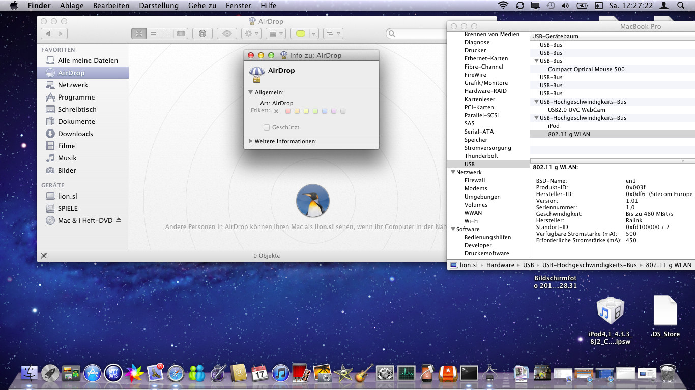

ralink 2870 ( sitecom wl-608 ) usb dongle .. thanks.. :hysterical:
Attached File  Bildschirmfoto_2011_09_17_um_12.27.22.png   974.99KB   182 downloads
