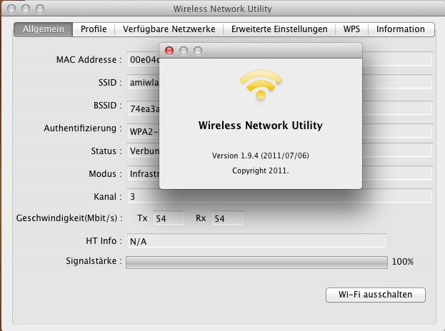

I use an Realtek based noname USB WIFI Stick:
802.11n WLAN Adapter:
BSD-Name: en1
Produkt-ID: 0x8176 (RTL8188CUS chip)
Hersteller-ID: 0x0bda (Realtek Semiconductor Corp.)
Version: 2,00
Seriennummer: 00e04c000001
Geschwindigkeit: Bis zu 480 MBit/s
Hersteller: Realtek
The realtek drivers (comes with an Wifi Util that runs on startup) works with Lion 64 Bit 10.7.2 C40.
Realtec supports OS X good (fast updates).
