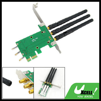

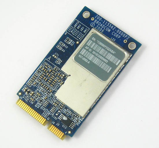

Noam AA Posted July 5, 2011 Share Posted July 5, 2011 so i've got my new wireless card, and it working OUT OF THE BOX if you want to know details, i searched for macbook/imac/macbook pro wireless card on ebay, i found this one = "Apple Wireless Wifi MacBook Pro Card BCM94321MC BCM4321" also ordered a Pci Express 1x wifi dongle for it, with 3 antennas (but need only 2) already when first booted with it the log screen showed me the airport icon at the top can say to everyone to try it out! cost me only 30$!!, i don't know whom to give credit, cause i read it in a tutorial, but it's great and all credits goes to him Link to comment https://www.insanelymac.com/forum/topic/261323-wifi-stick-for-lion/#findComment-1708898 Share on other sites More sharing options...

FuManchu84 Posted July 5, 2011 Author Share Posted July 5, 2011 in my case replug didn't work but if it works for you, maybe this will work for you too RT2500Replug.kext.zip ( 109.92K ) Number of downloads: 1 Unfortunately that didn't help (added my device- and vendor-id). http://www.monoprice.com/products/product....=1&format=2 Does that Realtek-Chip work without driver? so i've got my new wireless card, and it working OUT OF THE BOX Sounds awesome! So combining a card like this with some adapter like this does the trick? Is there anything else I have to take care of? Why do you need those antennas (there are also adapters without antenna...)? Isn't there an antenna in the card? Link to comment https://www.insanelymac.com/forum/topic/261323-wifi-stick-for-lion/#findComment-1709312 Share on other sites More sharing options...

Noam AA Posted July 6, 2011 Share Posted July 6, 2011 Unfortunately that didn't help (added my device- and vendor-id). Does that Realtek-Chip work without driver? Sounds awesome! So combining a card like this with some adapter like this does the trick? Is there anything else I have to take care of? Why do you need those antennas (there are also adapters without antenna...)? Isn't there an antenna in the card? Yep! just like mine. and the antennas of course are for the wifi reception, and they need to be connected to the wifi card (there are 2 connectors on this wifi card), just buy those two, combine, and put into your hack Link to comment https://www.insanelymac.com/forum/topic/261323-wifi-stick-for-lion/#findComment-1709529 Share on other sites More sharing options...
