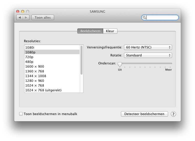

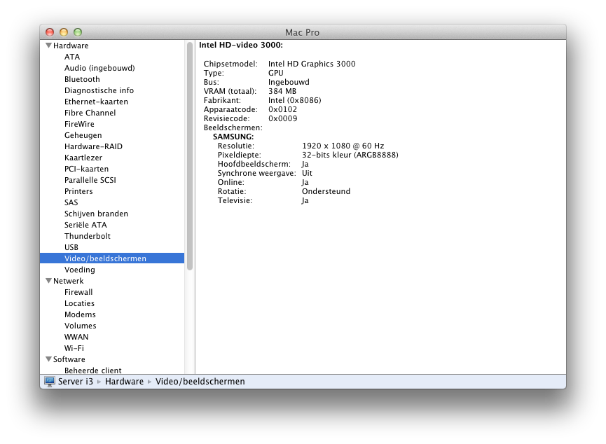

Here are some screenshots:
I just found out that it only works with the following smbios.plist
http://dl.dropbox.co...40/smbios.plist
I tried to install an iMac12.2 plist but then my resolutions were not correctly detected.

I followed this tutorial for the Lion (11A511) install.
http://www.insanelym...howtopic=256729
Note: In the installation menu of Lion my TV resolution was already native (1920x1080) !
After the installation i could not boot to the desktop because it will hang on the apple logo with my mouse enabled.
So i restarted the computer and booted into the Lion installer again and opened the Terminal app.
Now i removed all the AppleIntelHDGraphics kexts except:
AppleIntelIntegratedFramebuffer.kext
AppleIntelSNBGraphicsFB.kext
AppleIntelSNBVA.bundle
Then i could boot into Lion with no problems and with the resolutions enabled.
Edit: Just found out that VGA is not working for me...it won't even boot into chameleon but just freezes...DVI/HDMI are working perfect.

It was a standard macpro3.1 smbios. I only have managed to get the resolution to work. Still no QE/CI.
I only had to remove the AppleIntelHDGraphicsGLDriver otherwise it would hang.
