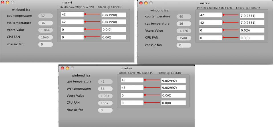

10.6.2 is speedstepping itself here (intel e8400) with asus p5q.
Removed /extra/Nullcpupowermanagement.kext
With no voodoopstate on 64bit:
Yep, OS X can do speedsteping without thrird party .kext, if AppleIntelCPU*.kext are loaded and working (Pstates in dsdt / in bios OK).
But AppleIntelCPU stepping may also depens of which model (iMac, MacPro) you use in smbios , because the AppeIntelCPU stepping also depends on what config in .plist of ACPI_SMC..plugin is used. That .plist changed in structure by 10.6.2.
Until know only some major/main things of that .plist entrys are well known. Most things not, like GPU throttling (also depends on that),
stepping itself (SP1...SP4). YOu cant adjust the thresould of stepping like with all other speedsteping tools.
