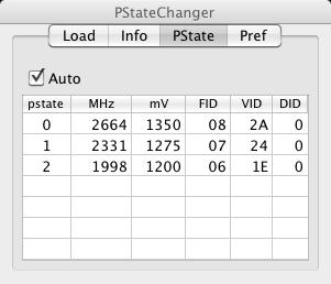

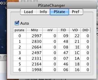

Smith@@™ Posted November 6, 2009 Share Posted November 6, 2009 I have try the voodooPstate v2 and it works, but with this version i have lost one pstate; with the "original" version, i have 4 pstate and all 4 pstate work well, looking cpu-x and voodoomonitor, but with v2 i have lost the 3° pstate, the lower, that with multiplier lower (in this case that with multiplier 6), now it is normal or I must come back to voodoopstate unmodded, "original" ? (Original pstate with unmodded version are with multiplier 7.5, 7, 6.5 and 6) Thank you for answer and sorry for my english Ciao Link to comment https://www.insanelymac.com/forum/topic/188954-64bit-p-state/page/4/#findComment-1322114 Share on other sites More sharing options...

Smith@@™ Posted November 7, 2009 Share Posted November 7, 2009 Ah, I wasn't careful enough with non-integer multipliers. I've made a new version that should handle that (though I cannot test it with my osx laptop). Will also update the diffs in my prior post in a sec... ok, i'll wait a good new, thanks Ciao Link to comment https://www.insanelymac.com/forum/topic/188954-64bit-p-state/page/4/#findComment-1322355 Share on other sites More sharing options...
bcc9 Posted November 7, 2009 Share Posted November 7, 2009 With your build, will it work even without using the monitoring app ?You can still use the kext with or without the app just as before. ok, i'll wait a good new, thanks I update my link & the diffs hours ago, (before the above reply), as promised. Link to comment https://www.insanelymac.com/forum/topic/188954-64bit-p-state/page/4/#findComment-1322456 Share on other sites More sharing options...

Smith@@™ Posted November 7, 2009 Share Posted November 7, 2009 Hi bcc9, i have try your modded voodoopstate v3, and it works, but I yet have lost the pstate value lower, exactly like with the voodoopstate v2.. I guess in a fix in future, thanks a lot again Have a nice day Ciao Link to comment https://www.insanelymac.com/forum/topic/188954-64bit-p-state/page/4/#findComment-1322914 Share on other sites More sharing options...
bcc9 Posted November 8, 2009 Share Posted November 8, 2009 Hi bcc9, i have try your modded voodoopstate v3, and it works, but I yet have lost the pstate value lower, exactly like with the voodoopstate v2.. I guess in a fix in future, thanks a lot againAre you sure you're not just losing pstates < 6X? That would be expected since I'm disabling any super-LFM pstates. I've double checked my work by running it on a gigabyte p35 motherboard, and the results are significant and it's working just fine: Before (with hnak's 1.0.3 version): After (with my v3 version): Link to comment https://www.insanelymac.com/forum/topic/188954-64bit-p-state/page/4/#findComment-1323205 Share on other sites More sharing options...
Smith@@™ Posted November 8, 2009 Share Posted November 8, 2009 But the v3 working well, really, it's fantastic, the voltage is lower; only "problem" is that with original 1.0.3 version i haved 4 pstate, and with your modded version i have only 3 pstate, simply, but your version working fantastic anyway... The lost pstate is the lower, that with frequency lower, but it isn't a 'big' problem Sorry for my english, Ciao Link to comment https://www.insanelymac.com/forum/topic/188954-64bit-p-state/page/4/#findComment-1323443 Share on other sites More sharing options...

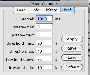

Smith@@™ Posted November 9, 2009 Share Posted November 9, 2009 I have the pstate lower again, thank you bbc9. But I have 2 question: 1) Which the optimal value for interval cpu load? The default is set to 400; 2) Confuse idea: if I don't use the app, PSTATE CHANGER, in the dock, or well if I don't use the app never, what happen? Have I will problems in the future; that I would say is: the up and down of pstates works will the same? Thank you and sorry for my english.. Ciao Link to comment https://www.insanelymac.com/forum/topic/188954-64bit-p-state/page/4/#findComment-1324669 Share on other sites More sharing options...

mitch_de Posted November 9, 2009 Share Posted November 9, 2009 Sure. But its simple : The PstateChanger App does use much to high cpu ticks (cpu usage) to do its work. Again: PstateChanger should refersh the window / results TABs much less + independed from do the stepping so save cpu load/ticks. So an second timer is needed in PstateChanger: One timer (configurable) for how often to step / An other timer (configurable) for how often to refresh the values shown. For me its useless in that stage, i will use voodoominipower which has an much less cpu footprint doing same job (in Leo). Also AppleIntelCPUPowermanagement , which can be used with SL (voodoominipower not) will have an much less cpu footprint. Link to comment https://www.insanelymac.com/forum/topic/188954-64bit-p-state/page/4/#findComment-1324804 Share on other sites More sharing options...
