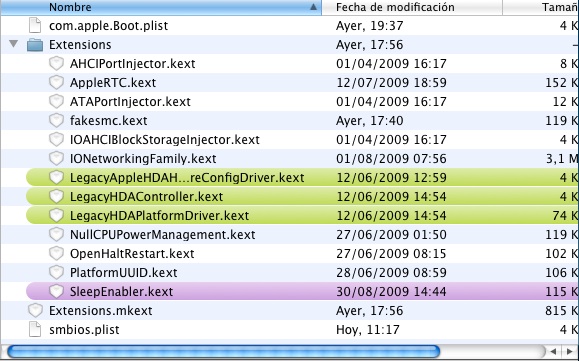

Kext Pack
Here's what I'm rolling with guys. Please note that I included a hex EFI string for an 8800GT in the com.apple.boot.list Use EFI Studio and replace with your own for now.
Features :
- Video
- Sleep (Wake from BT works great, I use a Belkin Mini Dongle)
- Audio (Works but I'm still refactoring so feel free to use VoodooHDA)
- LAN
I haven't experienced any random kernel panics so far.
I'll try and do up a comprehensive Snow Leopard guide soon.

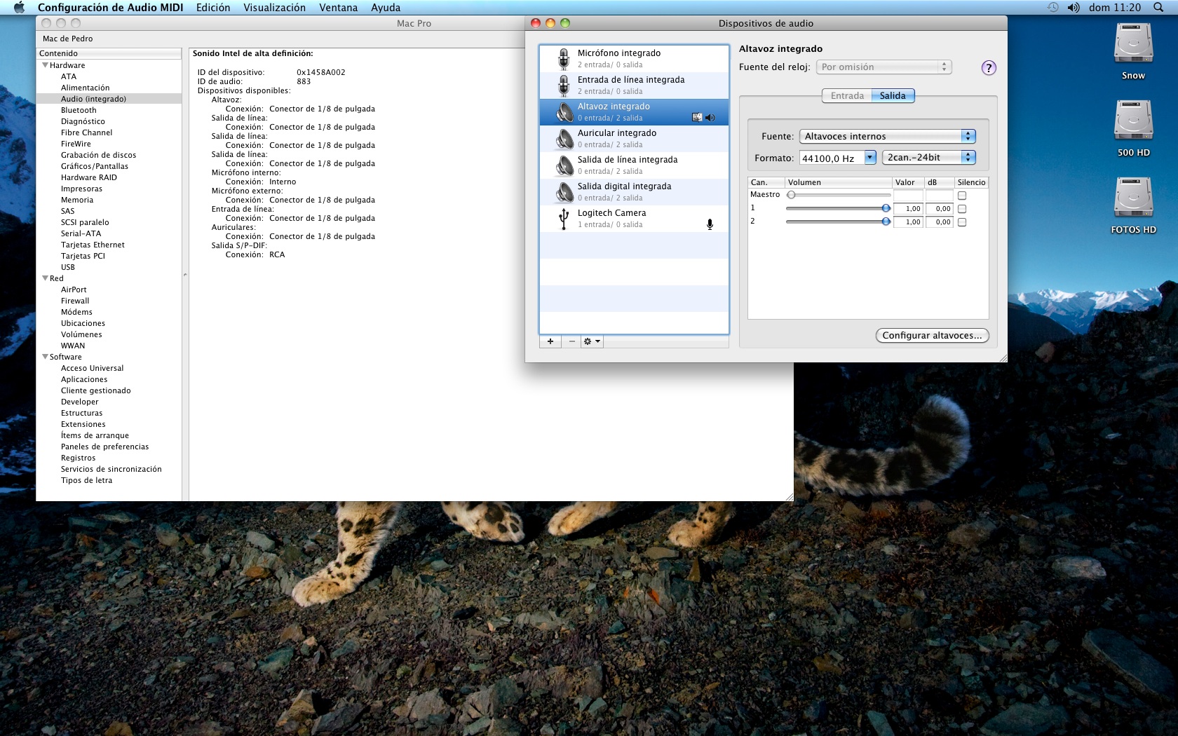

ALC883 32bit/64bit Audio Solution Found!
BlackCH beat me to it already. He's created a patched LegacyHDA Kexts specifically for Snow Leopard ALC883. Why reinvent the wheel.
Features :
4 Outputs / 2 Inputs
  • 2 Line Outs Rear (Black)(Green) working - Tested Working
  • Mic In Rear (Pink)- Tested Working
  • Lin In Rear (Blue)
  • Headphone Out Front (Green) - Tested Working
  • Digital Out - Not Tested (Most likely working)
By using this audio solution you can leave your Snow Leopard AppleHDA kext untouched/vanilla/original.
Thank you very much BlackCH. This tromps all over the VoodooHDA.
Installation Instructions
Step 1. Download the BlackH's kext pack here and extract the 3 kext files into your /Extra/Extensions folder.
Step 2. Download the attached DSDT.aml and place it in /Extra/DSDT.aml (This includes the CMOS error fix)
Step 3. Get the latest Kext Utility and put it on the desktop.
Step 4. Drag your /Extra/Extensions folder to the desktop.
Step 5. Drag the Extensions folder on your desktop directly onto the Kext Utility Icon.
Step 6. Kext Utility will open and start to correct permissions and generate you an Extensions.mkext
Step 7. You'll now see a new file called "Extensions.mkext" on the desktop. Drag both the Extensions folder and the Extensions.mkext FROM the desktop to your /Extra folder. Authenticate the action when prompted and replace.
Step 8. Reboot.
Step 9. Check for sound assertions(you never know...) by booting with the -v flag.
Step 10. Test your sound in Snow Leopard.

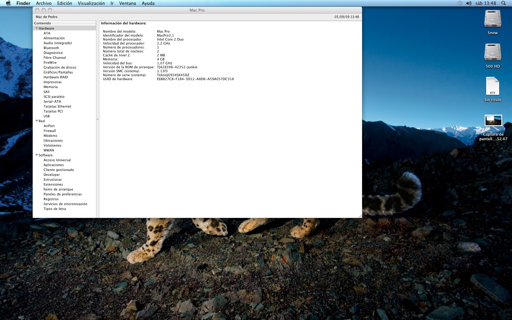

[Update] : It appears that apple's agressive power saving may be the cause of the popping. The intel chip is going into sleep mode and makes a popping sound when the chip is woken. I'll keep looking for a solution.
[Update 2] : tmongkol has suggested to set the SMBIOS as MacPro to resolve the popping sound. I'll try this when I get home. Maybe someone else can confirm this for me. Can anyone else confirm the Mono output issue?

The Mono/Stereo issue is quiet interesting. I'll check it out later tonight. I noticed what is listed in your System Profiler seems incomplete. I managed to swap out the Digital Out for the Orange Line Out by editing the Pathmaps. I'm still confused why there's a popping sound when the sound is initialised. A way to reproduce this is if you go System Prefs->Sound->OutputTab and hear the pop when you change between some outputs listed there.
Regards,
Slither2008.
Hi slither,
The mono effect might be due to internal speakers as output. I could not select any other output except digital output.
The sound was much better in my 10.5.8, more stereo effect and crisps.
Is there any way to modify the alc883 legacy kexts?
Would the alc883audio.pkg that works on 10.5.8 work here?
Thank you.

Tmongkol was right, setting the SMproductname to MacPro3,1 fixed the popping noise from the sound card.

Thank you Slither2008. I got sound working using a patched DSDT and Legacy HDA kexts.

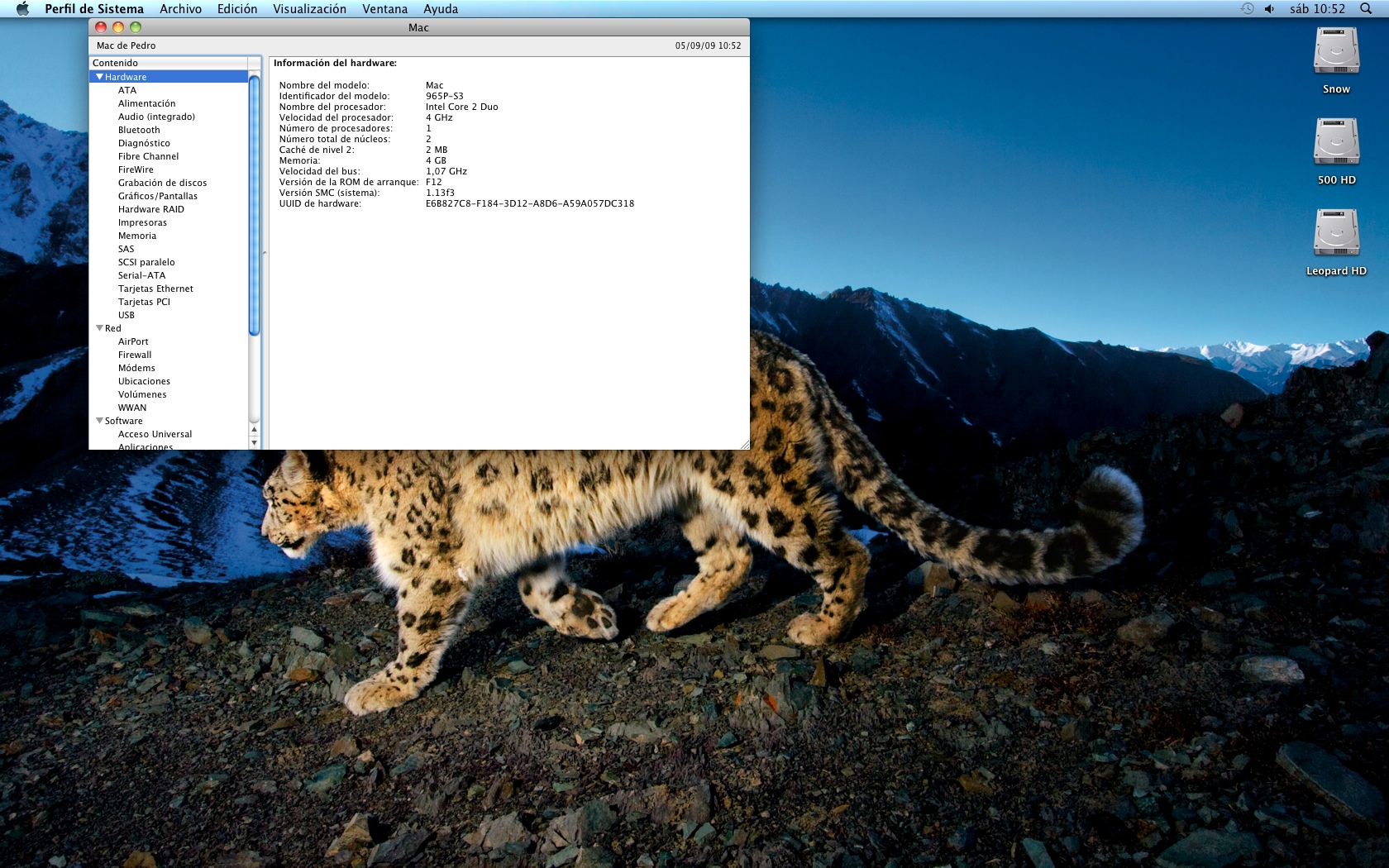

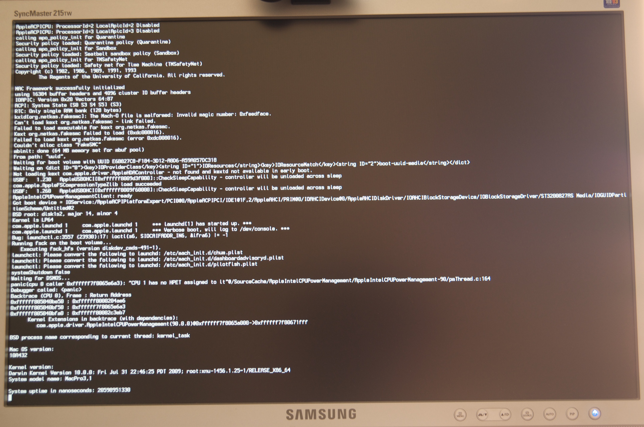

Hi Slither!!
First of all, thank you very much for your help. I have checked all the indications you gave, but I can't boot with the Chameleon 2 RC1 because I have random KPs and I don't know why. Then I'm using the Chameleon v1012 and changing to MacPro3,1 doesn't fix the popping noise.
I think it's because bootloader doesn't charge the SMBios.plist.
How can I fix the randoms KPs with the Chameleon 2 RC 1? I have repaired permissions with the other bootloather and it doesn't fix it.
I have a GA-965P-S3 rev 1.0 Firmware version 12
Thanks
No problem. I'm still working on an improved version atm. I've managed to get the headphones and the green Line out to auto detect and switch when you plug headphones in at the front. Works really good.
I'm still modifying it for 5.1. I've got the pathmaps and layoutid identical to what I had on leopard, there's some other important factor I'm missing. I pretty sure the verbs I'm using are not in the right combination.
I'll again check later tonight.
Hi Slither!!
Thanks
You welcome. I manually changed the SMproductname in my SMBios.plist. I think there are smarts in the AppleHDA regarding power management that it applies depending on what mac product the driver detects. Can you send a screenshot of your System Profiler.
I found that after I installed Snow Leopard, I had to install the BSD.mpkg from the Install disc. I then rebooted into safe mode using -s -x32. I used the commands I've previously listed to regenerate the kext cache. After that my installation was rock solid. Also make sure you're using the latest netkas boot file (place it in root /).
Good luck!
