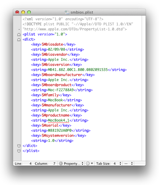

My smbios.plist:
PLEASE THIS IS VERY IMPORTANT FOR 10.6.8 & 10.7. See there is NOT my own-genuine SERIAL NUMBER for prevent iCloud "max exceeded connections" problems. BUT MUST MATCH as you can verify HERE (another useful site). Therefore, to understanding the Mac Serial number and create yours (not shared), please see this Article (courtesy by Prasys).
For MB4,1 profile users (Penryn CPU):
0P0 = T8100
0P1 = T8300
i'v made it using champlist,please take a look at it ,motherboard and bios version got from here .. anything else needed to add?? Anyway Big Thanks for Your help
EDITED
Okay,i'v created my own genuine serial number.
New smbios.plist.zip is here with with the macbookpro2,2 NON-genuine serial number ...
W0H =T7600 Merom (2.33 GHz)
X6A =T7400 Merom (2.16 GHz)
...What's next (6820s has T7250 Merom(2.00 GHz))??? smbios.plist works great on 10.6.8 , temp of cpu is 48c on normal work to max 65 on heavy work

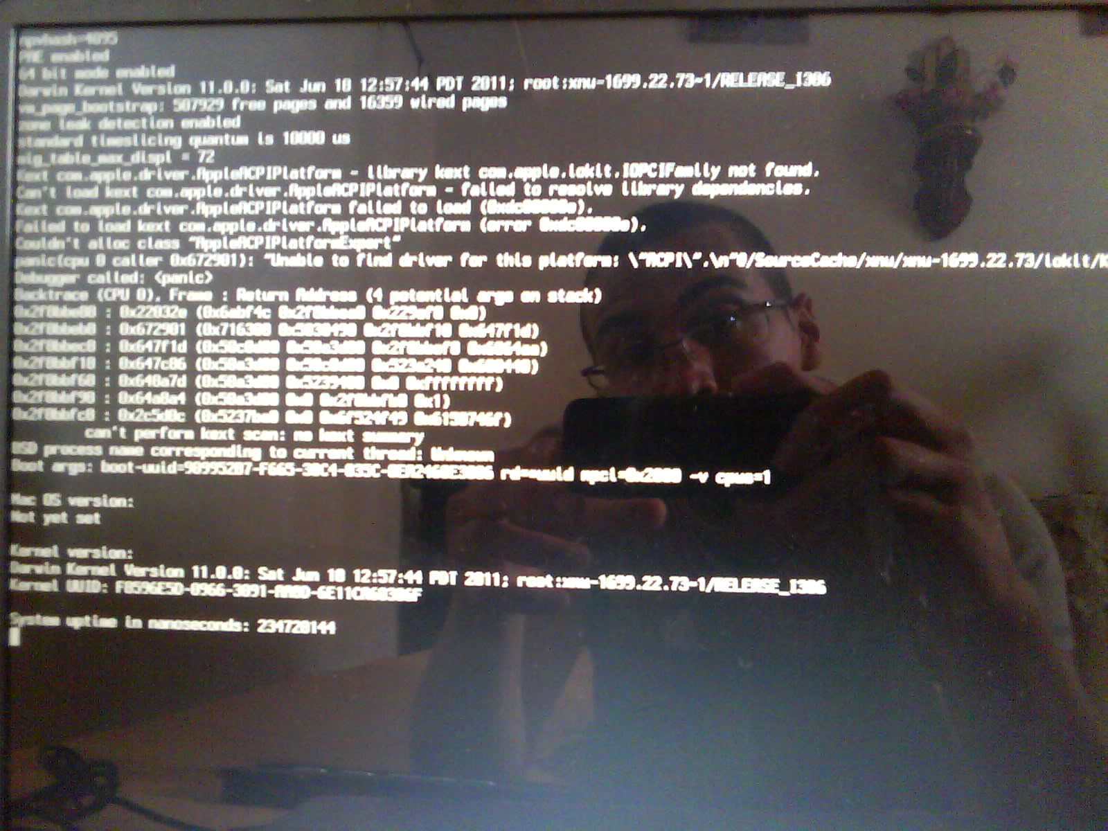

…pointer is there(top left corner) but it dosn't move,mouse moves,pointer dosnt(change resolution to see the pointer in the top left corner)
http://www.insanelymac.com/forum/index.php?showtopic=135410&st=1340&p=1815492&&do=findComment&comment=1815492
@ redeck2
just add AppleACPIPlatform.kext original from lion instead of mine AppleACPIPlatform.kext(he is the reason of kp)
ok
kp iopcifamily.kext i will add the original one
ok lion load but i cant see the cursor
we need to pach RadeonHD.kext to get it work on lion
i think this is the only solution because we got full resolution and lion detect ati x1350
RadeonHD.kext works with the IONDRVSupport.kext to make graphics acceleration work…so if u want to use RadeonHD u must use a IONDRVSupport.kext from 10.6.7,don't use any graphic injects becouase they also use IONDRVSupport.kext….RadeonHD.kext is not yet fully compatible with lion and 10.6.8,that is the reason you must use 10.6.7 files to make it work…My testing made ati x1350 work with 10.6.8 with full resolution and graphics acceleration,but same files used to get 10.6.8 work ,don't work on lion...

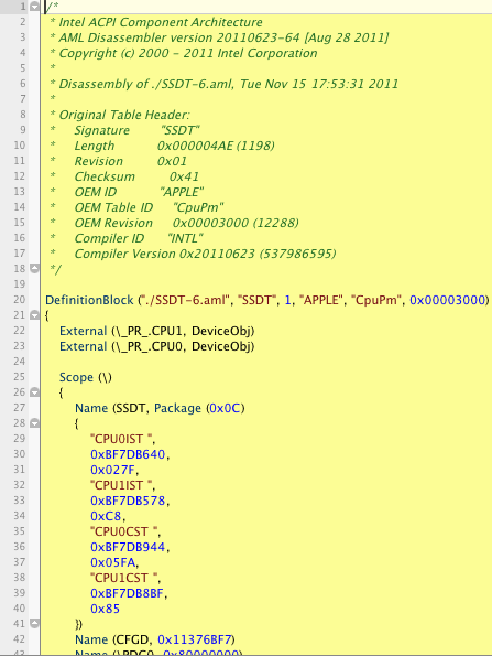

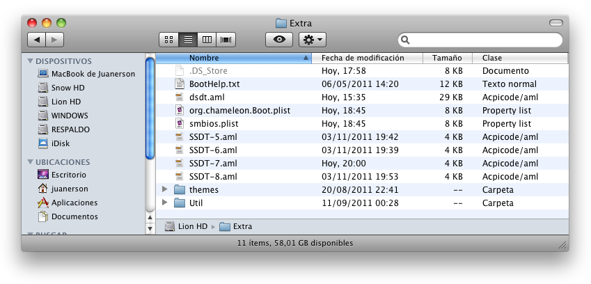

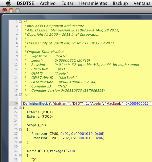

Hi folks, I want to share a new way to me about dsdt + ssdt loading tables:
1) In DSDT, my processors section (Scope _PR) I leave it only with this code (see also the first capture):
CODE
Scope (_PR)
Processor (CPU0, 0x01, 0x00001010, 0x06) {}
Processor (CPU1, 0x02, 0x00001010, 0x06) {}

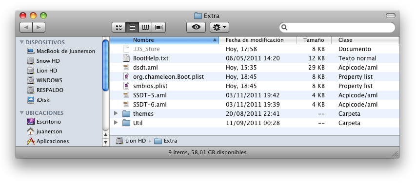

2) Then, I put the attached files C-States tables 5 and 6 (any CPU supported) into the /Extra folder:
After restart you should have all normally, with C-States support from factory ssdt tables, like in 10.6.7 (and prior).

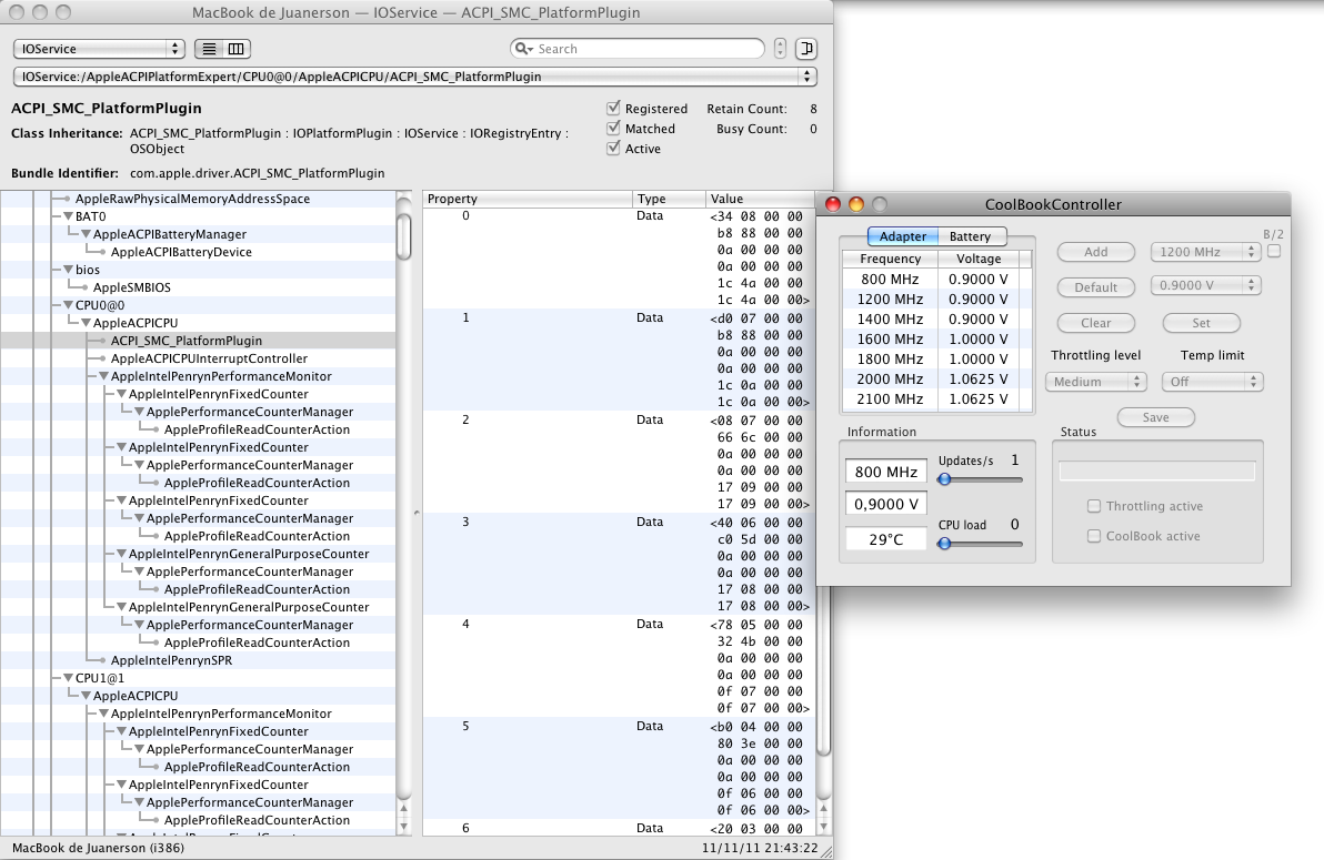

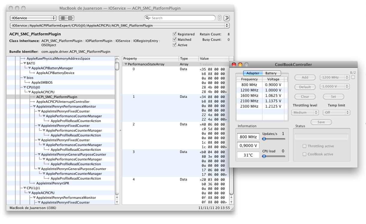

- Note about P-States (my CPU is T8100 2100 MHz): In the same direction, in the next capture you can see my five (5) default P-States including IDA (2300 MHz) from firmware (see PM ssdt table 4). Both, IORegistryExplorer (detailed values) and CoolBook (single table), show me all the information I need to know about frequencies end voltages loaded:
3) OPTIONAL: Implementation of custom P-States (with undervolt applied). I attached my SSDT-7.dsl table "as reference" at this point. Please read the explanations and legend about IOreg, multipliers and voltages. I think It is really very easy to understand how to do it. But, ONLY test this if you know what are you doing, and at your own risk (NEVER UP VOLTAGES).
When you finish, then must copy to /Extra both compiled files (.aml) P-States tables 7 and 8 to load your changes:
See for example the results from my SSDT-7 table, after implement my own custom P-States (Now I have 7, without IDA):
- Note about CoolBook (just for monitoring): I have installed the 2.20 version (attached for clean install) because the latest release 2.22 does not read my P-States correctly. This is a known issue in this thread.
- Tip for testing purposes: it is NOT necessary to reinstall CoolBook to see the changes in MHz & V., and after every change applied to the table 7. JUST close (Exit) the Application -- and trash the config-settings file (in your useraccount folder):
/Users/juanerson/Library/Preferences/se.coolbook.CoolBookController2.plist
Immediately open it again, and the .app will take the new P-States and Voltages, but "of course" if you restarted Mac OS X with different values in SSDT-7 table. In conclusion, do that after every change in table 7, and his respective restart.
I hope you like and enjoy it. Good Luck.
EDITED: Even by this way, if you like it, you can go back to use the Legacy_SpeedStep injector (info.plist) installed in /S/L/E, both in Snow (the same from 10.6.5) and Lion (building a new one), for native SS with MacBook3,2 (merom) or MacBook4,2 (penryn) Fake profiles (just the "SMproductname" change in smbios.plist), keeping vanilla the resource MB3_1.plist or MB4_1.plist on /S/L/E... IOPlatformPlugin... I mean, free of break from Combo Updates. Works great for me.
C_States_Tables_5_6.zip
Custom_P_States_Tables_7_8_OPTIONAL.zip
CoolBook_220.dmg.zip
Hi Juanerson,
I am interested in using your speedstep variables to reduce power consumption and we have same processor.
I replaced scope pr section as you mentioned and copied ssdt-5-8 to /Extra.
Chameleon svn 2.1 v1700 is installed.
It does not load the ssdt tables at boot.
Is there a variable to set in org.chameleon.Boot.plist or anything else to force chameleon to load those tables?
Hi. No, you don't need to force anything because could be dangerous for you. Furthermore, the technical reason why is not loading the tables from my laptop is because we have different laptop models, and the most probably different SSDT tables (from BIOS). Please use yours, and build your own customize P-States (SPSS and _PSS) for your T8100, because voltages compared with mine can be different too... Therefore, I think it is a bad idea to use the same voltages from others, even if you have the same CPU model IMHO. Also, you could try just only loading the 5 and 6 tables for C-States. Let me know.
Looking to Wait=Yes at boot it shows that it don't load ssdt tables
Shouldn't it, even it doesn't match my hw?
I am almost sure it is a pure BIOS (for you hardware) miss-match reason of not loading the tables. Also, CPU has one "caller" ssdt table (number 4 for 6720s) located in memory from firmware, for communication (must be compatible) with that BIOS. Please re-check your DSDT, compare the PR Scope and ssdt tables with mines carefully... and finally use yours. Good Luck.
EDITED: Just for record, at this point (only loading C-States and custom P-States tables) please forget about to use DropSSDT=Yes. If you really want to use that flag, for example to unload SATA-PATA and TZ main table (those unnecessary ssdt tables in my case), then you need to put all the rest of your ssdt tables in /Extra, and being the most important of them the CPUpm table, wich is take it from the firmware as I said. So, at the end, it will load two-three tables less.
Example of how looks my CPUpm ssdt table (from my T8100 firmware):

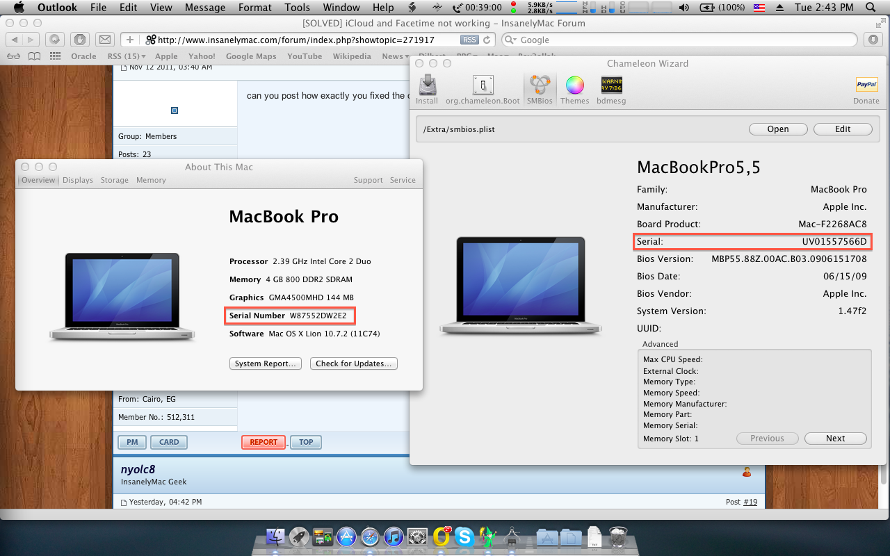

Hi all,
I have HP 6730b laptop with Lion 10.7.2 using Chameleon 2.1svn r1684 and everything is fine except the known issues (no QE/CI and and no kext for the wireless AGN PRO/5100).
My problem is not accessing iCloud. I tried different SNs but I noticed the problem is that no matter which SN I use in smbios, the SN shown in system profile is staying unchanged despite it reads correctly from smbios during boot. So, I 'm stuck with the "Account limit reached" message.
Do I need to modify any thing to make it work ?
[solved] remove smbiosresolver.kext
TIA

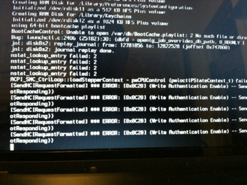

This is what I get when trying to install lion.
Not sure what I did wrong.
