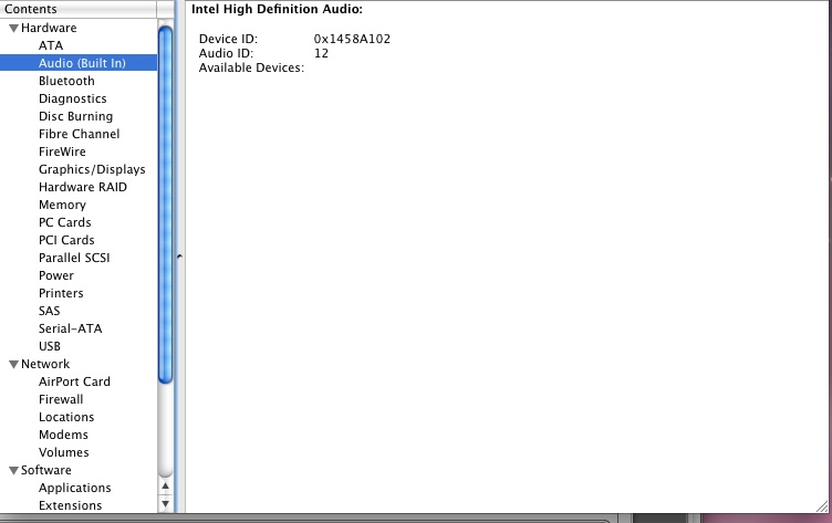

I installed the 889a V5 using osX86Tool.
Now I have stuff showing up in System Profiler, but it does not list all ports like my real MBP.

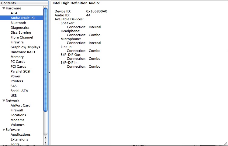

Here is a pic of my HackPro's Audio Profiler:
Here is a pic of MBP Audio Profiler:
When you installed using chameleon, did you install it right from the beginning? What am I doing wrong?
Mine looks just like your MBP.
Intel High Definition Audio:
Device ID: 0x1458A102
Audio ID: 889
Available Devices:
Speaker:
Connection: 1/8 inch Jack
Line Out:
Headphone:
Line In:
Microphone:
S/P-DIF Out:
Connection: Combo
Somehow yours didn't install properly. Make sure that AppleHDA.kext is in /System/Library/Extensions . Mine is version 1.6.2a37.
One thing you can try is reboot and hit a key during the countdown and type in "-f" to rebuild extensions during the startup process. This has fixed some of my issues.
Thanks johndingle.
I had the correct AppleHD.kext, but upon further investigation I had an ACLinject.kext from a previous attempt at patching the sound that seemed to causing the problem this time.
