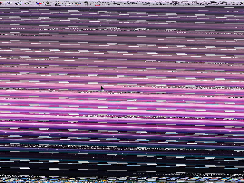

Some interesting thing to discuss.
With native IONDRVSupport, only 1024x768, 1280x1024, 1400x1050 can be the boot resolution that displays correctly with my x1400. Well, 640x480 is also ok.

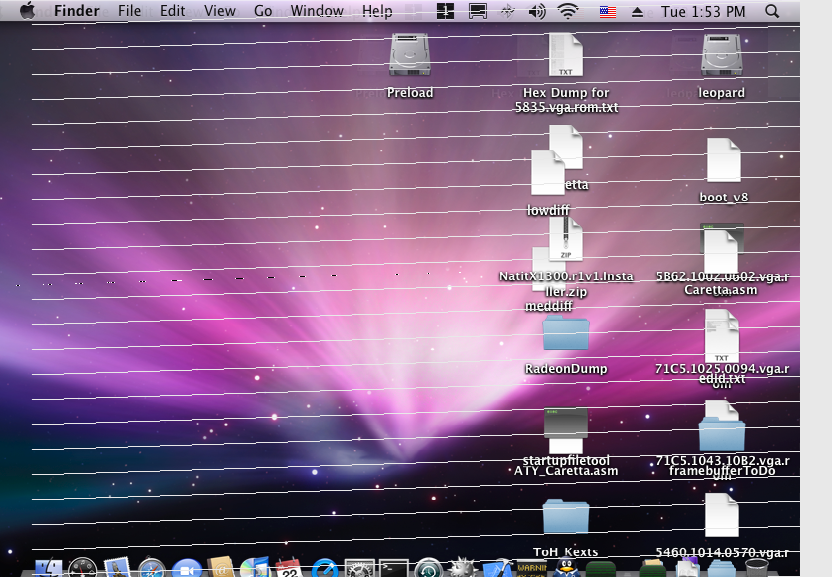

When boot with 800x600, it displayed like this:
I looked at this picture, thought it was a 832x577 displayed as 800x600. Then I wrote a little program to turn it back to 832x567. It now looks like this:
If you look at the new image carefully, it actually has been draw two times at different width offset(differed by 32 pixels). The -32 pixel one is not so obvious, but it may caused the extra white line everywhere.
You do not use your driver here?
If so BIOS uses VESA modes and VESA timings.
White lines are probably means vertical scan precision. Timings for 577 and 600. Apple(VESA?) mode is 832x624.
624=24*26 600=24*25 576=24*24. You have 24 white lines. So...
It's time to use
./RadeonDump -r 3000,7000 or else range where your Surface registers is located.
More difficult to dump PLL registers with indirect access but I think it is not impossible to you.
If you dump registers in each case you can understand how to write good values in it.
once in similar situation it was incorrect color depth, 24 instead of 32. give it a try )
