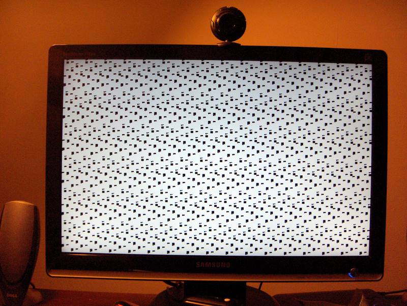

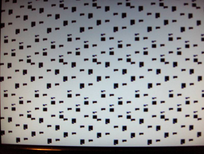

ufo_all Posted April 10, 2008 Share Posted April 10, 2008 i trried many times all the time it goes blank.. my ATI 2400HD not working on leopard 10.5.2. i quit .. fedup of reinstalling again and again.. i've already installed more than 10 times just to get my graphic card to work.. still there is no good news for ATI 2400. so i uit going back to windos xp and mandriva..good luck all you guys.. Link to comment https://www.insanelymac.com/forum/topic/94090-how-to-ati-radeon-hd-2400-2600-2900-3850-3870-on-leopard/page/3/#findComment-703717 Share on other sites More sharing options...
drumthrasher109 Posted April 10, 2008 Share Posted April 10, 2008 i trried many times all the time it goes blank.. my ATI 2400HD not working on leopard 10.5.2. i quit .. fedup of reinstalling again and again.. i've already installed more than 10 times just to get my graphic card to work.. still there is no good news for ATI 2400. so i uit going back to windos xp and mandriva..good luck all you guys.. I feel you man. My 2600PRO has never worked properly so I just live without graphic acceleration. I got my resolution changed to what I want, the only thing that really bothers me is that the dock moves around slow and the taskbar isn't transparent. Link to comment https://www.insanelymac.com/forum/topic/94090-how-to-ati-radeon-hd-2400-2600-2900-3850-3870-on-leopard/page/3/#findComment-703800 Share on other sites More sharing options...

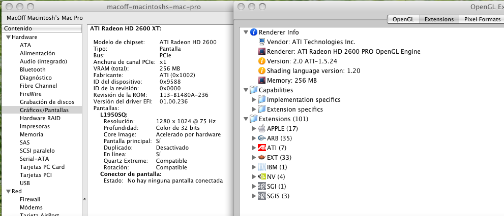

macoff Posted April 14, 2008 Share Posted April 14, 2008 Hi everybody, if anyone can lend a hand with a OpenGL problem in a HD2600 XT. The profile system appears as XT, but the OpenGL Extensions Viewer tells me that are using a HD2600 Pro, part in the xBench give me just 82 points in OpenGL. If anyone knows how to fix this I will be very grateful. In advance thousand thanks MacOff Excuse my poor English Link to comment https://www.insanelymac.com/forum/topic/94090-how-to-ati-radeon-hd-2400-2600-2900-3850-3870-on-leopard/page/3/#findComment-708527 Share on other sites More sharing options...
lastExile Posted April 14, 2008 Share Posted April 14, 2008 Hi everybody, if anyone can lend a hand with a OpenGL problem in a HD2600 XT. The profile system appears as XT, but the OpenGL Extensions Viewer tells me that are using a HD2600 Pro, part in the xBench give me just 82 points in OpenGL. If anyone knows how to fix this I will be very grateful. In advance thousand thanks MacOff Excuse my poor English thats just cosmetics Link to comment https://www.insanelymac.com/forum/topic/94090-how-to-ati-radeon-hd-2400-2600-2900-3850-3870-on-leopard/page/3/#findComment-708759 Share on other sites More sharing options...
macoff Posted April 14, 2008 Share Posted April 14, 2008 Hi LastExile, thank you for responding. I do not think that is something cosmetic, since earlier in the xBench gave me 142 points on OpenGL and after upgrading to 10.5.2 the result is 82 points. Is this something cosmetic? Again thanks MacOff Link to comment https://www.insanelymac.com/forum/topic/94090-how-to-ati-radeon-hd-2400-2600-2900-3850-3870-on-leopard/page/3/#findComment-708863 Share on other sites More sharing options...

DimitrisT Posted April 15, 2008 Share Posted April 15, 2008 Hi everybody, if anyone can lend a hand with a OpenGL problem in a HD2600 XT. The profile system appears as XT, but the OpenGL Extensions Viewer tells me that are using a HD2600 Pro, part in the xBench give me just 82 points in OpenGL. If anyone knows how to fix this I will be very grateful. In advance thousand thanks MacOff Excuse my poor English I am having the exact same problem and I thing that it caused from the fact that there is a problem with opengl.framework. When ever I try to play a game or something that uses open gl ver 2.0 or ver 2.1 the program crashes. Any help please Link to comment https://www.insanelymac.com/forum/topic/94090-how-to-ati-radeon-hd-2400-2600-2900-3850-3870-on-leopard/page/3/#findComment-709894 Share on other sites More sharing options...
macoff Posted April 16, 2008 Share Posted April 16, 2008 @DimitrisT Hi DimitrisT, if you solve the problem or find something about this. Please do know at this post. Greetings MacOff Link to comment https://www.insanelymac.com/forum/topic/94090-how-to-ati-radeon-hd-2400-2600-2900-3850-3870-on-leopard/page/3/#findComment-710428 Share on other sites More sharing options...

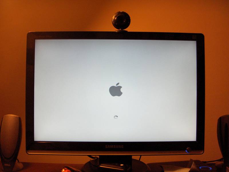

Proq Posted April 16, 2008 Share Posted April 16, 2008 Hi I'm really new in the MAC world I've just installed Kalyway 10.5.1 after restarting I get the Grey screen with the logo and the loader and then it goes to hundreds little screens of the actrual screen. So in other words I CAN'T USE LEOPARD I have an ATI 2600 XT with 512 DDR3 Could you please give me any sujestions of what may be going on and how could I fix it? Thanks Pablo Link to comment https://www.insanelymac.com/forum/topic/94090-how-to-ati-radeon-hd-2400-2600-2900-3850-3870-on-leopard/page/3/#findComment-710569 Share on other sites More sharing options...
DimitrisT Posted April 16, 2008 Share Posted April 16, 2008 @DimitrisTHi DimitrisT, if you solve the problem or find something about this. Please do know at this post. Greetings MacOff First off all I would like to pose my system, Motherboard: Gigabyte GA-MA69GM-S2H Proc: Amd 4600+ 4 x 1 GB DDR II (667) 250 Gb Western Digital Hdd Saphire HD2600Pro Samsung S-ATA DVD -RW I used the Leopard-10.5.2-AMD-EFI-Rev2, with nattit for the Video Graphics. That's all. I have connected my computer to my LCD TV, via DVD-HDMI and I have Full HD 1920x1080@60 with CI/QEAND NOW THE PROBLEM. Definitely, my problem is with opengl.framework because I did some testings yesterday and I found out that if I copied opengl.framework from 10.5.1 I have strange results even when I try to log in, (it does not login any more). Furthermore I found some drivers (I don't remember where, I downloaded a lot of different files from a lot of places so I lost track), that gave me full resolution, better Gl tests in Xbench (132), but no CI/QE. Damn !@#$!@#$!@@#$%. I am trying again tonight !!!! Besides that I must say it is the BEST Operating System I've seen. HiI'm really new in the MAC worldI've just installed Kalyway 10.5.1after restarting I get the Grey screen with the logo and the loader and then it goes to hundreds little screens of the actrual screen. So in other words I CAN'T USE LEOPARD I have an ATI 2600 XT with 512 DDR3Could you please give me any sujestions of what may be going on and how could I fix it?ThanksPablo My friend download nattit from netkas, (google is your best friend) and kexthelper (again google is your best friend), and then try to boot safe mode pressing F8 at boot time and then type "-x". Install nattit with kexthelper, it's much easier than you think, cross your fingers and reboot.It worked for me and I had the same problems. Link to comment https://www.insanelymac.com/forum/topic/94090-how-to-ati-radeon-hd-2400-2600-2900-3850-3870-on-leopard/page/3/#findComment-710691 Share on other sites More sharing options...
macoff Posted April 16, 2008 Share Posted April 16, 2008 HiI'm really new in the MAC world I've just installed Kalyway 10.5.1 after restarting I get the Grey screen with the logo and the loader and then it goes to hundreds little screens of the actrual screen. So in other words I CAN'T USE LEOPARD I have an ATI 2600 XT with 512 DDR3 Could you please give me any sujestions of what may be going on and how could I fix it? Thanks Pablo Hi Proq, when load Darwin press F8 and continued type -x, this will boot into safe mode and you can install natit from Netkas. Greetings MacOff Link to comment https://www.insanelymac.com/forum/topic/94090-how-to-ati-radeon-hd-2400-2600-2900-3850-3870-on-leopard/page/3/#findComment-710975 Share on other sites More sharing options...
Proq Posted April 16, 2008 Share Posted April 16, 2008 Hi Thanks for your comments. It worked, right now have to figure out how to make the Ethernet card work. Thanks again you guys are doign a great job, now is time to learn and start contributing back Link to comment https://www.insanelymac.com/forum/topic/94090-how-to-ati-radeon-hd-2400-2600-2900-3850-3870-on-leopard/page/3/#findComment-711123 Share on other sites More sharing options...
