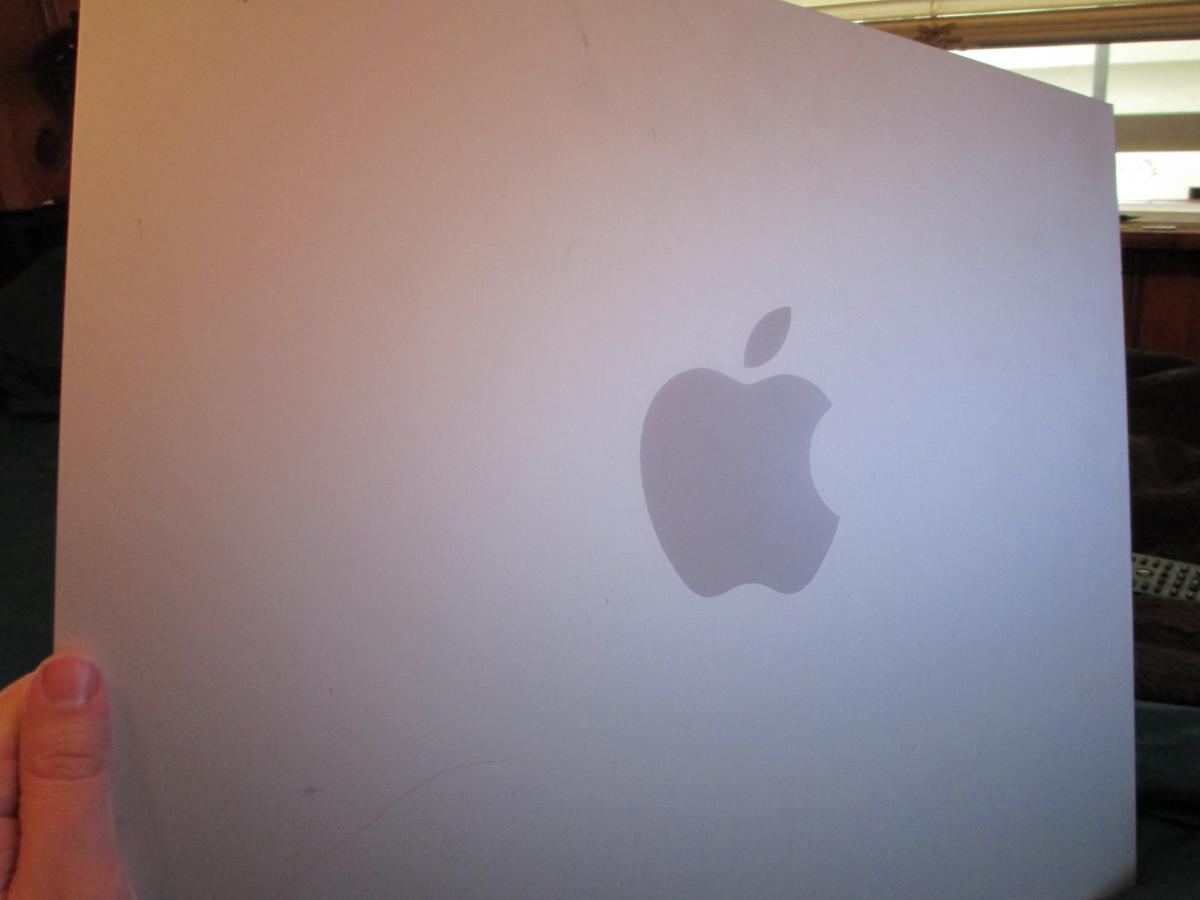

Mr.D. Posted February 18, 2013 Share Posted February 18, 2013 you have done the exact opposite of what I want to do - that is to just cut out the logo, recess it inwards by the thickness of a sheet of lexan, reattach the apple logo to the inside of that lexan, then side light the lexan. My problem is I don't have access to a water or laser cutter, so a one-off cut like that would be very cost prohibitive. Yes, I could dremel it out, but I want to save the apple that I am cutting out. your mod looks sweet. kudos! Link to comment https://www.insanelymac.com/forum/topic/93600-my-nearly-finished-hack-the-tosh/page/5/#findComment-1889982 Share on other sites More sharing options...
Baudouin Posted February 18, 2013 Author Share Posted February 18, 2013 Thank you Mr. D. I still have a G5 door lying around. I can cut the logo out and send it to you. I can cut the apple and flee in one piece, you can adjust it as you like or just the apple logo, just tell me what you need. Link to comment https://www.insanelymac.com/forum/topic/93600-my-nearly-finished-hack-the-tosh/page/5/#findComment-1890114 Share on other sites More sharing options...
Mr.D. Posted February 18, 2013 Share Posted February 18, 2013 ummmmmm... well, what I would like is the G5 door with the apple logo (including the stem) - but two separate cut-outs, with those pieces still intact so I could epoxy them to a piece of lexan mounted on the inside of the door. I have tried and tried to drw what I want in sketchup but I must be THAT old because I cant figure it out. I am not familiar with the term 'flee' so I'm not sure I know what ya mean... hopefully I have described what I am looking for. PM me for more details! ya just got me excited about something that I thought I wouldn't ever get done - THANKS! EDIT: I want to cut the grey out, preserve it, glue it to the inside on a piece of lexan. Give it a 3D effect, especially when I light it. hope that helps more... Link to comment https://www.insanelymac.com/forum/topic/93600-my-nearly-finished-hack-the-tosh/page/5/#findComment-1890159 Share on other sites More sharing options...
Baudouin Posted February 18, 2013 Author Share Posted February 18, 2013 Is this what you want ? But it has to be done with the grey, apple and leaf but in one or two pieces ? Sorry I ment the leaf not the flee. Link to comment https://www.insanelymac.com/forum/topic/93600-my-nearly-finished-hack-the-tosh/page/5/#findComment-1890168 Share on other sites More sharing options...
Mr.D. Posted February 18, 2013 Share Posted February 18, 2013 that is what I am looking for... not such a big cut... just the cut of the grey apple and the leaf/stem/flee.thingy. Its much smaller, and therefore much harder - why I figured I'd never get it done because it would require a laser cutter or a water cutter. Link to comment https://www.insanelymac.com/forum/topic/93600-my-nearly-finished-hack-the-tosh/page/5/#findComment-1890183 Share on other sites More sharing options...
Baudouin Posted February 18, 2013 Author Share Posted February 18, 2013 I put those pix of what I did just to get the idea. I can cut the grey apple and the leaf and send it to you. But in one piece or two separates, apple and leaf ? Link to comment https://www.insanelymac.com/forum/topic/93600-my-nearly-finished-hack-the-tosh/page/5/#findComment-1890202 Share on other sites More sharing options...
Mr.D. Posted February 18, 2013 Share Posted February 18, 2013 well... what I am looking for would be all three.. what I had in mind was to use that door, with the apple and leaf glued to a piece of lexan, put the lexan on the inside of the door, then light the lexan (similar to the glowing blue you have)... so I would want all three pieces: door, apple, and leaf. What are we talking about on cost? shipping the apple and leaf would be cheap.. the whole door - quite a bit more I'd imagine. Link to comment https://www.insanelymac.com/forum/topic/93600-my-nearly-finished-hack-the-tosh/page/5/#findComment-1890203 Share on other sites More sharing options...
Baudouin Posted February 18, 2013 Author Share Posted February 18, 2013 You can cut out the two pieces taking care to keep the door clean and I send you the apple and the leaf cut clean. I will let you kow the shipping price from Belgium to the US. Link to comment https://www.insanelymac.com/forum/topic/93600-my-nearly-finished-hack-the-tosh/page/5/#findComment-1890214 Share on other sites More sharing options...
Mr.D. Posted February 19, 2013 Share Posted February 19, 2013 Good call. Then I don't have to worry about saving my pieces which means I can cut a little rougher and sand/file the edges on the door. Very cool! Thanks for this, I'm totally stoaked to do this now! Link to comment https://www.insanelymac.com/forum/topic/93600-my-nearly-finished-hack-the-tosh/page/5/#findComment-1890237 Share on other sites More sharing options...
Baudouin Posted February 19, 2013 Author Share Posted February 19, 2013 Good call. Then I don't have to worry about saving my pieces which means I can cut a little rougher and sand/file the edges on the door. Very cool! Thanks for this, I'm totally stoaked to do this now! Exactly, and I will cut with 1mm plus around the two pieces so that you can adjust them as you want, if you made a bigger hole somewhere around. Link to comment https://www.insanelymac.com/forum/topic/93600-my-nearly-finished-hack-the-tosh/page/5/#findComment-1890321 Share on other sites More sharing options...
