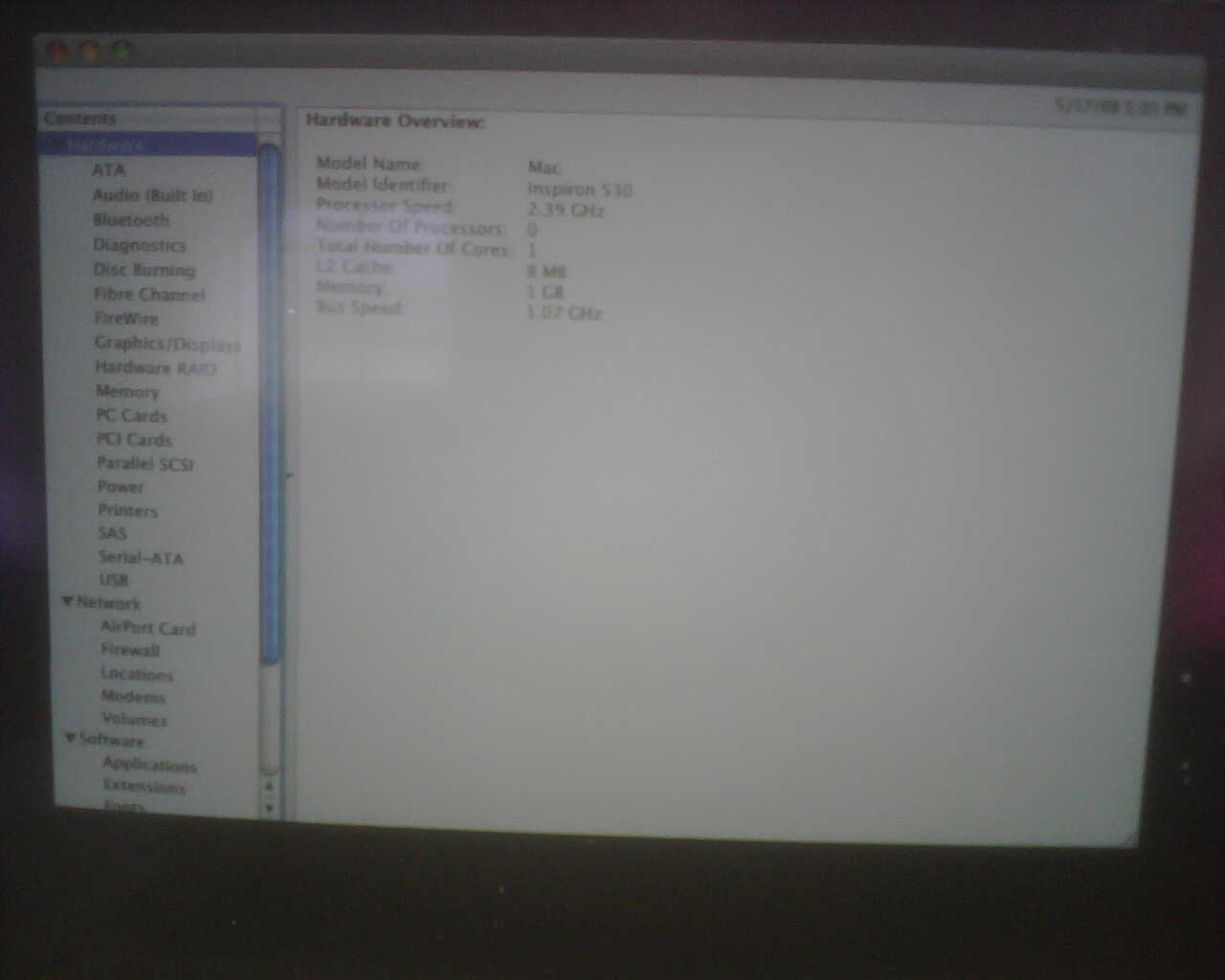

ThaShef Posted March 26, 2008 Author Share Posted March 26, 2008 Nevermind...I tried it again and it worked like a charm. My wireless card started working on the first try. Everything seems normal so far. I need to get a new graphics card to get better resolution and then I'll try the sound out. Thanks Link to comment https://www.insanelymac.com/forum/topic/92131-installing-on-dell-inspiron-530/#findComment-683092 Share on other sites More sharing options...

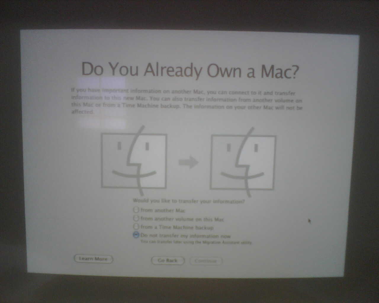

sz2k8 Posted May 17, 2008 Share Posted May 17, 2008 Ok, well I made it all the way through an install usingKalyway_10.5.2_DVD_Intel_Amd.iso(I had also tried iATKOS_2.0i.iso but that kept restarting and would never complete).However, now when I start going through the setup process, the process gets hung up on the screen "Do you already own a mac?"I select "Do not transfer my information now" and then after a minute or so it goes back to the setup keyboard screen (which I had already selected 2 screens before).Anyone have any ideas on this? Ok. Re-read thread (should of done that first) and found an answer When you first boot up, the keyboard verification process will keep on looping. You have to by pass this initial setup/check by rebooting in single user mode (press F8 during booting up and type in -s) CODE /sbin/fsck -fy /sbin/mount -uw / touch /var/db/.AppleSetupDone passwd root This worked for me.Now I'm in. Woo hoo! No internet access yet because the onboard ethernet is not supported. Link to comment https://www.insanelymac.com/forum/topic/92131-installing-on-dell-inspiron-530/#findComment-749973 Share on other sites More sharing options...

sz2k8 Posted May 18, 2008 Share Posted May 18, 2008 I re-read through this post and found the solution to the looping welcome screen that pardus posted above ---------------------------------------- When you first boot up, the keyboard verification process will keep on looping. You have to by pass this initial setup/check by rebooting in single user mode (press F8 during booting up and type in -s) CODE/sbin/fsck -fy /sbin/mount -uw / touch /var/db/.AppleSetupDone passwd root ---------------------------------------- This worked. I now have a mostly working install of Mac OSX 10.5.2. I added an ethernet card to get online and I still need to get my audio working and I have to buy a new video card for the computer. Question: When I go into the system profiler it says that I have 0 processors on 1 core I'm running a C2Q Q6600. Does this mean that all the processors are not being recognized? Or is this information simply not correct? Is there a program comparable to CPU-Z for the Mac that can be used to see what is working? Link to comment https://www.insanelymac.com/forum/topic/92131-installing-on-dell-inspiron-530/#findComment-750623 Share on other sites More sharing options...
