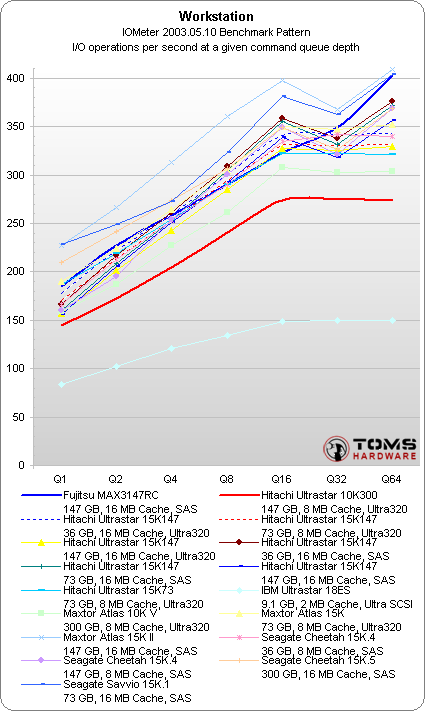

AlexeySob Posted February 24, 2008 Author Share Posted February 24, 2008 Why? You gonna run an enterprise server on leopard? Save yourself some money and buy some Raptors. You won't see any benifits running SAS on a desktop. I'm not a pro here, but these "workstation" tests are showing impressive difference between 7200 and 15000 RPM: 7200 and 10000 15000 @AlexeySobI don't see why not, as long as you plug your drive into the SATA interface. Thanks. Do you mean I can plugin that 15000 RPM SAS drive into usual SATA? Go to to the "apple approved SATA/RAID controller" section (or something like that) on the official site (for an approved card)! I wasn't able to find anything like that on Apple.com. I also used Google to find SAS controllers HCL, but found nothing interesting. Link to comment https://www.insanelymac.com/forum/topic/89339-will-i-be-able-to-install-leopard-on-sas-drive/#findComment-640572 Share on other sites More sharing options...
matcy Posted February 24, 2008 Share Posted February 24, 2008 Why? You gonna run an enterprise server on leopard? Save yourself some money and buy some Raptors. You won't see any benifits running SAS on a desktop. this is simply {censored} differences are enormous. have you ever used a raid of 15k discs? raptors are {censored} if compared to a old U320 10k HDD discs, especially if you own a good controller. I personally used raptors and now I daily use U320 10k/15k discs with a LSI 320-2e controller. I also use a MacPro with 2x250GB 7k2 SATA in RAID0 + other single discs every day ==> I WANT SAS!!!!!! I suggest to control wich chipset uses the apple controller Link to comment https://www.insanelymac.com/forum/topic/89339-will-i-be-able-to-install-leopard-on-sas-drive/#findComment-640791 Share on other sites More sharing options...
vaporATX Posted February 24, 2008 Share Posted February 24, 2008 this is simply {censored}differences are enormous. have you ever used a raid of 15k discs? raptors are {censored} if compared to a old U320 10k HDD discs, especially if you own a good controller. I personally used raptors and now I daily use U320 10k/15k discs with a LSI 320-2e controller. I also use a MacPro with 2x250GB 7k2 SATA in RAID0 + other single discs every day ==> I WANT SAS!!!!!! I suggest to control wich chipset uses the apple controller Yes, I work with 15k drives in servers for customers all the time. I can even get cards and drives cheap. Would I use them in my home desktop machine? No, I don't do anything that would warrant putting up with the heat and noise. Unless you are doing something that needs that kinda performance I just don't think it's worth the expense. I went to a lot of trouble making a dead quiet liquid cooled machine. Of course, this is just my opinion. Do what you want. I just think it's kinda silly unless you REALLY need it. Link to comment https://www.insanelymac.com/forum/topic/89339-will-i-be-able-to-install-leopard-on-sas-drive/#findComment-640960 Share on other sites More sharing options...
